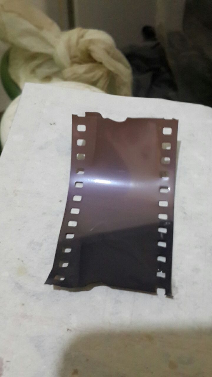

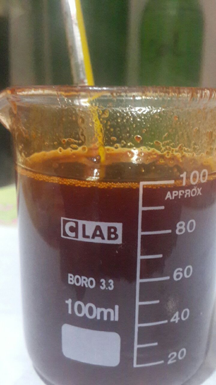

- Phenidion replaced with Metol (10x1)
- Important note ,,
Whoever does not have a microwave, prefers to be distracted from preparing this formula ,, preparing this formula without a microwave is almost impossible.
Mohmad: I'm not sure the substitution of phenidone by Metol will work as you intended for PG110B. It might work but you're charting your own course with this substitution. Patrick Gainer did a lot of experiments on Metol-Ascorbic developers and you should definitely read up his posts on the same to get more insights.
It's interesting that you were able to dissolve Metol in propylene glycol which I thought was impossible to do. But I've never tried it myself. What temperature did you heat the glycol to?
You're absolutely right ,,
The formula consists of only three elements, but it is very difficult.
Dissolving borax was the most difficult stage, and dissolving metol was also difficult.
But I was able to because I read between the lines.
The writer (the photographic researcher) who created the formula, wrote between the lines some words that I had read.
The man said, put the solution in the microwave for 20 seconds, then remove it and stir for a while, but he forgot to say after a while, put the cartridge again, but I did that and every time the elements dissolved better.
Yes, it was a very stressful process, I do not deny it, you need to wear fish gloves, because you will have to hold the glass vessel by its edges and it is very hot and inflamed everywhere .. I did not notice the first time, but I did He brought another 100 ml and paid attention to all those little things.
I can benefit others with the preparation techniques that I have acquired.
