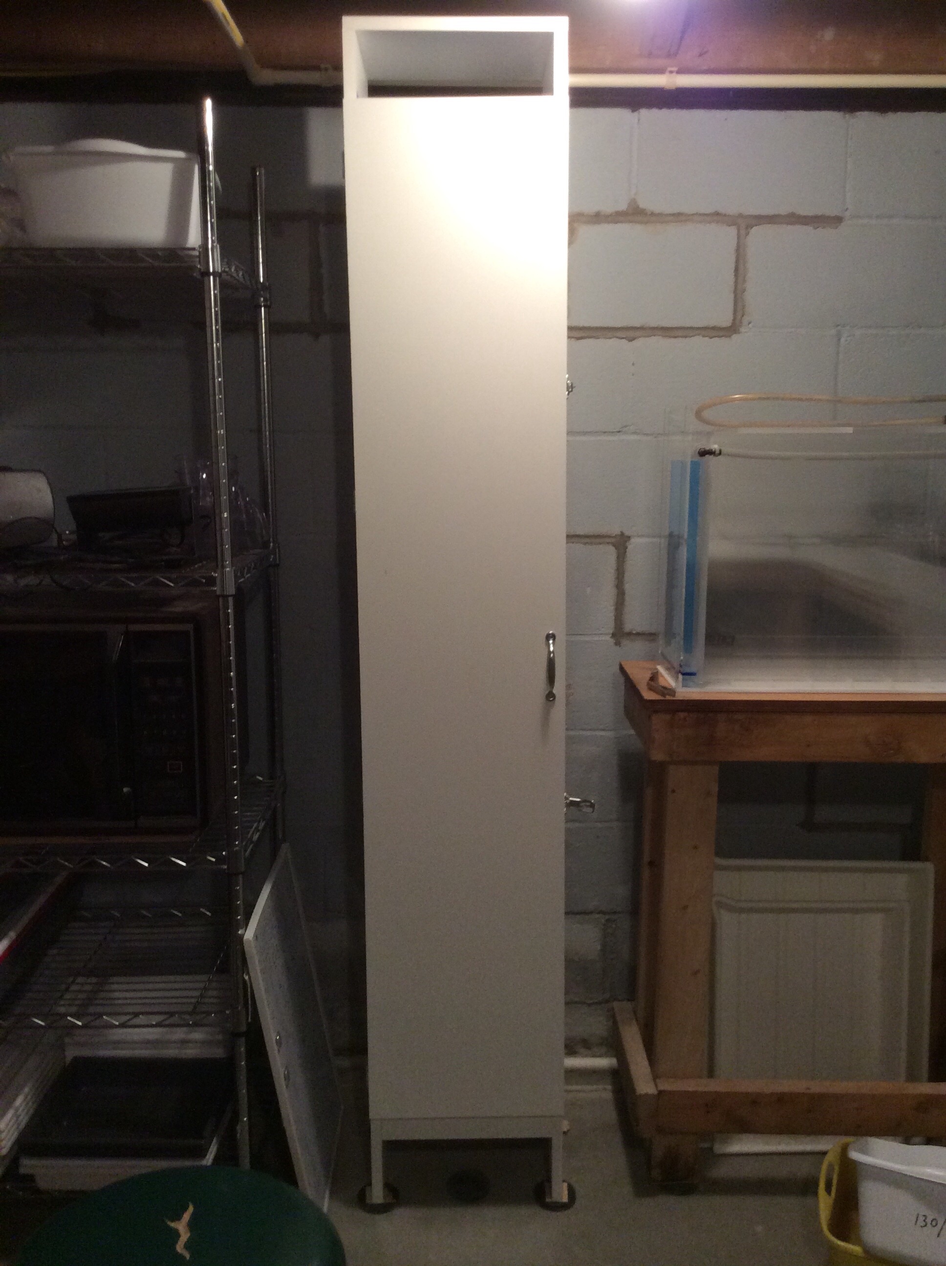

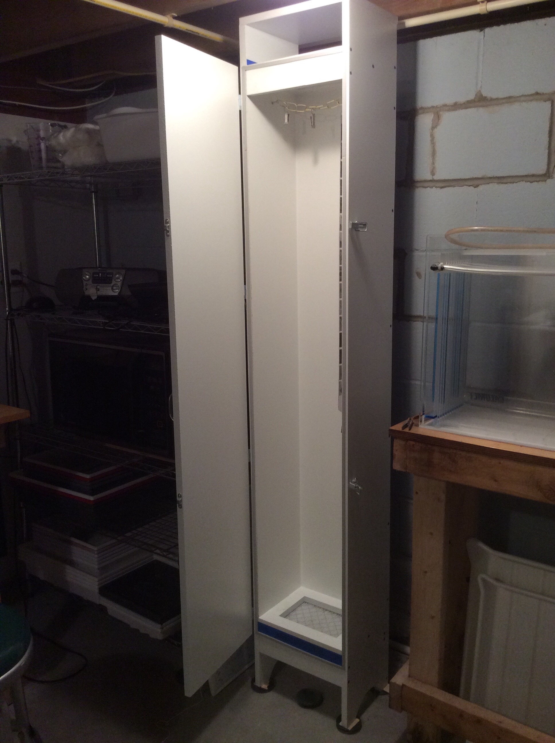

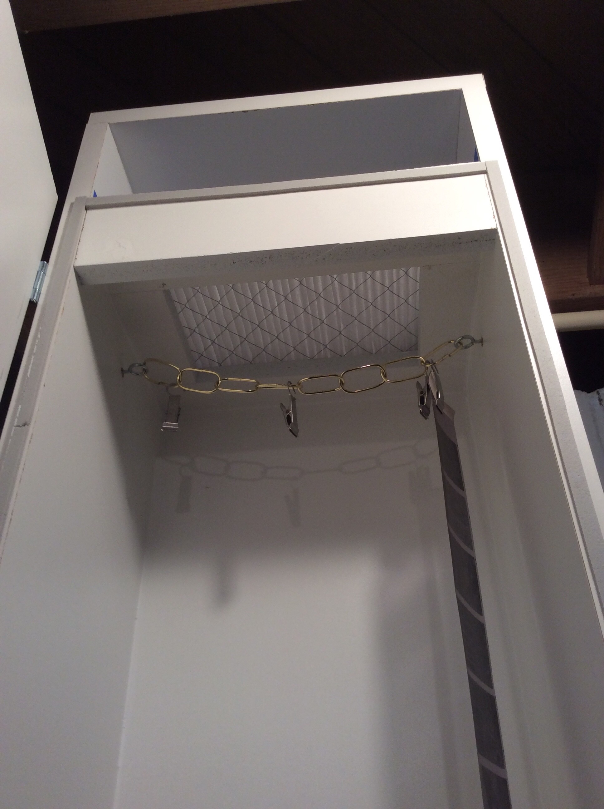

I recently built a film drying cabinet out of melamine and just the other day got the first chance to use it as my new darkroom is now finished. The film dries in a reasonable amount of time however it has a slight buckle or wave down the straight edge of its length. The cabinet is basically a locker with furnace filter material at the bottom and top. This is the only airflow I have. No heat.
My question is do I need more holes like in the sides and back? Will this promote more even drying? (Is this the issue?) or do I need to introduce heat? Like a lightbulb. I've previously air dried my negs from a line and never had a buckling problem.
I've attached some pics of the cabinet. Thanks!
