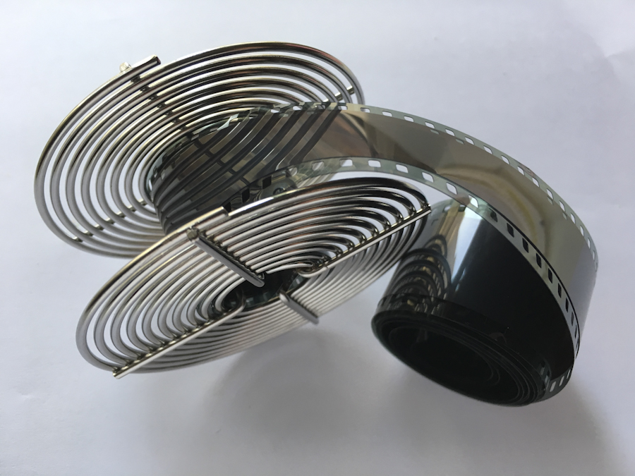

You'll need a changing bag, two small pieces of adhesive tape and a entire 135 roll (already processed and completely blank if possible). You only have to stick the APS film to the 135 film in both ends (at least the leader) there you can go now with the 135 reel. As simple as that!
Good luck!

In the past I have successfully modified Paterson reels for 110 with nothing more than a hacksaw and some silicon glue, there are all kings of FAQ's and Youtube videos on the modification process, just remember that your end objective is a 23mm spacing not 16mm.

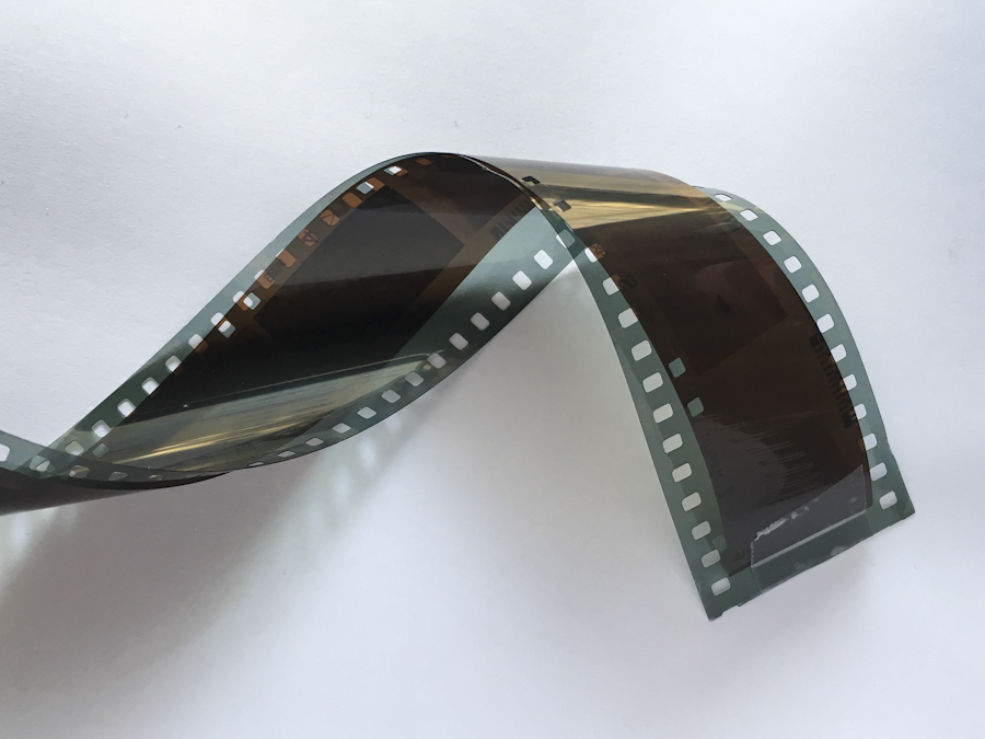

I tried it last night and got a very uneven development. I had high hopes alas the APS film gets squashed against the 35mm film and prevents development. Even if I tape it loosely this happens.
Did you have the wrong side of the film against the 35mm? It should be done with the emulsion of the APS away from the 35mm backing.
You may need to tape it in more places.
The 35mm film apron plus taped in APS might work better. A 120 film apron plus taped in APS might be even better.
Apart from the question Mattking mentioned above, did you use a blank 135 film?, did you pre-wash thoroughly? ... I've never had an issue. I'm sorry to hear that fotoobscura.
