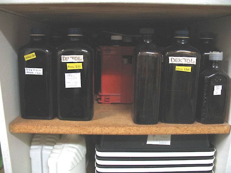

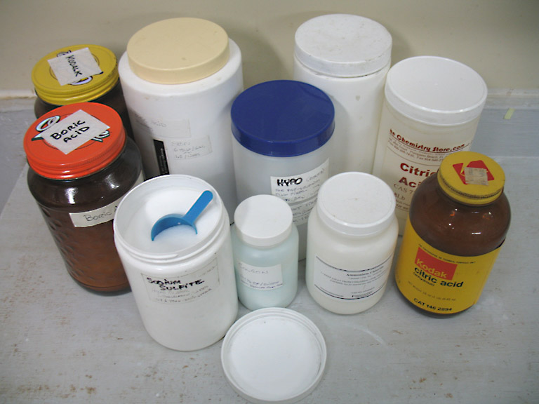

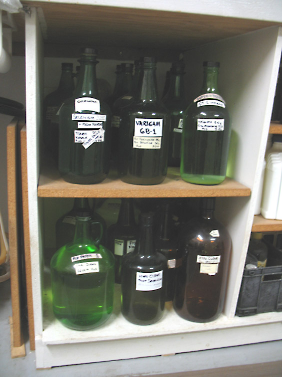

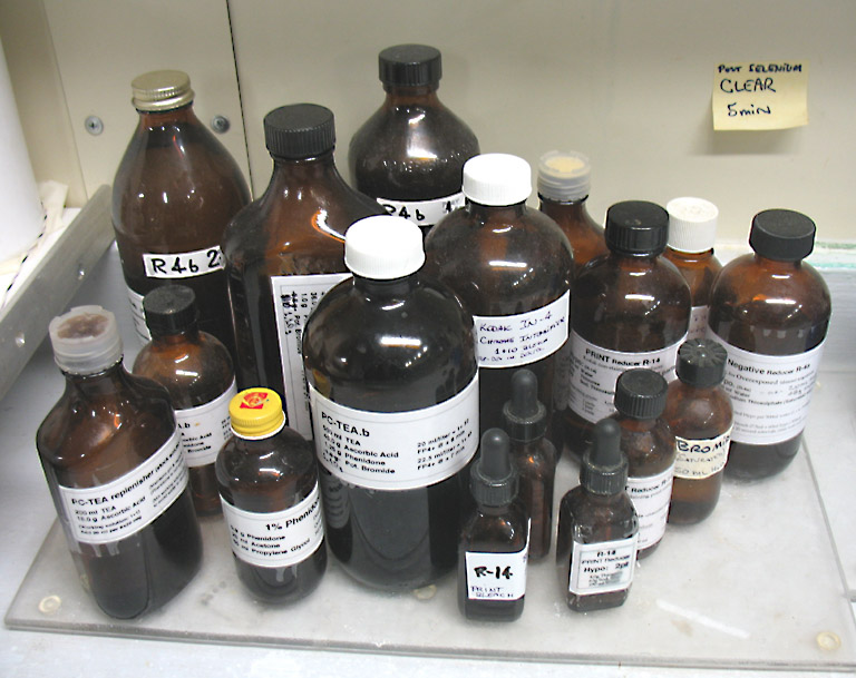

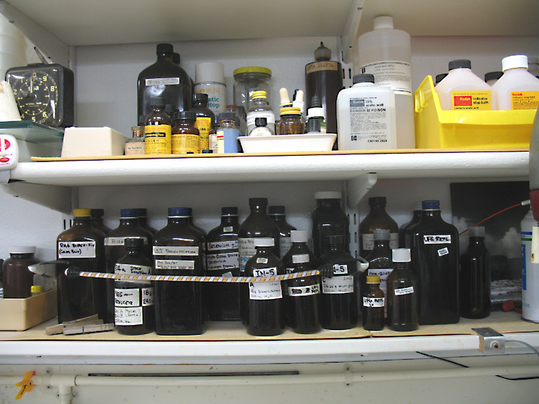

A quick peek at how I use bottles in my darkroom...
90% glass.
Mostly salvaged Gallo wine bottles. Remember that stuff?
It was sold in straight sided 1/2 and 1 gallon bottles, later in 3-liter sizes.
I persuaded my neighbors to collect 'em for me too.
Over 40 years, I never broke one of 'em.
All working solution bottles are kept full to the lid... No airspace.
Stock developers (Dektol, Ansco 130, etc ) are stored in small 8-ounce bottles, full to the lid.
If any bottle is partly full, it has been topped off with an inert gas.
Some solutions are re-bottled into progressively smaller bottles... always full to the lid.
I also use a couple of gallon plastic juice jugs... I like 'em for stop bath.
Dry chemicals are in widemouth glass or plastic.
For spot reducers, I have a few dropper bottles, but not being airtight, they need periodic refilling.
You're looking at a 40+ year of dealing with photo chemistry.
My darkroom(s) are (were) dedicated rooms where no foodstuffs were ever stored.
My wife and I are childless, but when friends bring their children the darkroom is closed and off-limits.
Those folks just getting started can look forward to variety in their darkroom storage as the years progress...
Don't get obsessive-compulsive over it...
Have fun (collecting bottles)
Reinhold
