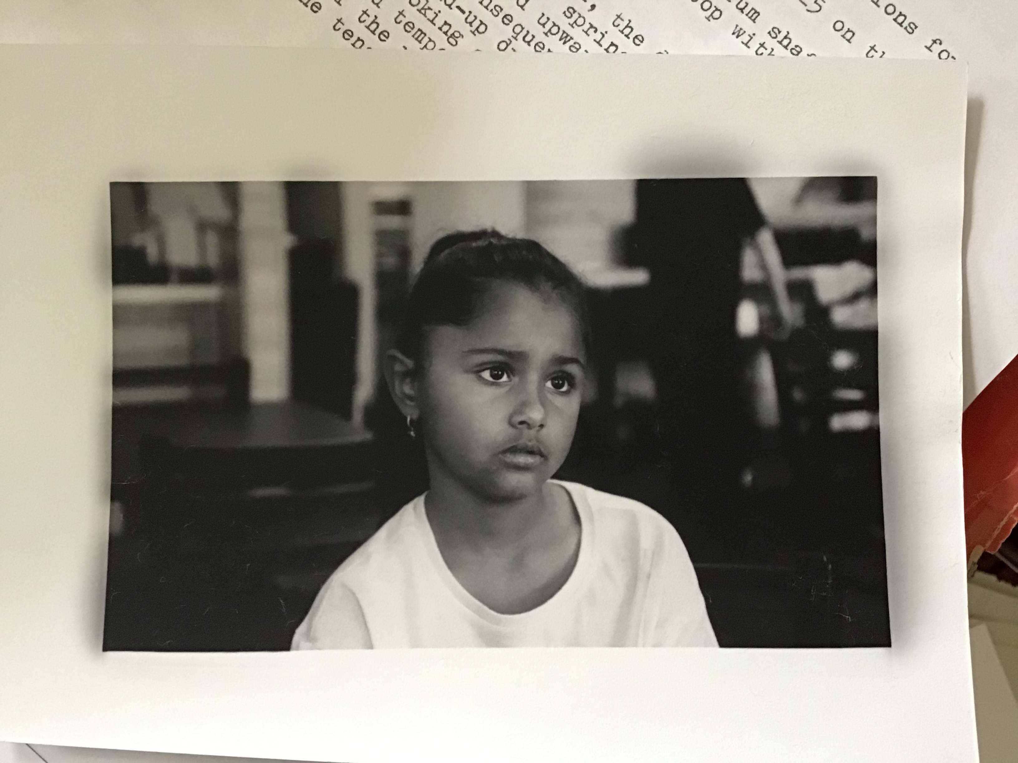

Sort of the look you seek under somewhat similar conditions, I believe there may have been some sort of artificial above light, handheld using 35mm Inexpensive Kodak XX5222 bulk shot with a Sigma zoom lens, interior w larger window opposite, at 1600 developed at 1600 in (replenished) Xtol @70F for 21 minutes, 5-12 shakes every minute or two. Fiber matte, fuzzies from ironing print flat using paper towel. Don’t. There’s much to experiment with this film. And thanks to mbg74 for the cheap Minolta Max 8000i used. Chuckroast also recommended XX but different developer.
