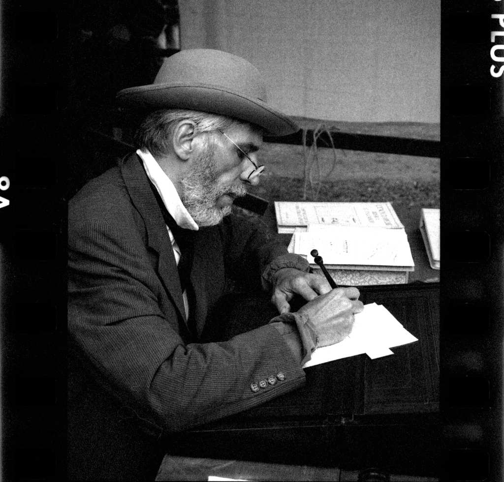

I once shot some HP5 at EI1600 and processed in HC-110 Dil.A
The results come down to about the same as developing in paper developer for twice the development time for FB paper.
Here's what it looks like
