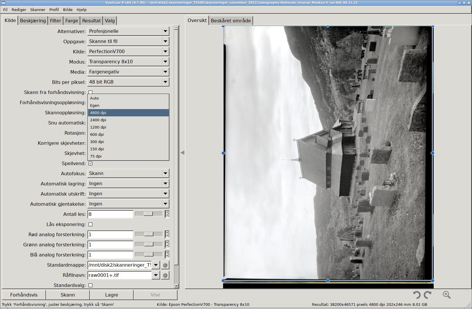

So VueScan 9.7.95, on Manjaro Linux (and you're right, it doesn't use SANE-- although XSane does "mostly" work with the Epson, it crashed because I "only" had 8G free in /tmp, on a 4800 PPI scan) supports 4800 PPI max for "Transparency 8x10", and 6400 PPI max for "Transparency".
Curiously, 4800 PPI isn't an option on the drop down for "Transparency"-- you have to select "Custom" and enter 4800 manually.
Also, irritatingly, you can't have it auto-select a 4x5 inch frame. "Maximum" gives the full scan area, and "Auto" maxes out to what appears to be 6x9 cm.
Vuescan 64 for Linux, as of the last time I used it, did not offer resolution above 4800. Have you tried this software in Linux?
Just checked, and Vuescan can indeed do 6400 PPI if "Transparency" mode is selected. If "Transparency 8x10" is selected, then you only get 4800 PPI as your max resolution.
I run Linux since ever with Vuescan for scanning. I have the V700. (two in fact, one for spare...)

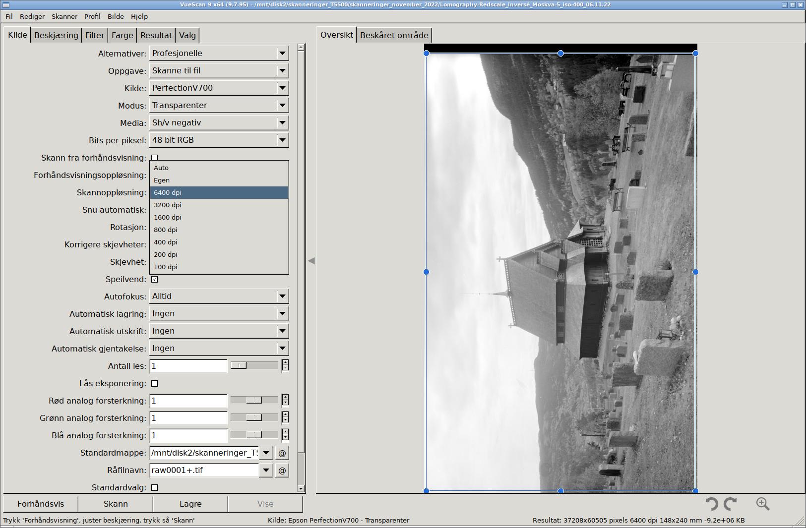

Vuescan offers indeed 6400 dpi when "Transparency" mode is chosen (at least in "Professional" UI, I never user "Basic" and "Standard") but the scanning area doesn't cover 8x10, it's narrower. 8x10 coverage is possible only as "Tranparency 8x10".
example with a 8x10 sheet:
"Transparency":
"Tranparency 8x10":

for reasons too long to explain and that may be wrong, I scan BW as "BW negative" but with bits per pixel set as "48 bit GB", and save a "16 bit grey", as RAW in TIF format/container.
The 8x19 sheet seen in these screenshots of Vuescan gives the following sizes:
2400 dpi : 808 mb
4800 dpi: 3,2 gb

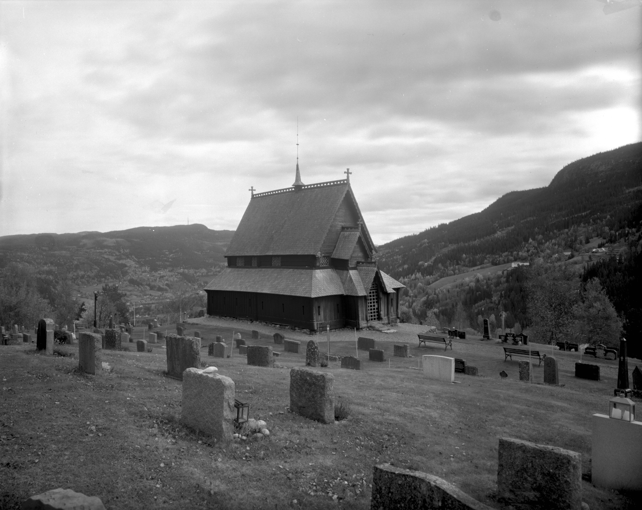

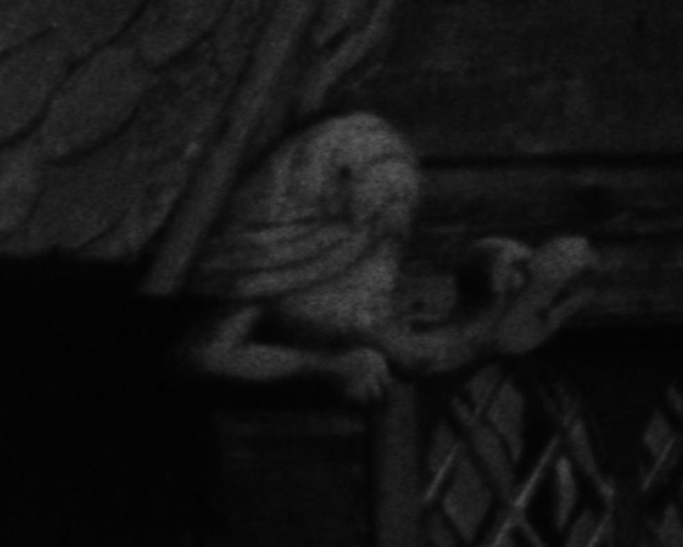

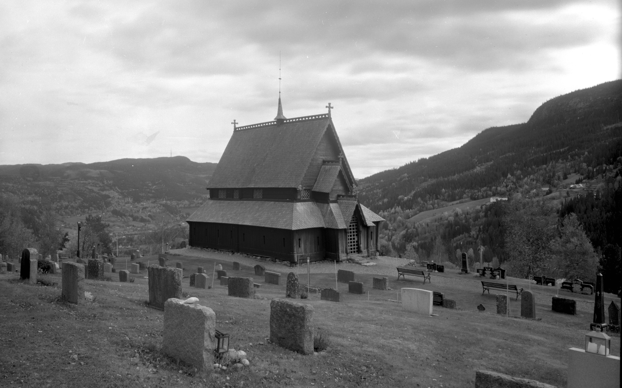

a 1280px width 100% quality JPG of the 2400 scan after inversion of the negative in ColorPerfect grade 2 virtual printing:

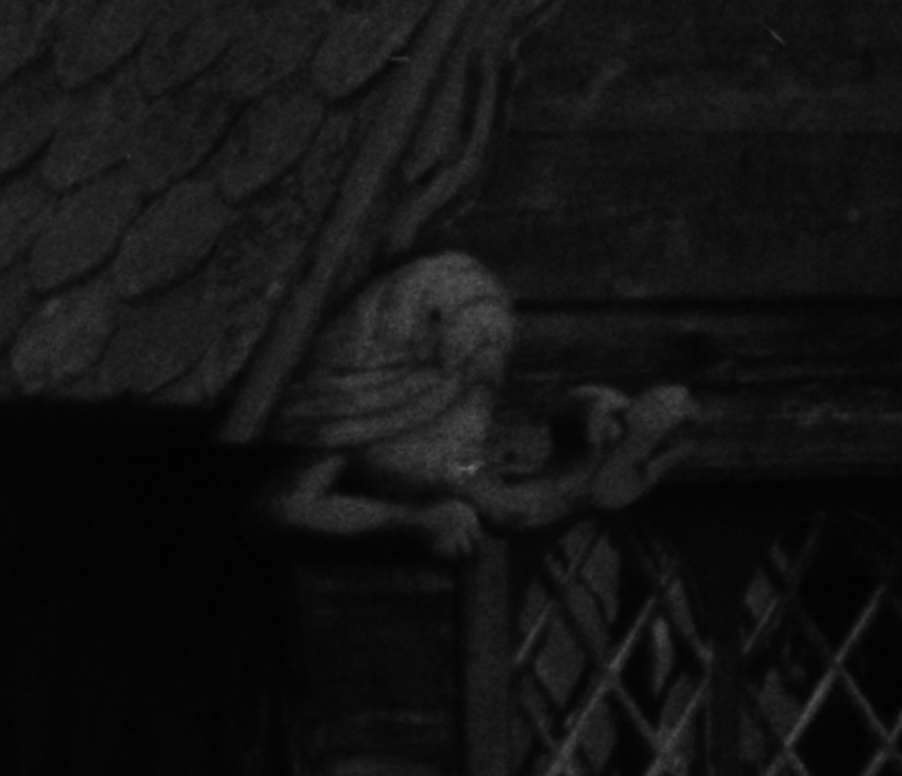

a 100% zoomed crop of the first beast in the center, this here is not a JPG but a lossless PNG chunk of the original RAW:

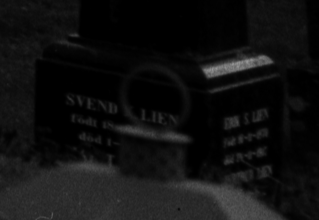

by the right egde on the whole image there's a black thombstone, 100%, same, lossless PNG :
now, from the 3,2 gb 4800 dpi scan. crops of the same, at 67% instead of 100% just for practical purpose of not providing too big image here:
on the thombstone of Svend Lien there's not so much difference in the resolution of " födt" and "död" ....

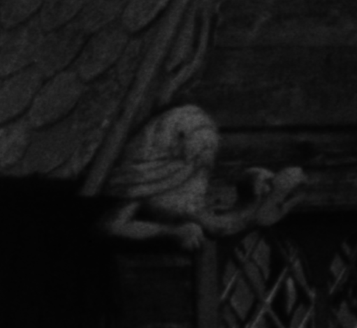

now, if I am happy with the narrower scan that can be made as "Transparency" at 6400dpi, which is possible in this case, because I can keep the church and leave part of the sky and of the foreground. Image ratio is of course elongated then.
a web rendering at 1280px reduction in 100% JPG:
a 100% crop of the beast, same, on the original RAW, saved as PNG. heavy file for web ~ 1mb, so you need a good internet speed:
and Svend Lien:

important about the "Transparency" and "Transparency 8x10": Epson manuel mentions that 8x10 is do be done on the glass bed of the scanner. Epson 8x10 holder is a positioning mask but film lays on the bed. As per the manual (page 40) :

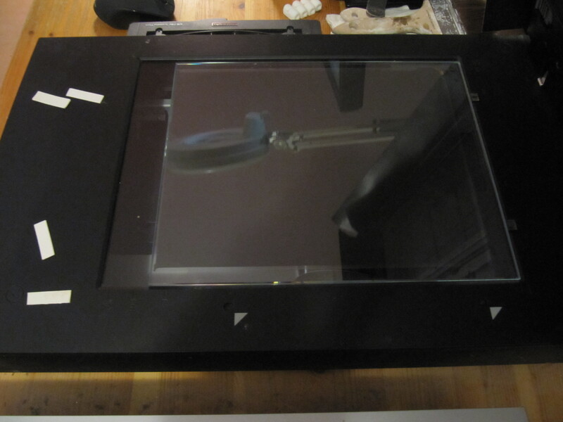

I have 2 settings for 8x10 and 5x7 (18x24, 13x18....) best summarized in pictures:

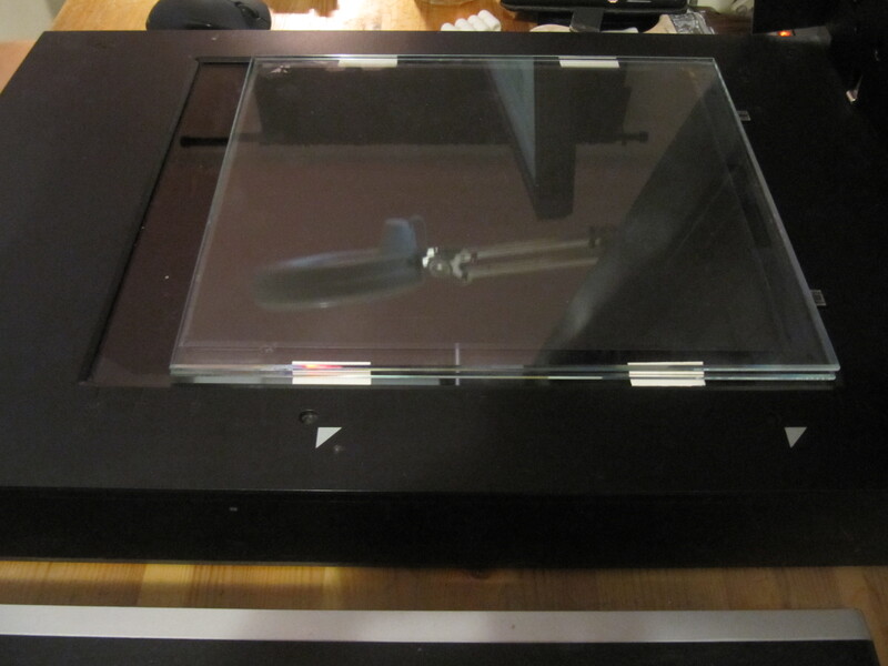

sheet on the flatbed, hold with a plate of glass, and this for "Transparency 8x10":
sheet sandwiched between 2 plates of glass, the lower one high adjusted with some paper padding (after countless test and try the focus). This for "Transparency" mode. For 4x5 or 120 I sometimes do this instead of using the Epson holders:

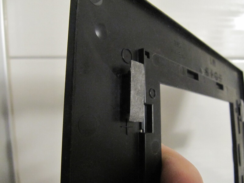

in fact I did tune my 4x5 Epson holder for optimal focus. See a piece of thick black paper (from automotive gaskets material) under the native high adjuster:

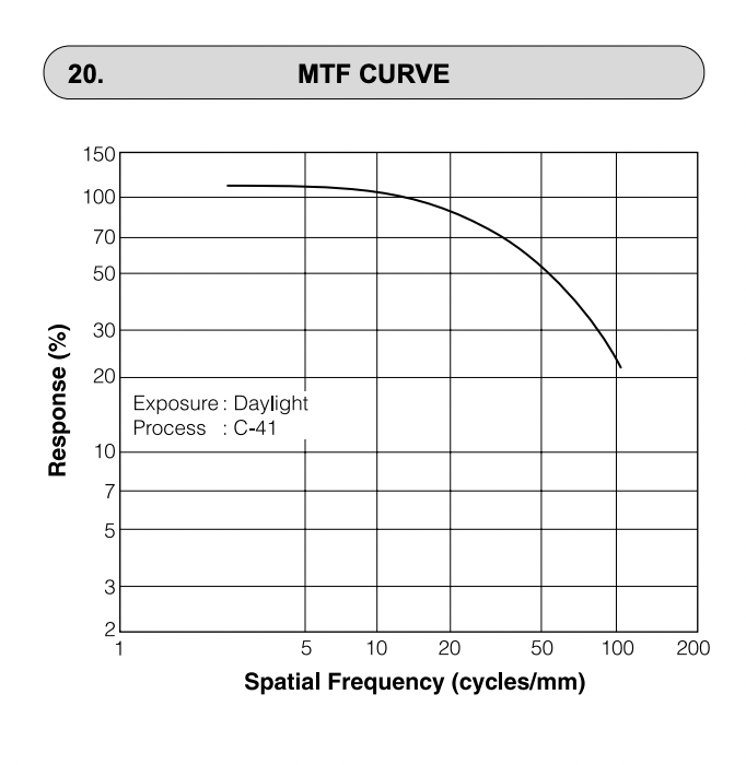

This is the MTF of Fuji 400H, the scale at the bottom is logarithmic and they don't include as many divisions as the Kodak data sheets, but it looks like it falls below the 30% contrast mark at about 60-70lp/mm. I recommend reading the article I linked, it has a lot of information including a formula for deriving the resolution you can achieve in a camera system given the MTF chart of a given emulsion.
