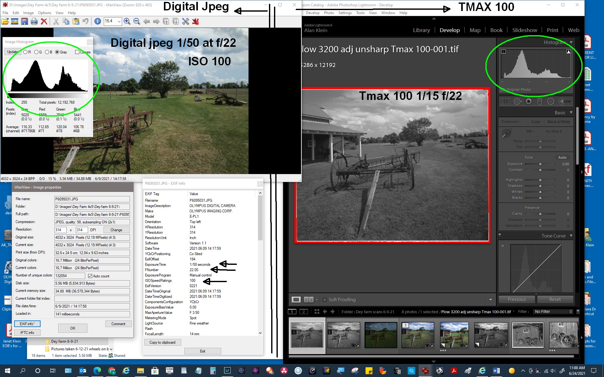

I used my digital camera to get an exposure setting (1/50 at f22) and shot Tmax 100 with a polarizer adjusted for stop loss to 1/15 at f22. Digital on the left and Tmax on the right. The clipping outline in red is just the white border that was scanned so ignore that as it would be cropped out during editing. Film was scanned adjusted so white and black points were at the limits of the image. You can see that histogram on the right. Then digital histogram is on the left.

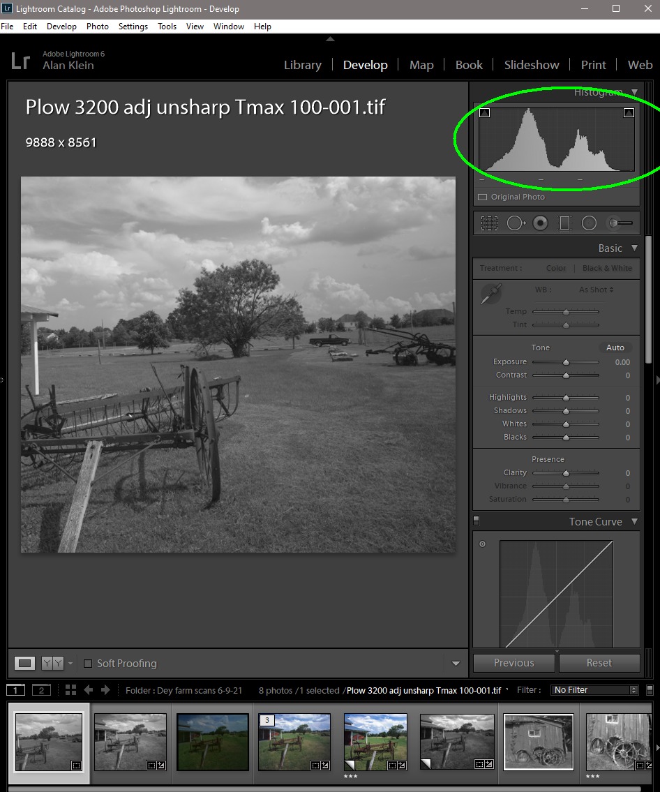

Here's a cropped file of the film image on the right above so it matches the digital image. Notice how the histogram matches very closely to the digital on the above left.
