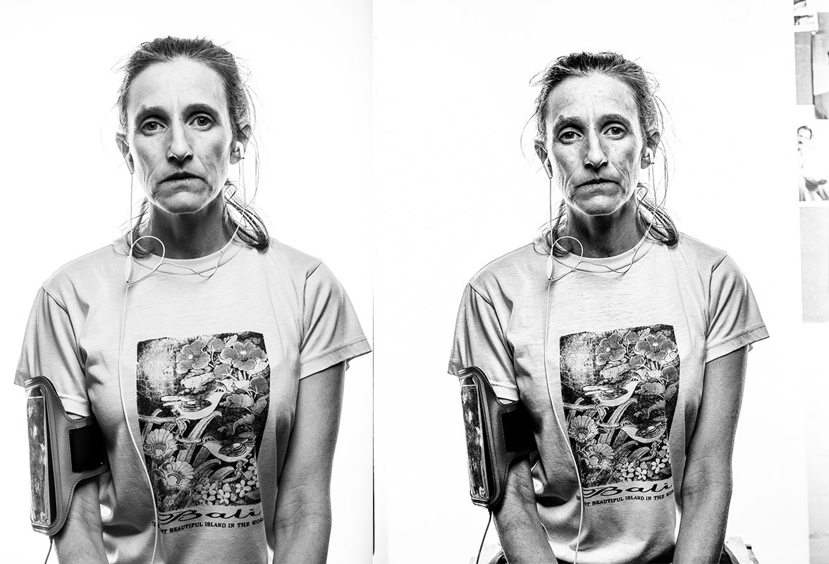

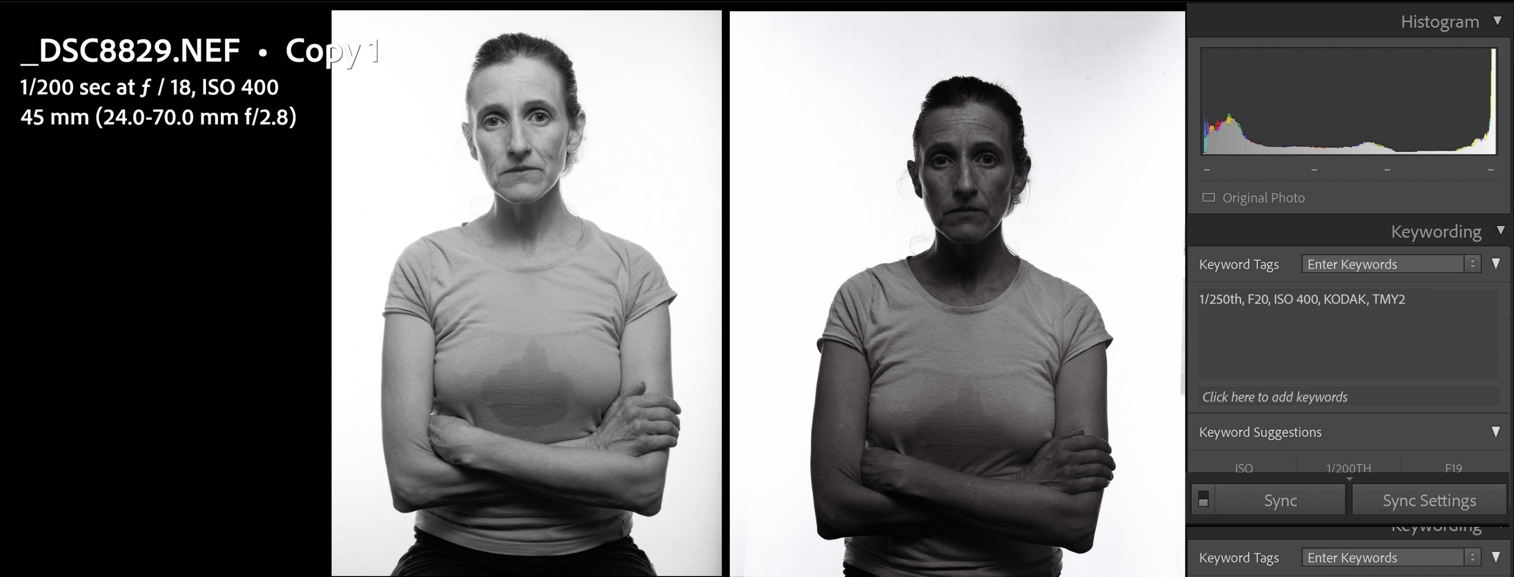

I did some test shots of a high contrast scene (I wanted the background blown out) on my Nikon D610 and once happy, converted the settings to equivalents on my Mayima RB67. To my surprise the shadow areas in two of the photos are way darker on film than on digital (the two photos of the white woman. Strangely the portrait of the black woman came out quite similar). Is this normal with film (I shot with TMY2 ISO400)?
The attached images will show the digital image (with exposure info) on the left, unprocessed but converted to mono in order to simplify comparison), and the right hand side is an unprocessed scan of the same same shots from film, with the keyword block showing the settings I used (as best as I/my notes can recall). You will see though that there appears to be no clipping in the shadow areas (sorry, the same histogram appears to have been posted in both of the first images, but nonetheless neither of them are clipped).
Disclaimer: I am new to using an MF camera, so I am not sure if I made mistakes in my my conversions from digital test shots to film (the discipline of note-taking is new to me as a digital user).

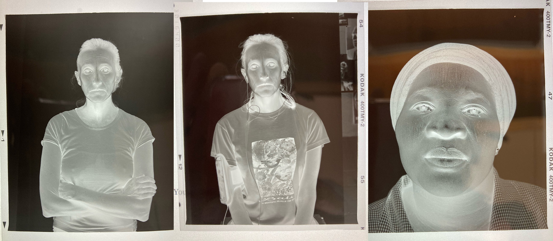

You have the negatives, right? What shadow detail is in them? There should be a banner "show us the negatives" that pops up every time someone is about to post a new thread :D
I have no idea as it was commercially processed and scanned, but it's a damned good question ... I will ask them.
Ha ha, ok yeah, I do have them.
Unfortunately I have no skill at reading their quality, nor do I have any idea of how to show them to you if I am not going to scan them, so I have simply shot them with my iPhone on a temporary iPad lightbox... hope that will suffice?

I think what you are seeing is the result of a number of factors, not the least of which is that your meter reading is being overwhelmed by the backlighting.
The light that is actually hitting the front of your subject is barely enough to under-expose it. The digital tools can be used to eek out a usable image from the negative, but it is a stretch!
This is an example of a situation where an in-camera meter is barely suitable for what you need to do.
I expect you metered from the camera position. It would have been better if you had got closer and took a reading off of a small portion of your subject.
Notice how the exposure is better in the example where you are closer and your subject fills more of the frame. It was probably also helped by the fact that her skin tone is much darker - that will tend to cause the meter to suggest more exposure.
It isn't a result (so much) of your using a digital camera for metering. It is a result of using an in camera meter when an incident meter would be much better.

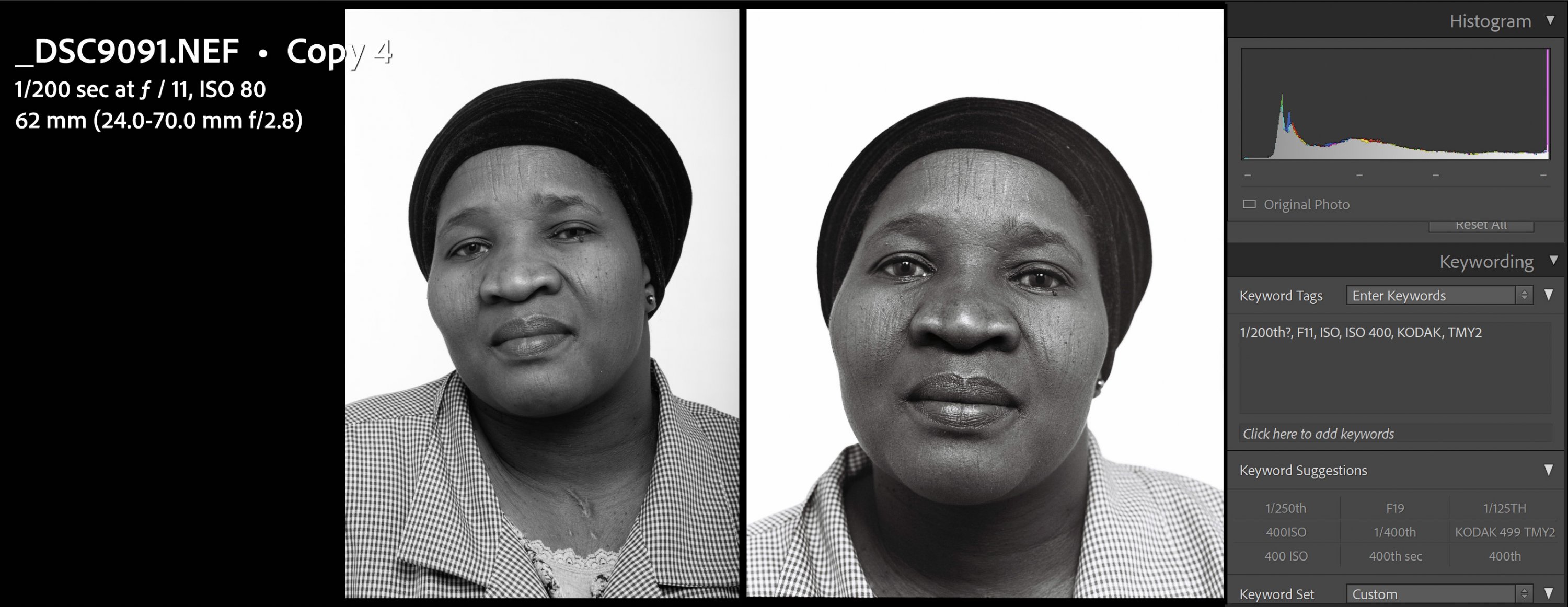

Thanks for your reply, Matt, but at the risk of sounding defensive, if you look at the digital version of this image on my first post, you will see it is not massively under-exposed (it appears more so due to the white background; see below for the processed images: digital on LHS, film on RHS), so my question was not whether it was under-exposed, but rather about why did an equivalent exposure triangle on film result in it being so unexposed when one would expect it to be the same or similar.

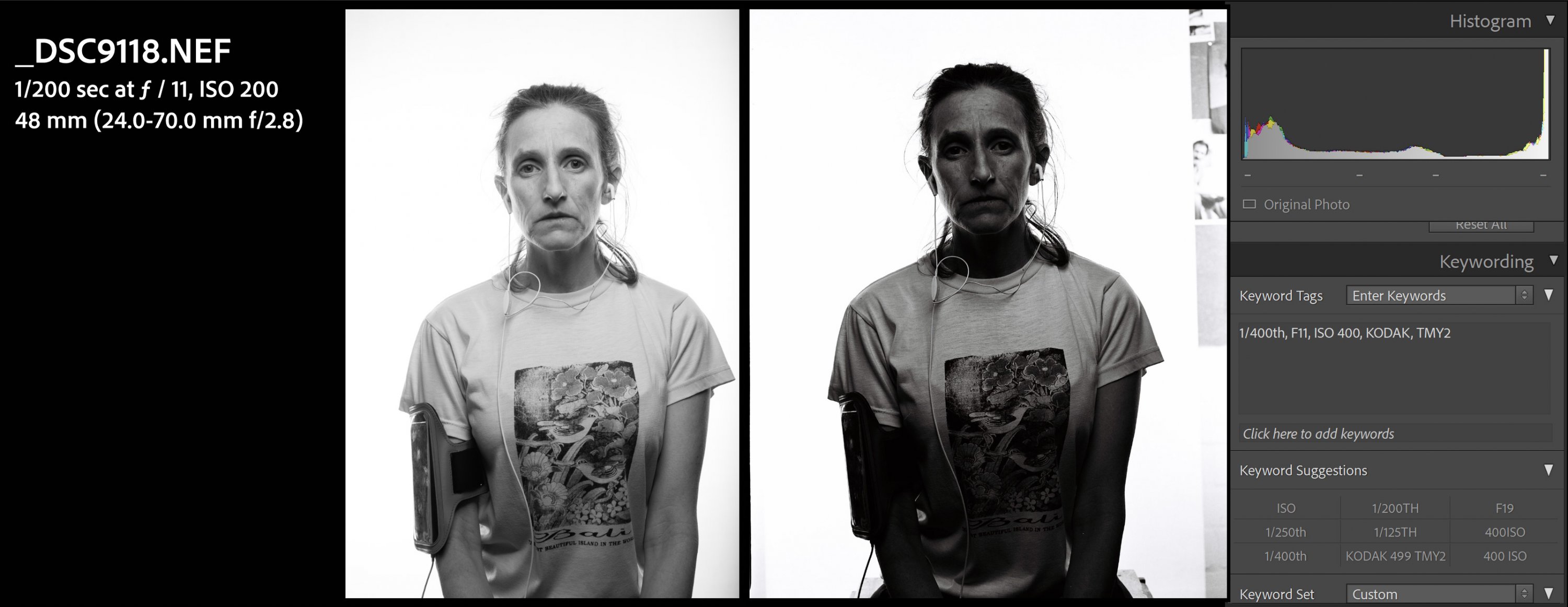

According to your notes, the digital shot of the black woman was with a lower ISO, so it had less exposure than the film shot (assuming the shutter speed is correct, but you put a question mark by it). That might explain why those shots match better.
The RB67 has a bellows focus. The closer the subject, the more the bellows extends, the darker the exposure will be. This needs to be compensated for compared to your digital exposure.
As Frank noted, digital will be better at preserving underexposed shadows but will clip highlights. Film is the opposite and will clip underexposed shadows while preserving overexposed highlights better.
In the negative images, the density of the skin tones looks about the same in all three meaning the white woman will have about the same tone as the black woman. There should be more density in the white woman's skin.

FWIW, based on what I see I could make decent prints from the second and third negatives you display above, and could probably make a decent scan of them as well, but I still would prefer the results if you had used some more front lighting :smile:.
And by the way, those are really well displayed negatives - much better than a lot of attempts to display negatives we see here.
