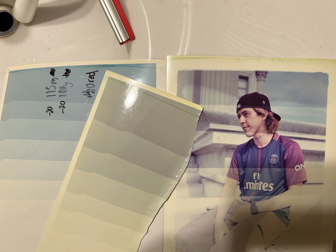

I never had staining until i changed to this new developer replenisher by champion. Formerly i was using belini kit, adox or the arista kit. When i started using the champion stuff and the filtration totally changed entirely unlike before and i started to get this consistent staining yellow and cyan around the edges or sometimes staining the whole sheet yellowish. I never had to use a stop bath but when i did its a bit better but still stains. The blix i use is still Bellini. Any help with this issue? Thank you!

Another thing is you can try using a bit more, like 100mL of each solution.
You need to prewet in a drum too.
I started printing with a drum (stainless steel) that floated in 100°F water bath, 5 solutions, 7 minutes. c. 1973. 😊

Cyan staining is virtually always a problem with blix contamination in the developer. It takes only a little to destroy the developer. Try mixing some fresh developer that has not been in contact with any bottles etc. that you used for the developer up to this point.
With drums, you really should be using a stop bath. Also, a likely source of contamination of the developer is blix that lingers in the light trap of the drum. You need to rinse the drums really, really well before the next development run.
So strange because I did a test with everything washed and newly mixed but still same issue, it should of not been possible to get contamination. When I try a stop bath again

You're right that freshly mixed and no potential for getting any blix in there should have avoided this problem. See if the stop bath makes a difference. Champion chemistry is marketed primarily for commercial labs; if their chemistry would suffer from serious flaws like this, I'm sure they would be in massive trouble. Not that I can explain this even if the developer is heavily expired, but was it old stock, by any chance?
