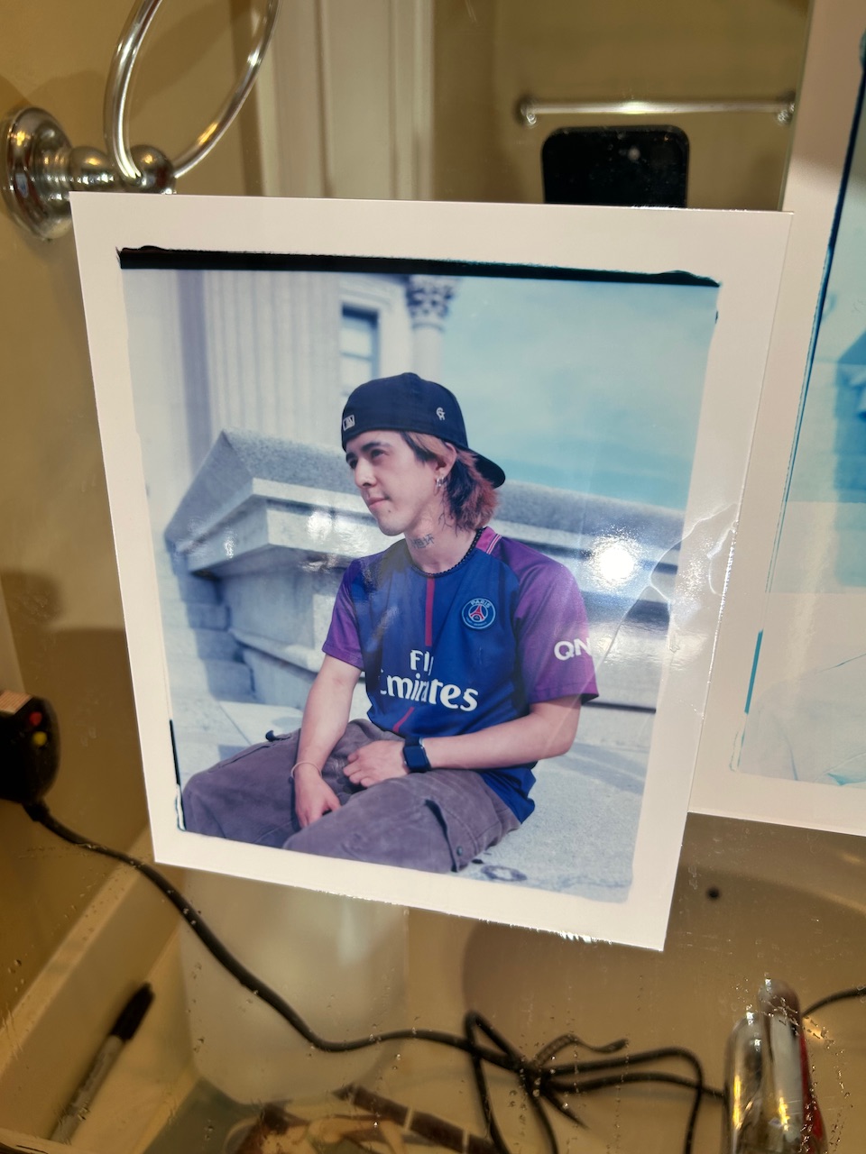

GUYS IT WORKED THANK YOU SO MUCHHHH LOVE YOU ALL
Victory!
do I dilute the replenisher like it says on the bottle THEN add 50ml or just 50ml just from the bottle?
Not sure which bottle you mean now. You mix the replenisher concentrate with the required amount of water and add starter to that. In any case, as your print shows, whatever you did, it has worked for you!

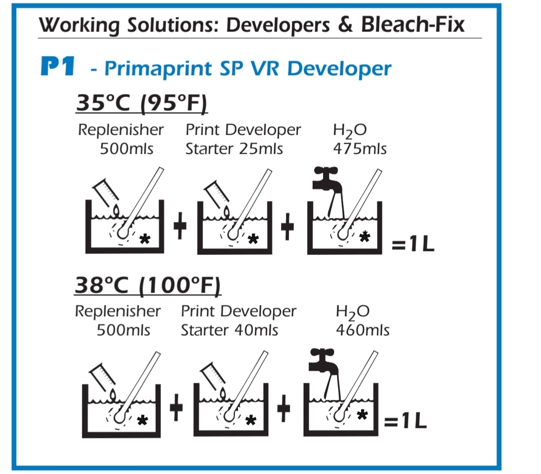

When I stated "50ml + 25ml starter + 925ml water" I was under wrong assumption that you have a 1L bottle of concentrate that makes 10L of replenisher that is then used in "500ml replenisher + 25ml of starter + 475ml" to make 1L of working solution (mixing instructions for Champion product code 140162).

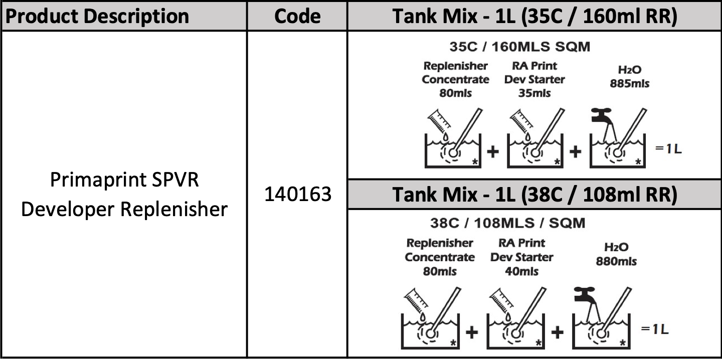

Now I've looked at your links more carefully and I think that you have 0.82L bottles of replenisher concentrate (product code 140163) so you should follow this instructions:
So:
80ml of concentrate (from the bottle that you bought)
+ 35ml of starter (hoping that Ektacolor starter is close to what Champion provides for a starter)
+ whatever amount of water to make 1L*
and then try to aim for 35ºC as developing temperature. As you can see Champion suggests that you make you working solution a bit less potent (40ml of starter) and use different replenishment rate (which is of no importance to you since you'll be using the working solution one-shot) if you intend to develop at 38ºC.
* of course, I would start with like 800ml of water then add replenisher concentrate then starter and then add water to reach 1L
