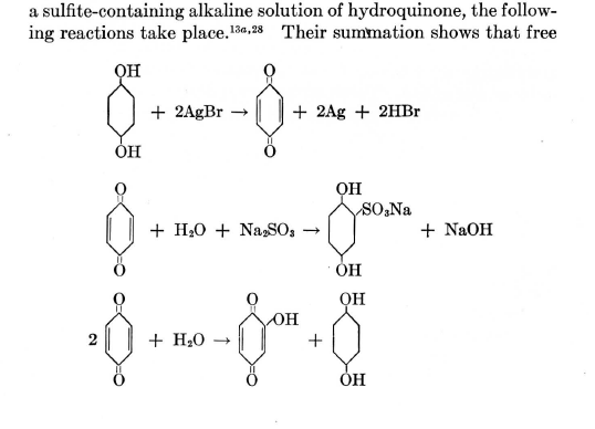

In "Theory of the photographic process" (Mees) there's a table showing how many moles of AgBr can be reduced by some developing agents.
"In a solution not containing sulfite, one mol of p-aminophenol reduced only 1.2 mols of silver bromide."
But, in a sulphite added developer, one mole of p-aminophenol reduced 3.9, while HQ did 4.4. How can this be? Who is restoring their oxidation state? It seems I can't find the explanation for this along the chapter.
But, in another place (attached) there's a diagram, from which I understand that HQ can be restored (from quinone back to HQ), so it is able to further reduce more halides.
Is it so? Does it apply to p-aminophenol, metol, ascorbate,... too?

I cannot give a reference for p-aminphenol but methyl aminophenol (Metol) is one of those developing agents whose oxide strongly inhibits development but is removed by sulfite.
Look in the index of Mees for "Metol effects of added sulfite" Refers only to the first part of your question.

This is a complex problem in Organic Chemistry. Many of us at EK have puzzled over these problems for years and yet we have those advanced degrees. I suggest that you just study the references for now and try to understand and then get back to us.
I know, this is a non-answer, but it is the best I can give you. Many here try to work out problems without understanding the basic science behind the problem. Sorry, I can't do better. It is even hard for me.
