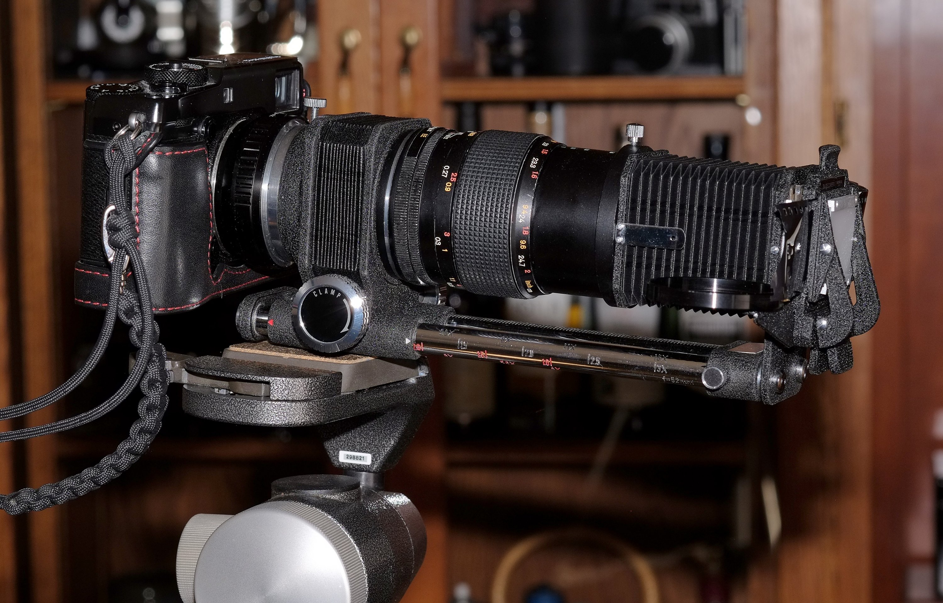

I recently dug out my old bellows and slide copier gear (Konica-based) to copy the manual for someone. It got me thinking that I might try shooting negatives through it as I've seen others succeed as an alternative to their scanners. I was enthused to be able to capture the grain quite sharply in some initial attempts. My trouble is that I can't seem to orient my gear to capture the framing as I'd wish (just able to get small part of the frame). I've not done any real macro work with this rig, even after owning it for 20 years (shelf queen). I'm attaching a photo, attached to a Fuji rig and my 55 macro Hexanon. Nothing I've tried seems to be able to capture the whole 35mm frame. I must be doing something obviously wrong but I'm ready to place it back in its box on the shelf at this point. Any insights out there from experience?

The OP's setup is a little different, as he has a bellows and a separate macro lens, which in principle allows more flexibility, But, OP, your current setup has too much extension - the lens looks like it is focused to give about 1:1, and I assume your Fuji has an APS-C sensor. You need a magnification ratio of about 1:1.5 (imaging a 24x36mm slide onto a 16x24mm sensor). I think the lens needs to come closer to the camera. It doesn't look like the bellows will compress much further, though. An extension tube would usually let you focus the macro lens to the 1:1.5 ratio, but then you need to figure out how to get the slide holder part mounted to the lens without the bellows being in the way.

That all makes sense. I've also got the Macro Lens Adapter for the 55 (non optical extender).... While I'm messing with this, I'll see if I can jimmy-rig something that works. I wouldn't pursue it but I'm a bit lukewarm about my results with my Canon 9950F's film scanning abilities and I was surprised at the clarity I was getting on the portion of the negative I could capture with this. It seems worth pursuing, anyway. Thanks for clarifications!

As other have said, that rig was designed for full-frame copying of 35mm film slides and the magnification is wrong for copying to APS-C size sensors.

Another option would be to remove the slide copying part (everything in front of the lens). If you simply lay your film on a light box, then you can position the camera+bellow+lens over the film at the right height to fill your sensor. Typical set-up shown <here> The rig shown in my photo is a 100mm lens set up to copy a 120 negative. Using your 55mm lens to copy a 35mm negative will result in your lens being much closer to your film that what is shown in my photo.

if your camera is APS-C you don’t need full 1:1 to copy full frame. If you can’t capture the full frame, then you either aren’t getting the frame to be copied far enough away, or if you’re at the max extension of the front part, you need a shorter focal length lens.
I have an APS-C dslr with 70mm macro lens as my current setup and to copy full frame, there needs to be about 12 inches (ballpark) between the sensor in the camera and frame to be copied with the lens attached directly to the camera body. With a 55mm lens, you’d need even less distance.
You probably have too much bellows between the lens and camera and not enough bellows between the lens and the frame to be copied.
Just finished a bunch of 1:1 35mm slides to full APSC using 50mm Pentax macro and shortest extension tube...maybe 10 mm. Was about 6" between lens and slide resting on light box . Tiny focus tweaks between slides...maybe not important @ f8.
