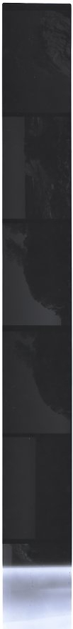

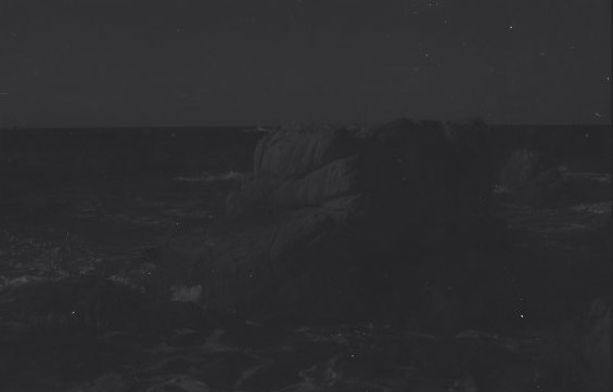

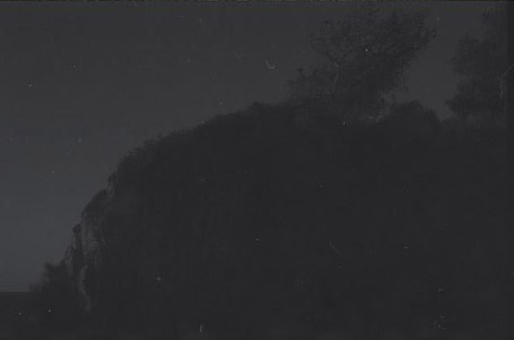

Hi all! So, I tried an AZOCOPY DN - 3 negative copy film, very expired:smile: I rated at iso 25 as I don't find info about its real iso. Also exposed it with plus 2 exposure compensation and developed in HC 110 dilution F for 10 min (my approximation as I did not find info about) with 2 inversions at every minute. As there are many variables I wonder if the outcome is from over exposure or from underdevelopment, what do you think?
Thank you!
I'd first exclude the possibility of severe underexposure with material that's (1) old and (2) not intended to act as a recording medium.
It might help to see a photo of the actual film negative instead of an inverted scan.
