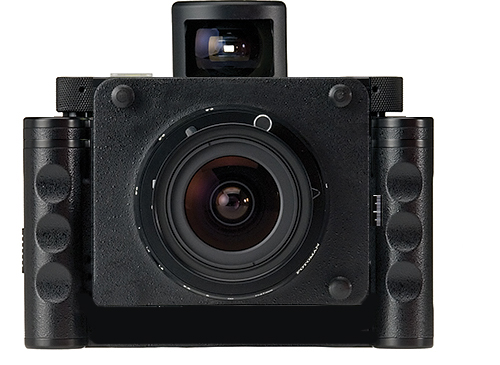

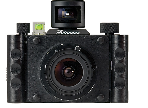

The camera should be simple, like 6x12 already built, with integral front rise of about 20 mm.
