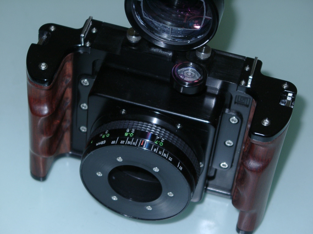

6 x 9 design
Here is a new design presented recently for 6 x 9, helical cones
Is it my imagination, or did I see this on EBAY not very long ago? Seems very much like something I saw. Also, this is a little like an ALPA, though with very slight construction differences.
That was the Gaoersi 6x9 you saw -- that model is not selling as well as their other cameras (who knows why? Perhaps because they only support two lenses?). What is interesting is that the proposed Fotoman would compete directly with the Gaoersi 6x9. They even look nearly identical (and perhaps they are). The big difference is that Fotoman has a real honest-to-God distribution network (and thus higher costs), whereas Gaoersi depends upon eBay/PayPal as their storefront.
The problem I find with the ALPA is the lack of an accessory shoe mount to place a rangefinder near the viewfinder. Something like the small accessory rangefinders of the 1950s and 1960s era would work, but only if there is a way to mount it. I use a Präzisa on three of my old folder cameras currently.

Yes I think you did see it....the design was sent to me about 8 months ago and that is where i received the photographs...the photo sent to me was from Focus Da yi group...it is interesting the interest in China in fine art photography, note the recent sale of very expensive lenses...winning bids are from Chineese photographers and collectors and film photographers!...A good thing indeed!:smile:
Okay, so I did remember that correctly. Someone else posted about the Gaoersi 6x9; perhaps Da Yi and Gaoersi are closely related. I know what you mean about photography interest in China, though I think that is a good thing. About the only bad part of this is that used large format lens prices are slightly higher than last year.
