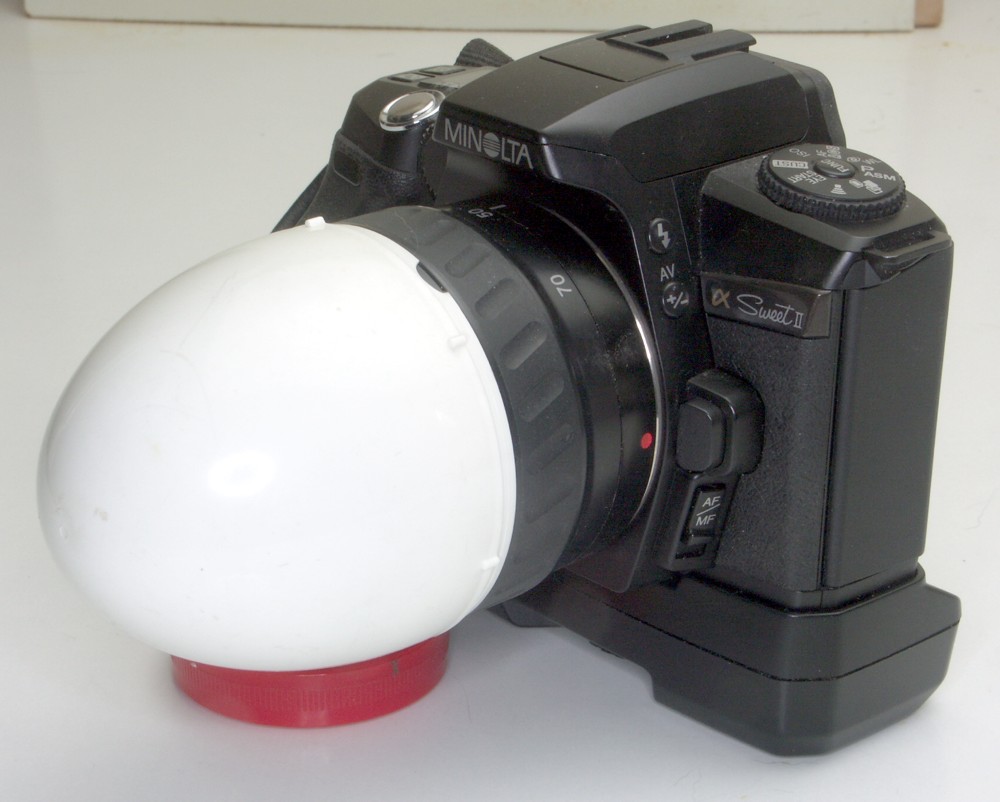

For years, I've used the top of a WHITE L'EGGS pantyhose container -- MUCH more durable than a Styrofoam cup. Turns your reflectance meter into an incident meter -- FOR FREE.

Besides Minolta any of the other brands meter have removable dome? I want to get one of the dome to built my own meter. The L'EGGS is too big for what I want.
Not all of Minolta's meters had removable domes, and many meters have domes that simply slide in or out of position. Some meters require you to "flip a switch" when you make the change, others not.

I've got some Minolta domes that are from the 1970's, and they don't show any yellowing. I wonder what causes that. My L'EGGS pantyhose cap is probably from the same era, and it looks fine too!
