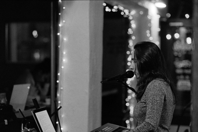

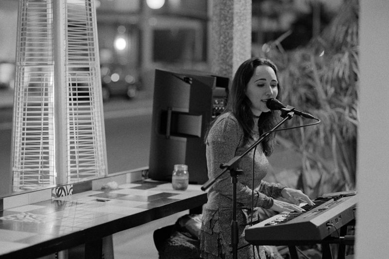

First test is scanned. All done in xtol 1:1 at 18.5 and 20C
P3200. I even OVERexposed some the first night. I tried to meter the light to put faces at middle grey to get an approximation, I guess f/2 1/50, but really got great shots at 80-100 from f/2.2 to 1.8.
f2.2 1/60
f/2.2 1/160 (this was from the side that's actually better lit)
f/2 1/80
1/40 at 1.8 -- this was a touch overexposed, but negative lab pro still gets the details and pulls it back just fine
I shot a roll and a half last night on a different musician (who was a cool guy and who had lots of family and friends around who were fun people) but it's really sunny and beautiful out so I'm going outside. Excited to see them in the photoshops tonight.
Short conclusions:
1. P3200 is cool -- likely to use it again
2. 3200 is absolutely usable for awkward and difficult light
3. I could use my Mamiya wide open in this location -- I have an 80 2.8, so if I can get shots at 1/80 and 1/100 at f/2.2 the mamiya is usable.
4. Might even try the tmax developer on 3200 in the future, just to see the differences.
Excited to do more. Might be bold and try the c330 with that delta I have in 120 next.

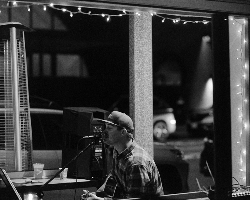

Just to round it out, the second roll I took a day later at the same place. It's a coffee shop owned by friends and they've had musicians on that patio. We've been very lucky with the weather (They planned to start hosting music next year, but figured what the heck, start at Thanksgiving and do it on nights that are nice) but I don't think I'll get a chance until after exmas, we have a ton of rain coming.
The second night was harder. He was wearing a baseball cap and the heater, which had a bright flame in the middle, was not lit so there was no fill light from the street side. He's just lit by the shop sign and that flood light behind him. Also, he was really cool and drew well, so the place was really crowded and it was hard to get good angles. Excellent challenge to have:
Good possibilities here. Excited to see what I can get out of the Delta, but I think I'll be using the Kodak a good bit in the future.

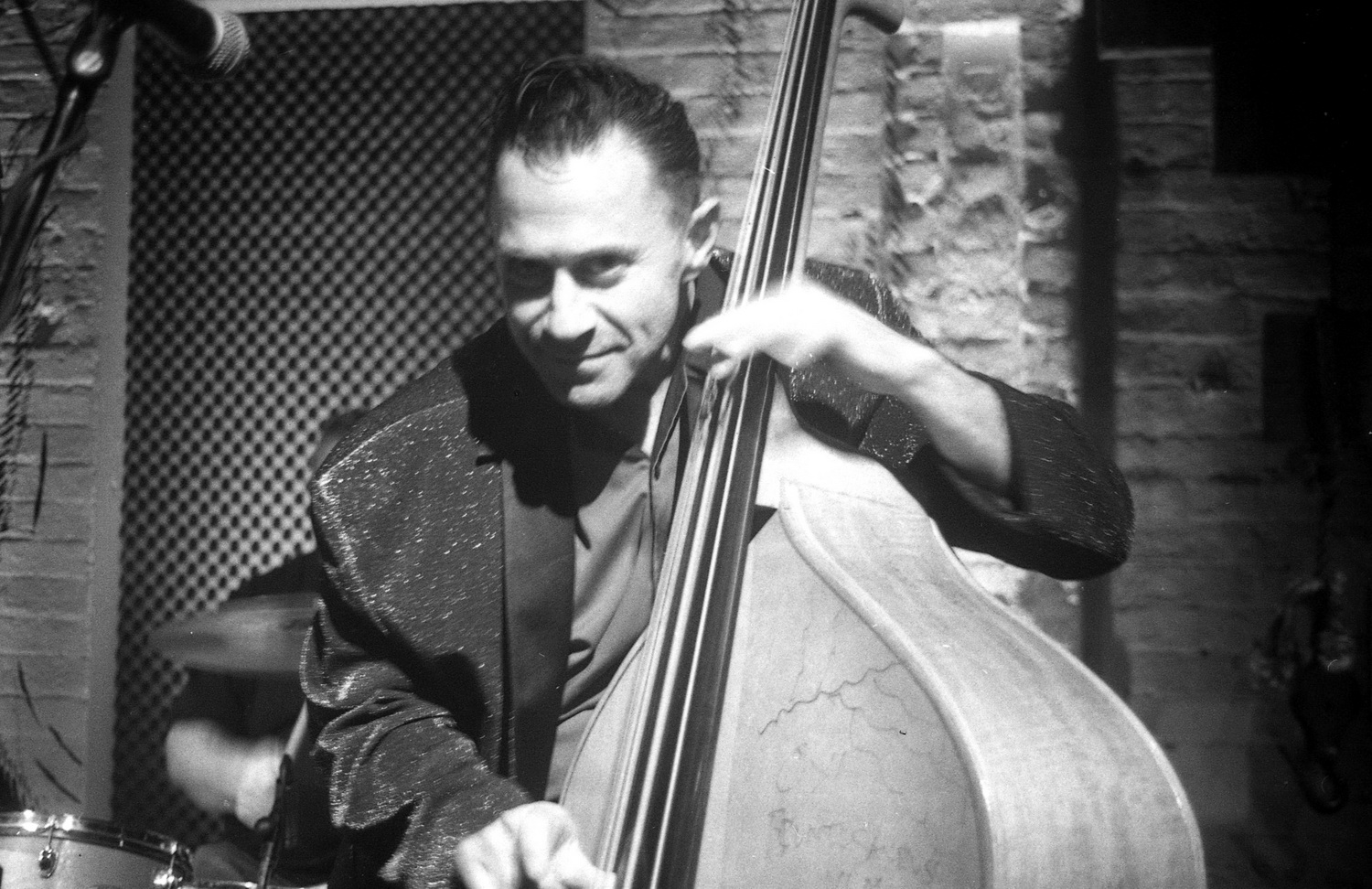

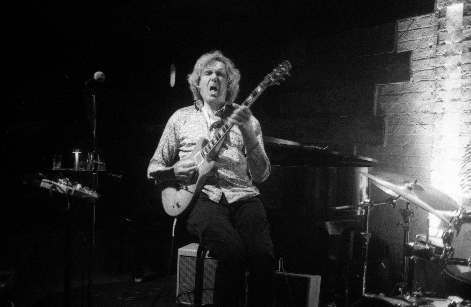

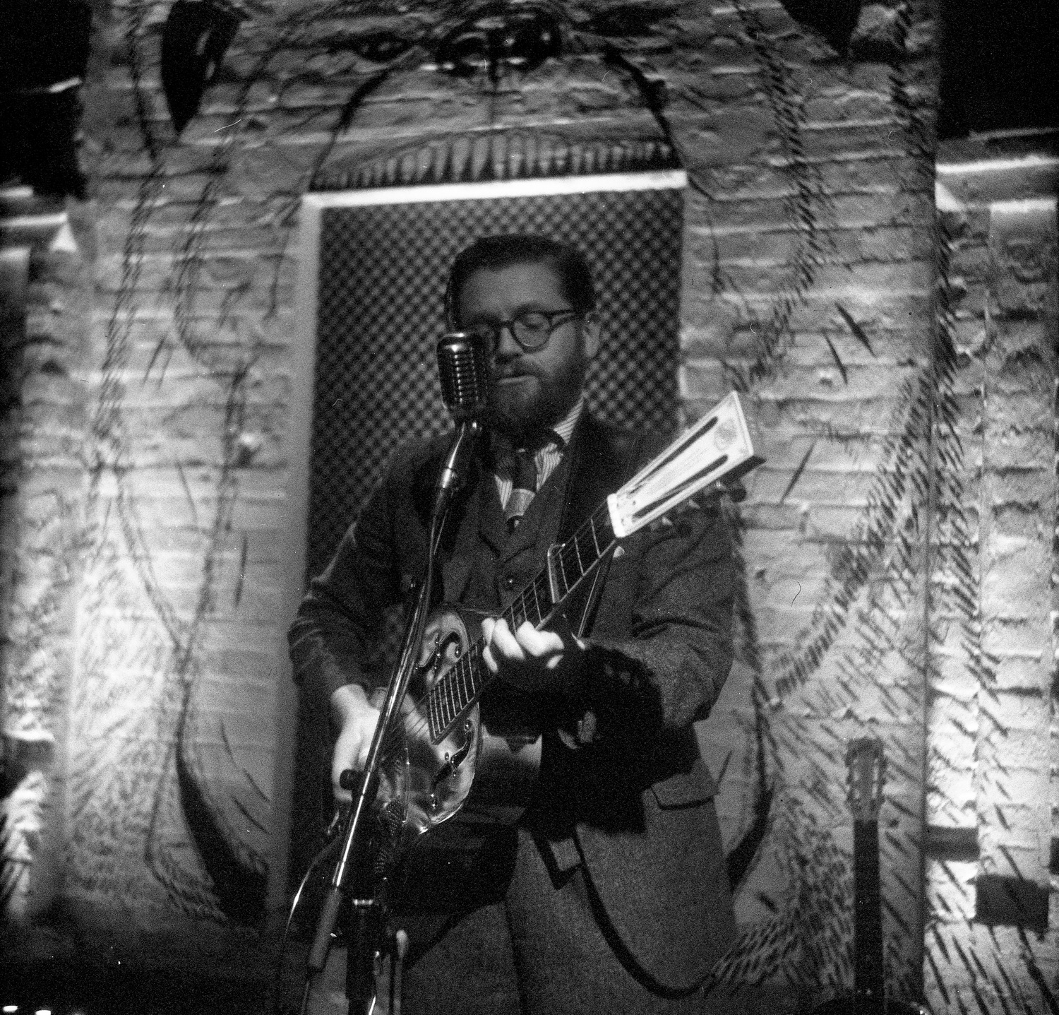

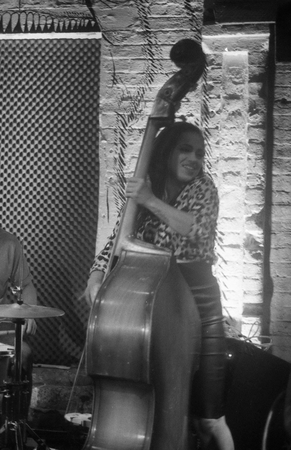

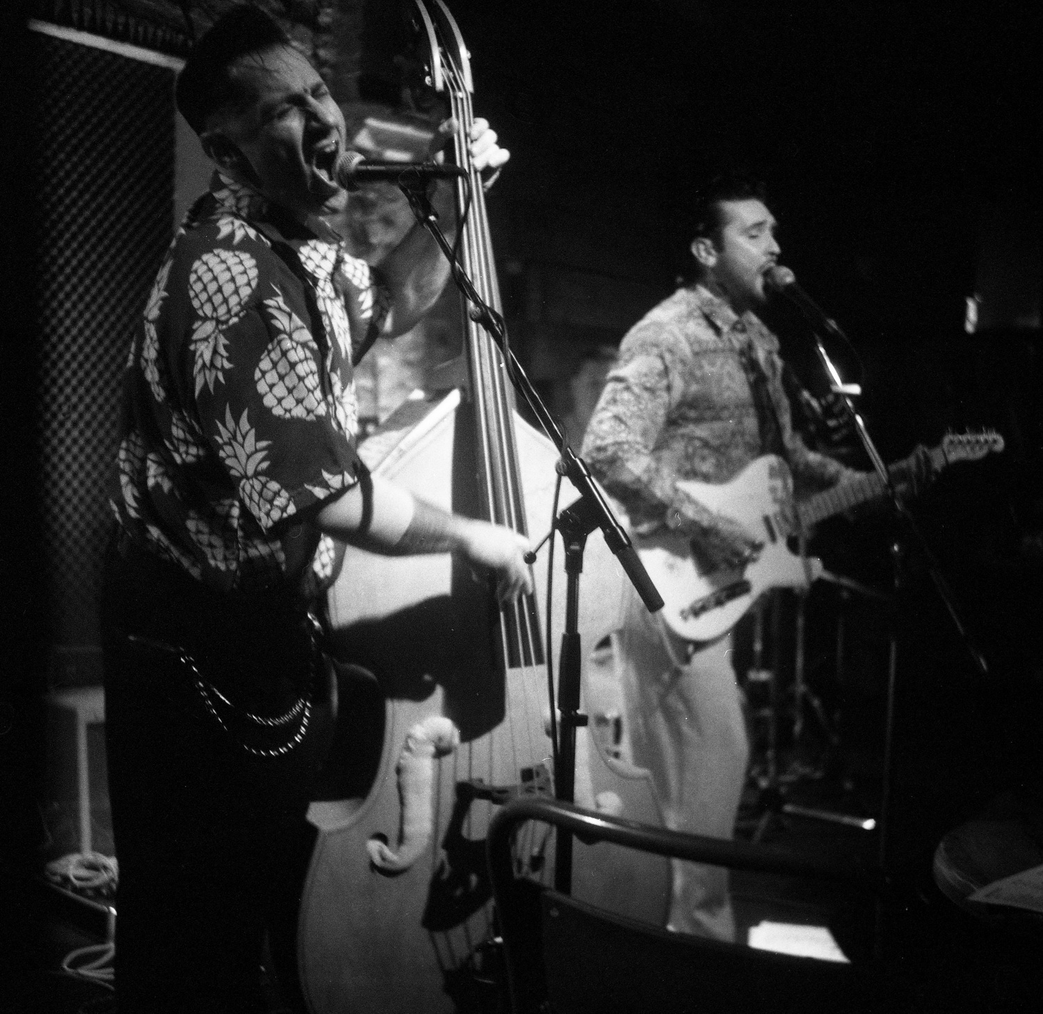

Coming to this a little late, but I often use both Delta 3200 and HP5+ at my local jazz and blues club. I tend to use D3200 in medium format and HP5+ in 35mm but that's not always the case.
Basically....what MattKing said. The P3200 and Delta 3200 are, in technical terms, ISO 1000 or thereabouts. But are designed with contrast characteristics to be exposed at 3200 and "pushed". I've actually shot Delta 3200 at 12,800 20 years ago when a night club owner wanted shots of revelry without flash. Grainy as hell but it worked in a time when there was no other option.
I'll share some of my favourite shots from recent years....which I have probably shared here before but here goes. the square 6x6 shots are from a 1937 Ziess-Ikon folder so not even a modern lens.

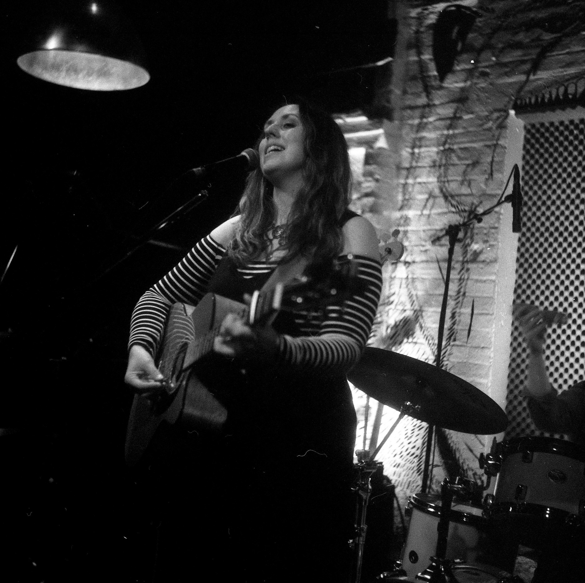

For comparison here are some I shot on HP5+ at around 2000ISO, developed in ID-11 stock. Higher contrast, different look but still pleasing. These are 35mm, all shot in a 60s Yashica rangefinder.
I've become well known at the club and have befriended a lot of the musicians there, who notice I am shooting on film and are interested in the results. Several have gone on to use my photos in their promotional material and one threw me a few hundred quid to use one as an album cover. But I do this purely for fun, with permission of the club owner who is a photographer himself.

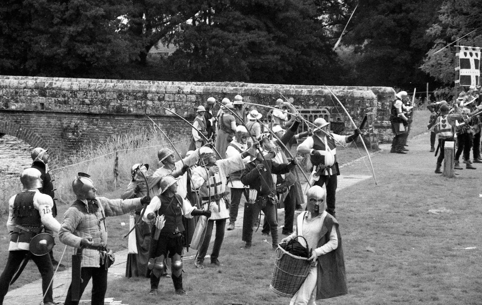

Here are some TMAX 3200 shot at box speed in cloudy daylight. I wanted to have high shutter speeds for the horse action and I think it worked well. The still shot of Herstmonceux castle looks good too. Praktica BX20S, Tamron 28-200 lens, TMZ at box speed in Microphen stock. late August 2021.
