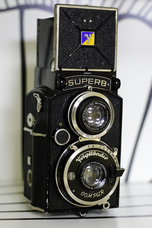

I broke the budget by the double but ended up with this beauty that should last a long time.
The bad news:
The focusing is quite stiff (managed to get it there from stuck).
Sadly the ground glass aparently got busted one side during transit, still works though.
The black paint on the protruding part on the body under the lenses is kind of gooey and makes your fingers silvery black. It must a different paint than the rest of the body.
The good news:
After a bit of cleaning everything seems mechanically sound and nothing broken or bad.
The optics and the mirror is in great condition, optically also the ground glass after a cleaning.
Only slight oxidization on some parts left after cleaning but no serious rust.
Leather is good.

Why are the shutter speed ring digits rendered in mirror-image, while everything else reads correctly?
Ken
Dec 1, 2014
80
Sweden
Ken
Voigtländer engineering!
- How are we going to show the shutter speeds when looking down at the camera?
- Maybe linking the selection ring to the viewing lens and paint the numbers also there?
- Too easy and maybe patented by the others.
- We could use a mirror prism.
- Yeah, that's an original way!
- Oh, the numbers are shown mirrored....
- That's a bummer.
- Lets paint the mirrored!
- Goofy but it works.

Anybody else?
Ken
Dec 1, 2014
80
Sweden
Anybody else?
Ken
The answer is in the dialog. They had to avoid patents so they used a mirrorprism to reflect the shutter speeds up towards the user. The problem was that the mirror mirrored the numbers so the simply mirrored the marking so that they turned out the right way in the prism.
