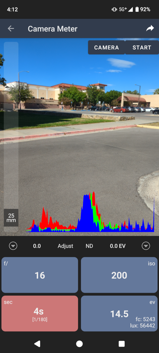

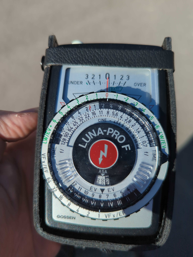

After some nudging from this forum, I have acquired a handheld light meter: a Gossen Luna Pro F. However, I'm not getting sensible results from it. I am hoping that this is just user error.
Batteries: I inserted a 9V battery that is not "fresh" from the store, but has been stored under good conditions (20°C , low humidity) for 1 year and my battery tester says it's close to full charge. Furthermore, when I test the battery with the light meter's own internal battery tester, that too says that the battery is fine (the needle quickly goes to the "Over" side of the scale).
Usage: I watched this tutorial by the Film Photography Project. Here is a link to the manual.
Zero Position: As per the manual, I checked that when the meter is off and horizontal, the needle is covering the green line. I adjusted the needle by the tiniest amount using the adjustment screw on the back.
The Test: I walked outside my office under beautiful sunny conditions --- precisely the kind where you should be able to use the Sunny 16 rule. I picked a scene and first checked it with the light meter app on my phone. The app recommended shooting at ISO 200, F/16, 1/180" --- confirming the Sunny 16 lighting conditions. Then I grabbed the Gossen light meter, I set the ASA to 200, I moved the plastic orb thingy to the side so it's measuring reflected light --- so it should be doing the same thing as the phone's light meter --- and pressed the button. The reading is way off. It says I should shoot at something like F/8 and 1/4". The images below show both my phone's light meter app (including an image of the scene) and the Gossen light meter.
Worse yet, the readings are inconsistent. While writing this message, I decided to go back outside and try again, and now it reads the scene even darker than before. Now it's telling me to shoot at F/2 and 1/4".

Tried a bland scene. Doesn't help.
The phone light meter doesn't have a mode setting. It's just using the phone's camera, so it can't really be anything other than reflected mode.

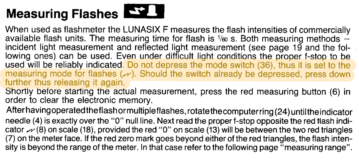

Sorry but I must ask. Is the meter in ambient or flash mode?
No no, I'm glad you asked. I think you got it!
I think I misunderstood the flash setting and I had it backwards. I thought that if the button is "up" then it's normal mode, and "down" is flash mode. So I had it "up". But I just toggled the button and the needle shot to the right.
I cannot test the same conditions anymore (sun has gone down) but I tested again on the hallway, and now the Gossen meter is just over 1 stop away from the camera's light meter. The Gossen meter says to shoot at F/8 and 1/15" for ISO 200, while the app on my phone says to shoot at F/8 and 1/6". Hopefully the 1.3 stop difference can be explained by the two meters weighing the scene differently.

You are not the first to make that mistake!
Try the comparison in better/more illumination, before you draw any conclusions.

Glad to hear you figured it out. I was watching the video tutorial, the fellow had to go back and release the flash button. The beauty of an all analog meter! Good shooting!

Well... The whole reason for buying a light meter is the implicit expectation that it will perform better than a phone. When it arrived, I tested it and I could tell intuitively that the readings were way off. I waited for sunny conditions to test again with better lighting. I reported Sunny 16 and the phone as two independent measures --- my subjective assessment + the phone.
As limited as a phone meter is, it should not have a 7.5-stop discrepancy with the Gossen. So it is good enough to detect a cathedral-sized error in the Gossen. Especially if the phone agrees with what I judge with my eyes.

I for one don't trust the phone but since the OP tested under sunny 16 condition and although the scene has influence the error was too large. That's why I thought about the flash and ambient mode.
