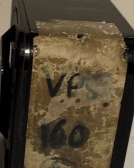

This is what the label on the outside of the loader looked like before I cleaned it off:
VPS 160 -- after some googling (and I'd like to impress here the point that google is increasingly useless)... a bulk roll of Kodak Vericolor 160, right? "Cool to find a bulk roll of C-41, time to bracket a test roll and find out the optimal speed, who knows when it expired!" I think to myself.

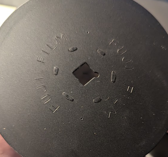

Anyway, I finish loading the rest of the roll and labeling the resulting canisters as (prospective) C-41 film for my future reference. Then, with some difficulty, I pry open the loader and I'm greeted with this:
What the--?! It seems possible but exceedingly unlikely to me that someone loaded a bulk Kodak film onto a Fuji spool. This is what the film sticking out of the final canister looked like:
Now while I was cleaning the grotty label on the bulk loader off, I noticed there was another grotty label underneath. I can't really tell what it actually said though because it was covered in sticker gunk, paper, and texta bleedthrough from the top layer, but what I did read was what looked to be "Vel" (the rest was cut off) and "400". This doesn't make any sense to me as I don't believe there was ever a 400 speed Velvia, and nothing in "Neopan" resembles "Vel"... I read somewhere else on this forum that Fuji did used to sell bulk rolls of Velvia at a point so at least it's possible for it to be Velvia, but I can't explain what the 400 is supposed to mean if it is.

The Fuji spool may have been re-used from something else - some have access to film re-spooled from 400 or 1000 foot lengths, although most of that is motion picture stock originally.

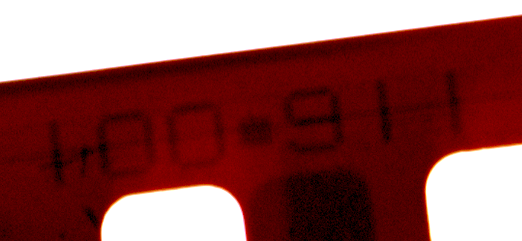

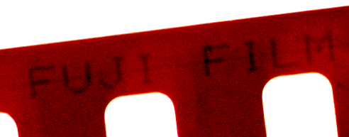

I've gotten a test roll back from the lab, developed in C41. It is DENSE (my other C41 rolls came out fine). The edge markings are really hard to make out, but it's definitely Fuji. Says 100-911. Any ideas what this is?
The "911" is likely what Fuji called the production number. It identifies the rough date the batch was produced I think.
100 probably identifies this as pre-Superia FujiFilm 100 ISO colour negative film. Superia was desingated "S100"
So my best guess, if I am correct with the above info, is that this is possibly Fuji Super G 100 from earlier than the late 1990s.
Anyone got more info on Fuji's codes?
