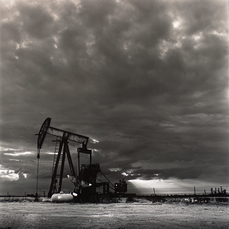

Great picture.
I've never seen one of those things in person. Are they powered by an internal combustion engine? Does the pump that pumps oil need some oil to run?

Great photo again, yes.
I'd say electric drives are more common. If it were a combustion engine, it would not run with the crude oil you pump from the ground.
Lars
Electric drives are the rule pretty much these days. In my youth, growing up in Oklahoma, the pump jacks ran on single-cylinder combustion engines called "popping-johnnies" and burned the casing gas that condensed out of the crude oil or, if the well produced natural gas, it burned that. The casing gas was called "drip" and it was unleaded in an era of leaded gasoline automobile engines, so many a "drip thief" would burn up their car or pickup engines by stealing this gas for everyday use.
Some of these pump jacks and engines could be enormous. I worked as a roustabout in High School and College during summers and had to service some of these monsters. We would re-pour Babbit bearings for the walking beam, service the motors (rings, plugs, head gaskets, etc.) and take radiators into be repaired.
