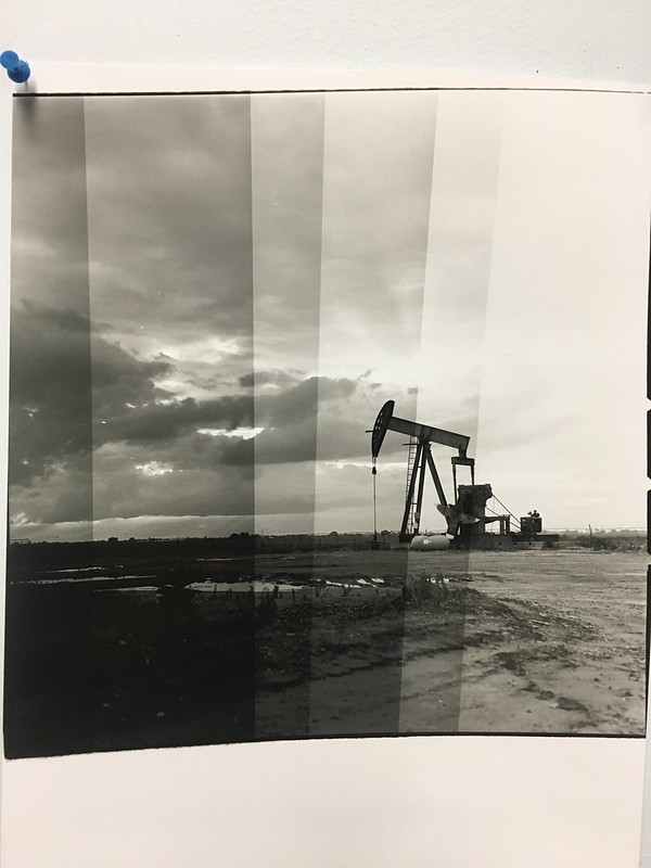

So much gratitude. Thank you. After reading this thread, several messages that APUG members have so graciously sent me, and several chapters of Way Beyond Monochrome, I decided to get after it. Picked a negative with good density. It was a sunset with crepuscular rays, no graduated ND filter, no red filter or polarizer. Shot on Delta 100, developed in Xtol.
So first I aimed for the broad side of the barn. I made a test exposure with a geometric progression at f11 using half stops: 32, 24, 16, 12, 8, and 6 seconds (cut me some slack, I don't have a safelight and did everything in complete darkness).
I picked 14 seconds as a base exposure to start, based on a mixture of textures in the shadows and how the clouds looked. I wanted a bit more texture in the shadows of the pump jack, and I saw what I liked in the 12 second test strip. Then I used that exposure to make this abomination of a print map:

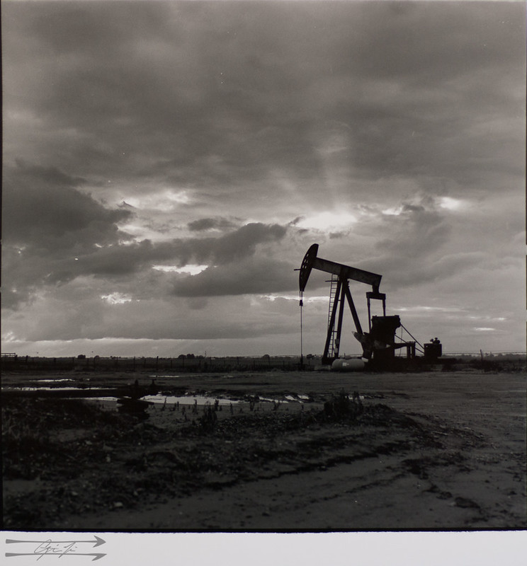

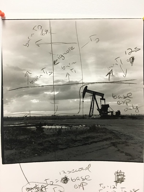

Which I followed as closely as possible to get this print, which has not been altered digitally in any way. Just a straight raw to jpg off my camera. In fact, it's just a teeeeny bit more contrasty than the actual print. This print was where I decided to call it a night.
As far as tweaks, I'd like to make the top left a bit darker still, and maybe go up a half to a grade of contrast to get the clouds to really stand out from the sun highlights. Perhaps just do the increased grade on the sky burn ins? Hadn't decided on maybe making the road a 1/3-1/2 stop brighter. Unfortunately, the negative has several physical defects that are clear in the print.
Thank you so much everyone, I have a completely immersive new obsession courtesy of your enabling. I am in love with doing this already.

Wow, excellent for a first take. You can try quite a few techniques on this neg. Maybe bleaching the puddles on the ground looks interesting as well.

Congratulations on your first print!
Something else I learned through experimentation, is that the darkroom doesn't have to be completely dark. I found that I can get away with a candle in a jar, not shining direct on the working area, and working methodically with a single sheet of paper out at a time, closing the paper box immediately, working to get it in the fixer as soon as possible. Supplemented with a red bicycle light when needed.
Fogging depends on the paper, light in the dark room or more specifically shining on the paper, and duration. It is safer and easier to tell everyone that a dark room should be completely dark, but that is not necessarily true. It is easy to test your individual setup for fogging with the coin test.

Print's come out a treat.
Not sure how you are making your test print but what caught me out for ages was -
Id give the whole sheet an initial hit of say 10 seconds then mask a strip then give rest of paper 5 seconds then mask a strip and give rest of paper 5 seconds etc etc. If i liked the strip that was 10 seconds + 5 seconds + 5 seconds on test strip that is not the same as giving print a constant 20 seconds!
Thats explained terribly but hope it makes a little sense.
Lars
Thanks! Yeah I was definitely thinking the puddles should be a full stop brighter. Now the fun begins: when are you actually DONE with a print. Hah.
Correct me if I'm wrong, but grades 00-3 get the same exposure time right? So if I want a grade more contrast in the sky, I can use my existing print map with no filtration (so Grade 2), and just add 25 Magenta (per Ilford specs) on the dichroic head?
I'm not sure I follow.
I picked (pretty randomly) a base exposure of 6 seconds of F11 and I made the test print span 2.5 stops.
Moving left to right, first strip gets 8s, then next strip gets 8, then 4, then 4, then 2, then 6. That gives six test strips with a total time of 32, 24, 16, 12, 8, 6 seconds.
Now what you're saying is that if I liked the 16 second strip as a base exposure, in order to replicate it I would need to give it 6 + 2 + 4 + 4? Can you explain why? Because for my map print I chose a 14 second base exposure, a quarter stop darker than 12 seconds, and I gave it a constant 14 seconds, then developed. The map print looks exactly like I expected it to when placed next to the 12 and 16 second test strips.
