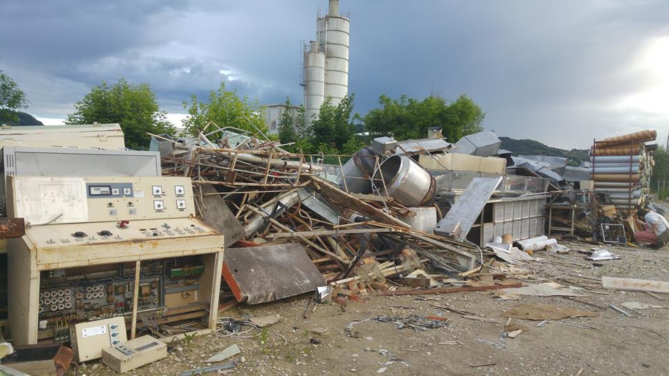

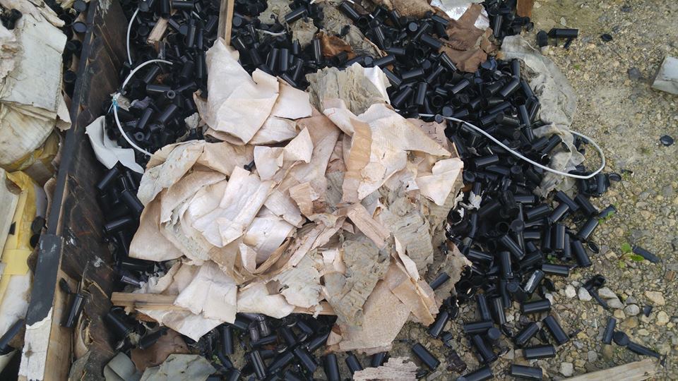

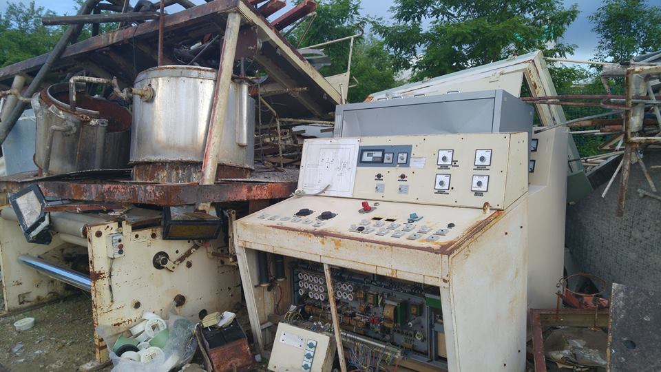

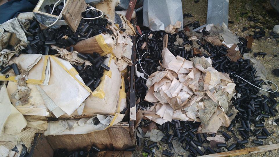

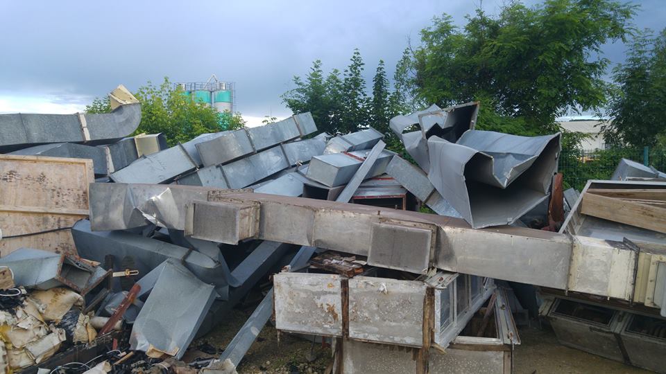

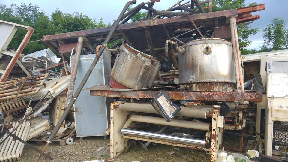

Because ekfe had completely different and old coating equipment and the films need to be reformulated for modern machinery. AFAIK this is what Adox is doing with some films
Because ekfe had completely different and old coating equipment (...)

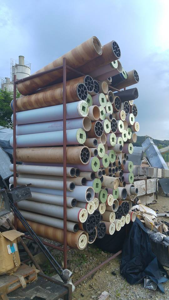

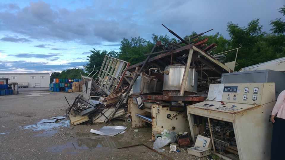

And here it is sometime in 2016, in all its (former) glory, waiting to be towed away for one last time.
fotokemika_2016_1.jpg fotokemika_2016_2.jpg fotokemika_2016_3.jpg fotokemika_2016_4.jpg

Really sad to see Efke's machinery on the scrap heap, on the other side, the LRF was abandoned and now put to good use.
