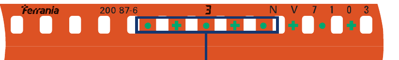

Oh, and if Film Ferrania are reading this, it would be great if you retain the iconic + and . markings in between the sprocket holes!
That was one way we could once tell is a house brand film was made in the FERRANIA plant!
BTW, does anyone know what the reason for these were?
I dont believe these markings were found on scotchchrome either, but was seen in negative films such as solaris.
back when the printing was all done on real paper direct from the negatives, each type of film had to have it's own tweeks in the printer. The dyes in the film were different between brands, and different versions had different printing characteristics. the DX bar the bottom of the negatives was supposed to cue the printer on what film was being used, and select the right "channel" so the prints would come out right.
to make it easy for the printer operator, some films started coming out with a green or magenta stripe on one of both sets of perfs. then as they changed two stripes or one solid and one dashed stripe. Konica had a Blue stripe, Agfa had a bunch of black squares and Ferrania had a contamination of dots and plus signs which changed with the different version.
the image posted here is a small part of the chart in the data sheet for Solarus FG200
