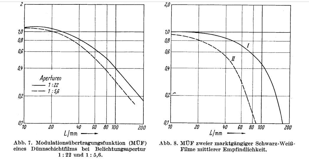

Full red sensitivity and good hardness were known for over 60 years. The trick was to prevent continuing hardness that ended up in curl and cracking. The red sensitivity extended back just as far. No tricks here. I find no references to Dunnschicht-Film.
PE
PE
:smile:.... I did it ( in practice ) with HP5 135-72 :cool:
with regards
PS : Just a little joke PE I understand what you refered in regard of layer thickness of cause:whistling:
Mitteilungen aus den Forschungslaboratorien der Agfa-Gevaert-Ag., Leverkusen und München, Springer 1964
Aha I see European - so the courve indicates a better resolution in regard ol LP/mm or Lines per mm - I am just gues the contrast was 1/1000 as we know from camparison of emulsion today.
So we indeed talk about the thickness of layers.
I remember a statement to Kodachrome layers. Because of different design the layers from Kodachrome films was with less thickness of layers of E6 films (as E6 from the same period ) this should have been one reason of Ektachromes Sharpness,
In adition to his real less speed. ( KDK25/64 ).
with regards
PS : May be todays emulsion layers all have a simular thickness caused from modern production methods with extreme small tolerances.
So the mentioned issue stand for the past ?- I could imagine - but I can´t say for sure.
:redface::redface::redface:....MÜF .... so better forget what I have sayd about contrast 1/1000 :redface::redface::redface:
Nobody is perfect:D.....
PE

Dünnschicht-Film (with an -Ü- not an -U-) was revolutionary in so far that the layer(s) of gelatin holding the silver were made thinner. I think this invention was made in the 50s or even 40s by a german manufacturer, maybe Adox, maybe Efke, i don´t know for sure.
One of the effects were more visible grain, but also more sharpness, i can´t explain why, but after this invention was made a lot of emulsions were desinged in that way, which should be one thing representing a new-style-emulsion. Apart from that fewer silver is needed and by that the film can be produced more economical.
This indicates that P30 still is old-style as it uses a lot of silver compared to other emulsions, which also might explain the rather high price of P30.

And by that, way of developement needed very well could be defined by design of the emulsion.
About Kodachrome: Kodachrome had a hell of layers, i also don´t know exactly, but it was like 30 or 40 different layers - and just because of that they had to make the layers very thin as the film would have become way too thick otherwise. An E6-film does around 16 layers i think.
