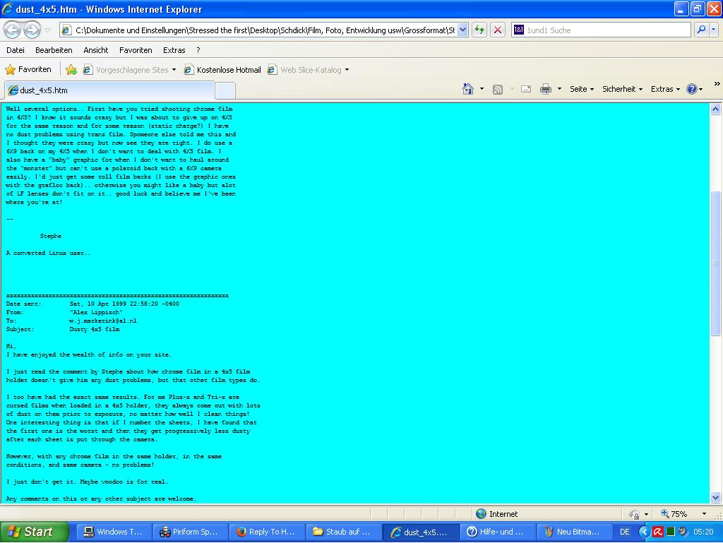

A few years ago i searched the internet for sheet film and dust problems. On one thread someone said that he did get dust problems with B&W sheets, but not with color-sheets. The website is down now, but when i did my search i found the color-sheets to have acetate-base i think. Or estar doesn´t create and pass static charge... at least someone reported that there´s no dust-problem with color and color had a different base than B&W.
All current Kodak & Fuji colour sheet films are on Estar/ polyester base & have been for at least a decade. Used to be a more random mix - some films on triacetate & some not, which caused a fair bit of annoyance amongst those who used registered masking techniques (triacetate is not dimensionally stable).
Unfortunately i didn´t save everything when i did my search some years ago. But i´m very sure that the color sheet film i checked back then did have acetate base. I think it was color transparency sheet film.
But i did save the website which is down now; it contains posts from 1999, here´s a screenshot:
That´s where two users talk about having dust with B&W, but not color sheet film.
During my search back then it made `click`and i started to look about the base material of the film types. Then i did my test with my plastic holders comparing acetate vs. PET and came to the conclusion that PET is responsible for the dust-problems.
