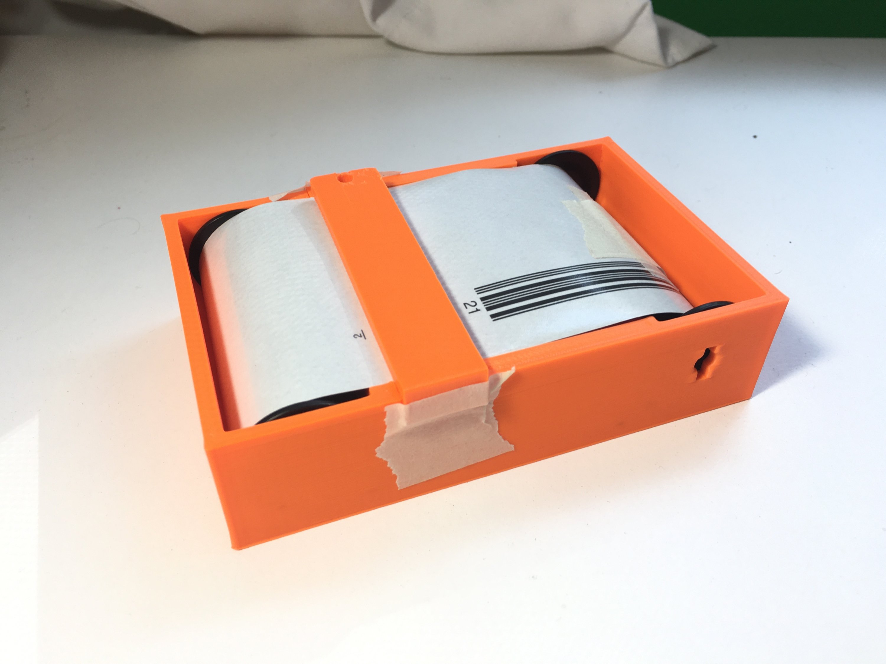

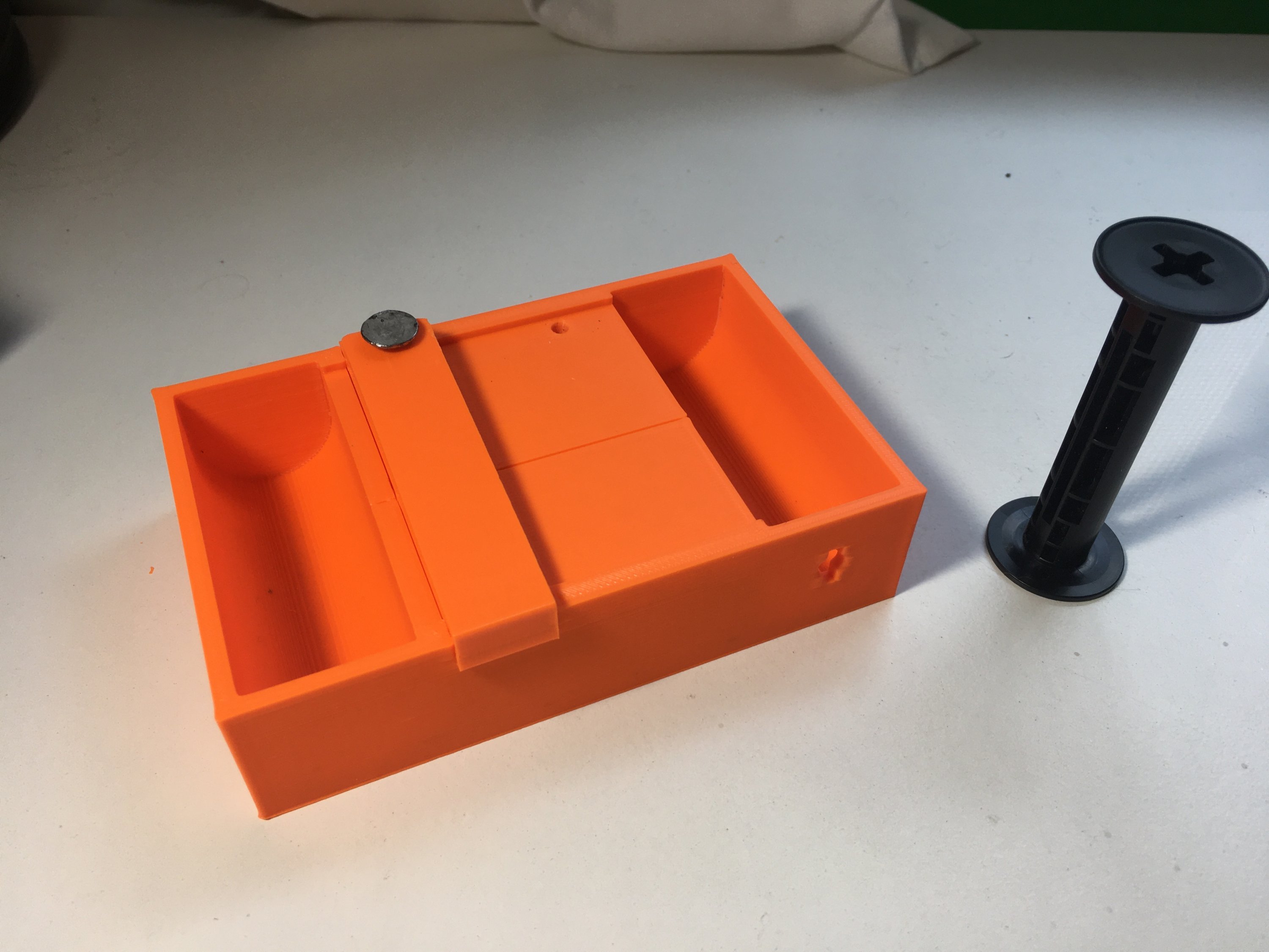

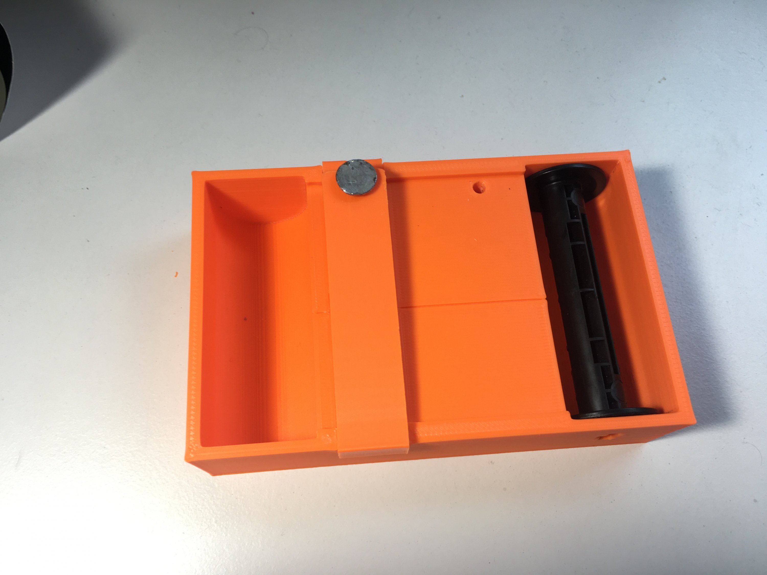

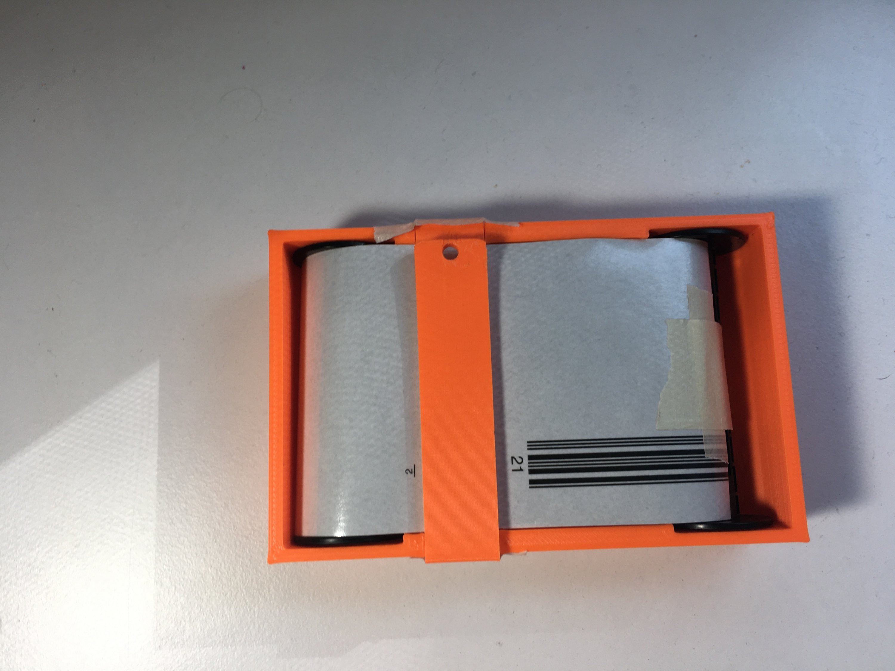

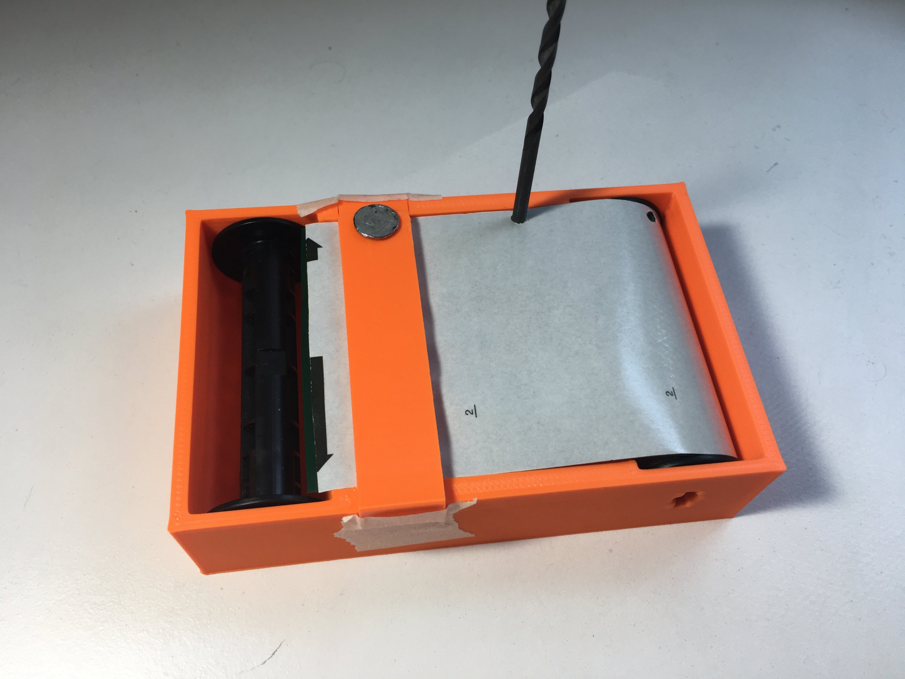

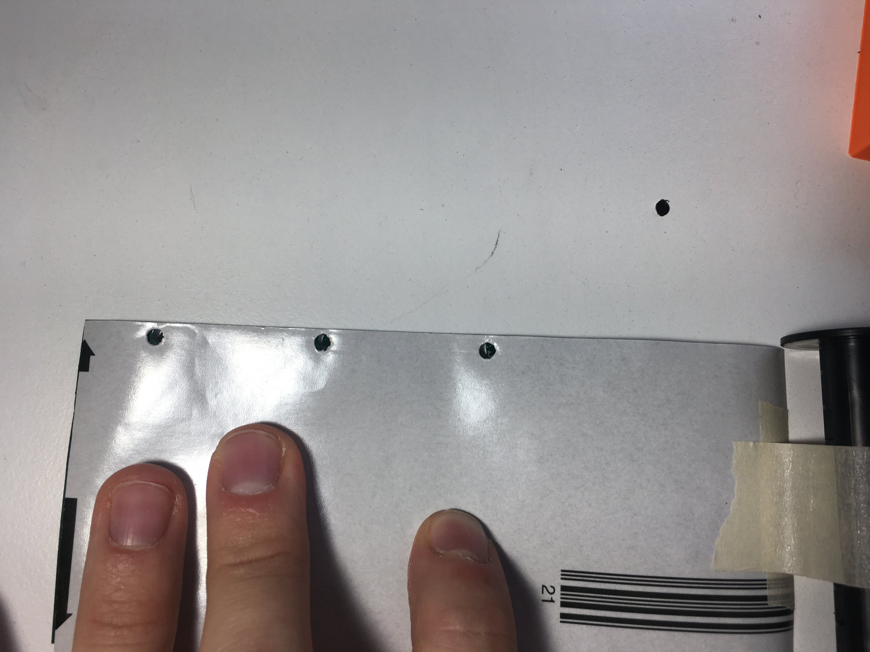

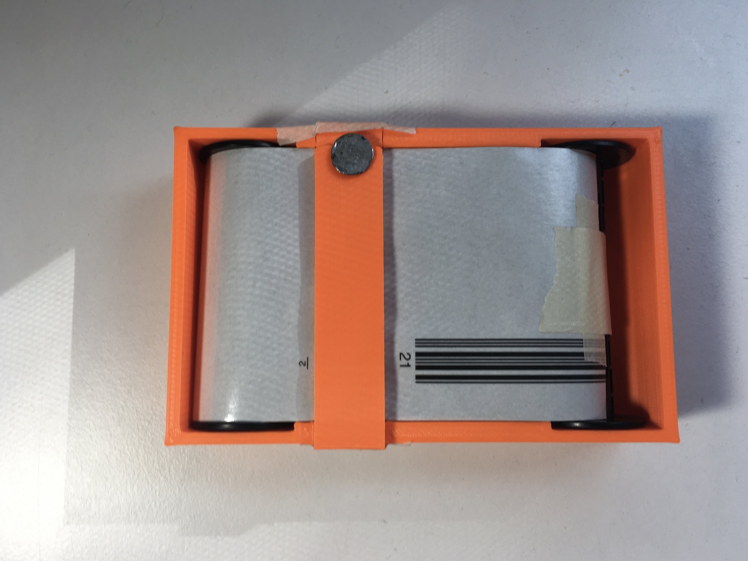

Hey everybody, thought I'd give a little update! I've rethought my goals for this project, and considering all of the input on this thread I think instead of remaking fully complete 126 cartridges and selling them, it would make more sense to make a 3D-printed device that allows the easy conversion of 120 film to 126 film. I haven't made a huge amount of progress, but I thought it would be good to see if anyone has input or suggestions for some hurdles I'm facing.
First of all, here is the device at the moment, the goal is to make something that will punch perforations at the correct spacing and then slit the 120 film down to 35mm width.
It has a space for a feed and takeup spool.
The way it's supposed to work is you would wind until the beginning of the film and then punch the first hole. Then you would continue to wind until a catch slips into the first hole made, preventing you from advancing the roll and providing perfect spacing. (The catch here is simulated by a drill bit). Punching the hole will ideally reset the catch and allow you to keep winding until the next punch is to be made. You do this 20 or 24 times and then you have a roll of 120 film perforated for a 126 cartridge, including backing paper. For slitting the film to the correct width, I'm planning on adding a blade before or after the punch.

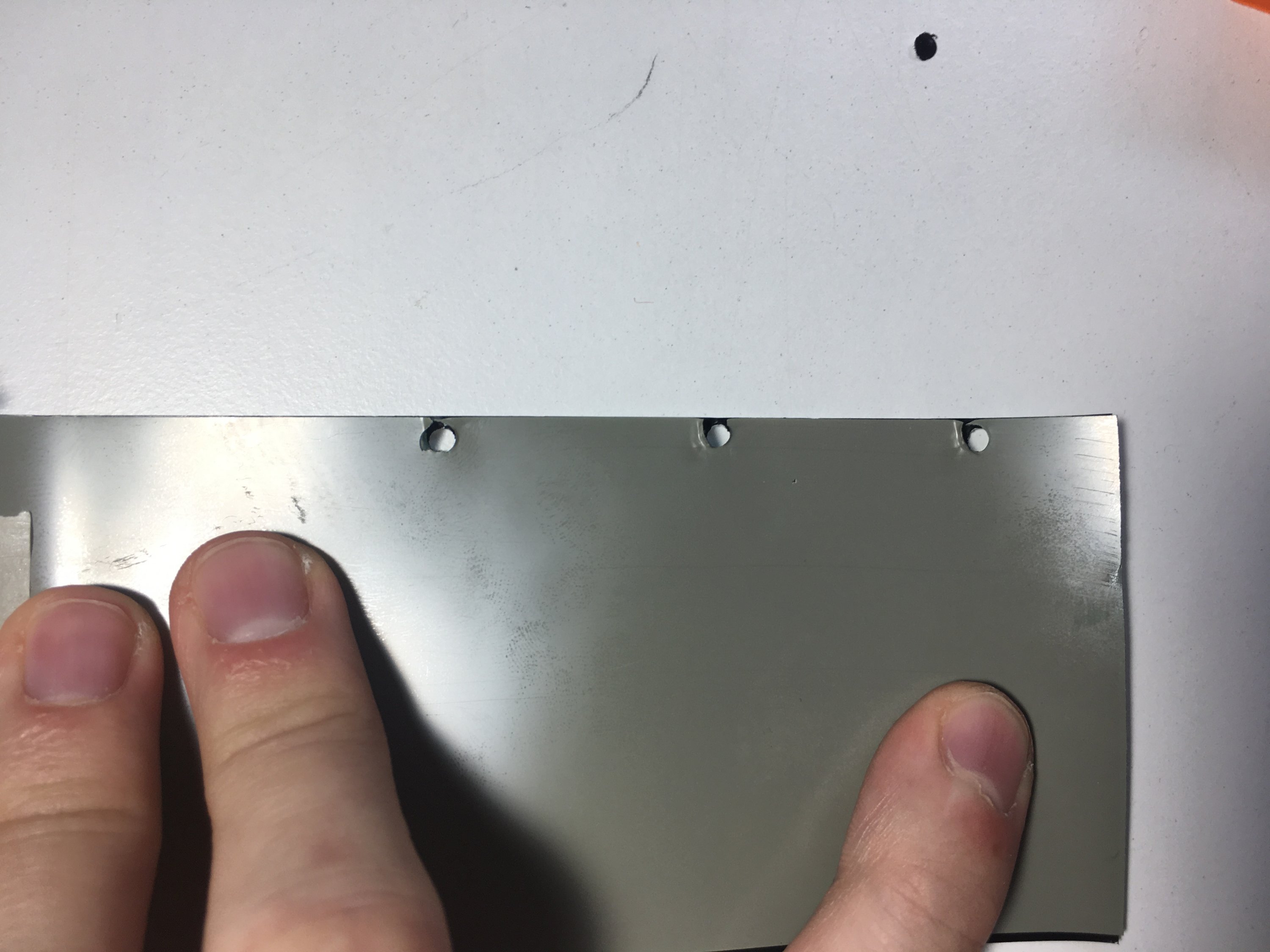

Now here's where the problems begin. The biggest issue right now is how to cleanly punch through the backing paper and film. I have tried a 3D-printed two-prong punch, which surprisingly worked okay for film-only, but didn't work on both the film and backing paper. I then tried a nail which i cut down into a two-prong punch which is the one you see in the pictures, however it sort of mangles the film and doesn't punch cleanly - as you see below.
If anyone has any ideas for how to easily and cleanly punch the holes that would integrate into this 3D-printed device I would love to hear it! I will try to keep updating this more frequently from now on!
If you spool all the way through the roll, then start back toward the beginning, the film will easily separate from the backing. I think that would be my approach, and would allow you to use the 3D printed punch (which you noted punches cleanly in film, just not film and backing). The user is going to need to have the film strip separated from the 120 backing anyway, in order to load it into the 126 cartridge along with a correctly marked backing strip -- right?
That's a good point! I guess my intention was that the backing paper from the 120 film would become the backing paper for the new 126 roll - it just would not have correct markings. This is because in my experience, its hard to find suitable backing paper for 126 film outside of old 126 backing paper. Now that I think about it though, does it really even make sense to have a backing paper if it's not going to show you the exposure count? Since I have fully modeled and successfully printed 126 cartridges, I'm wondering if maybe I could integrate some sort of new counting mechanism into the cartridge, not reliant on backing paper.
That sounds complex and prone to having tiny plastic parts break off and float around inside your camera. What I'd probably suggest is to cut your strip from 120 backing, but locate your strip so none of the 120 framing numbers show in the 126 cartridge window, then hand write or stamp the number at the correct spacing to match your perforations.
View attachment 250957 View attachment 250958
View attachment 250959 View attachment 250960 View attachment 250961 View attachment 250962
View attachment 250963 View attachment 250964
Greetings, I am in a situation similar to yours. I have discovered hollow paper punch bits that cut film and paper perfectly. The problem is in matching the hole in the paper with the hole in the film after making them and when rolling the film back into the 126 cartridge. Even in daylight it is difficult. This is why the holes in the backing paper are longer, I think. My apologies for my bad english.

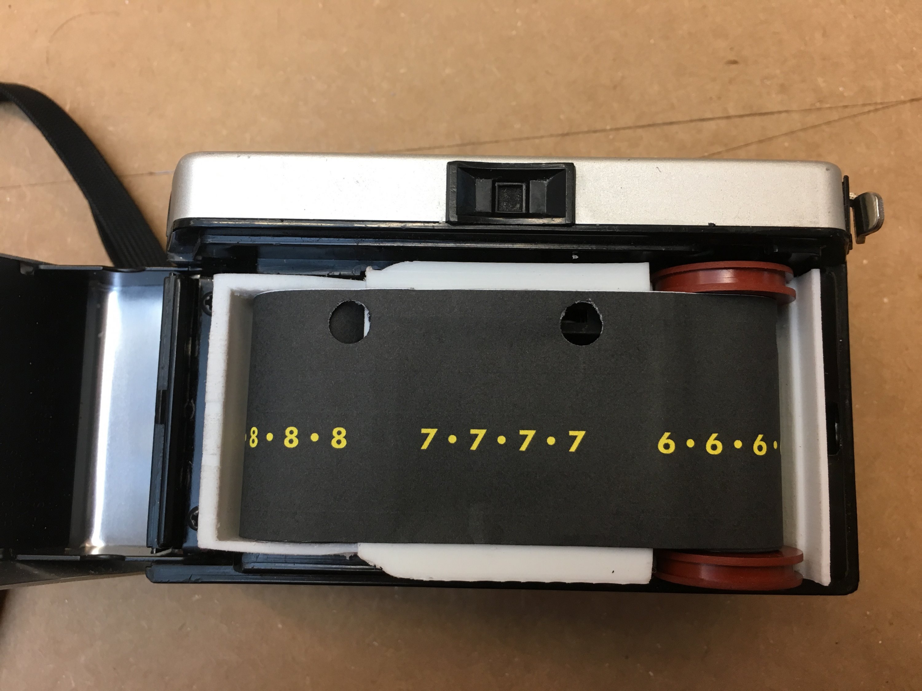

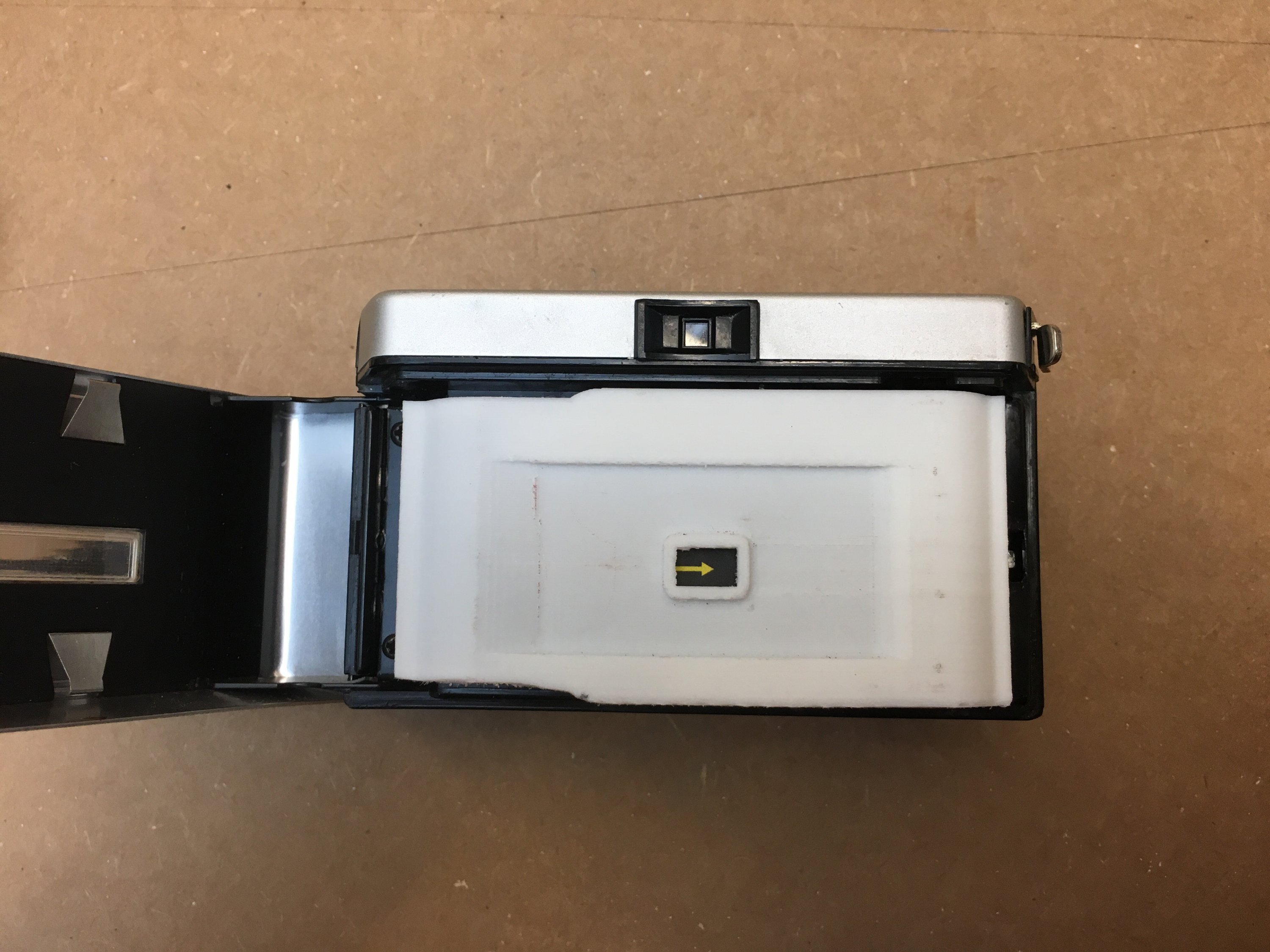

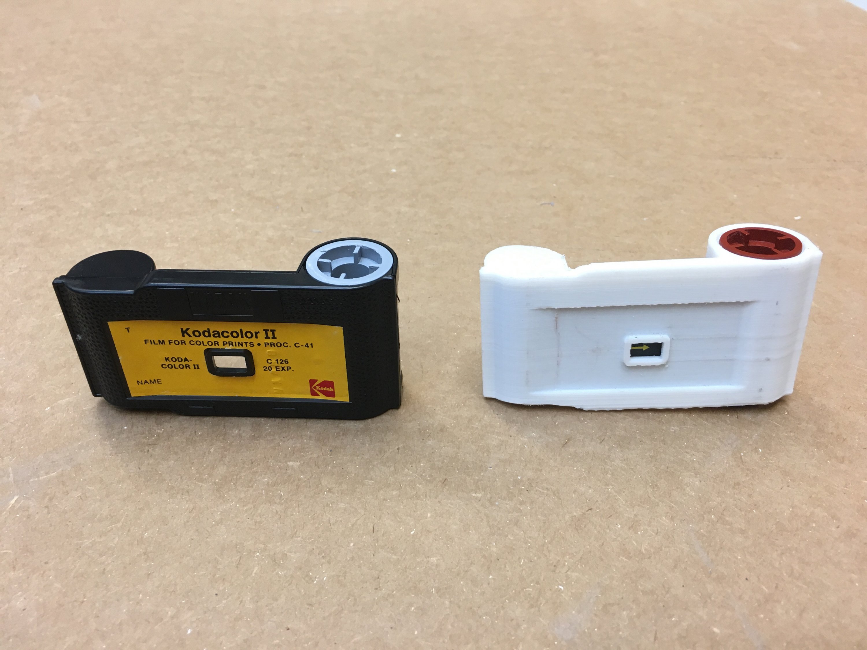

Absolutely correct! I should have been more clear when I talked about frame registration. Traditionally with 126, there is a sprocket hole for every frame in the actual film base and then a slot through the backing paper. I've found that even though my 31mm film doesn't make it all the way to where the registration pin would be, the slot in the backing paper works just as well to engage the film stop. I will definitely have to test how reliable it is but it has been surprisingly effective so far!

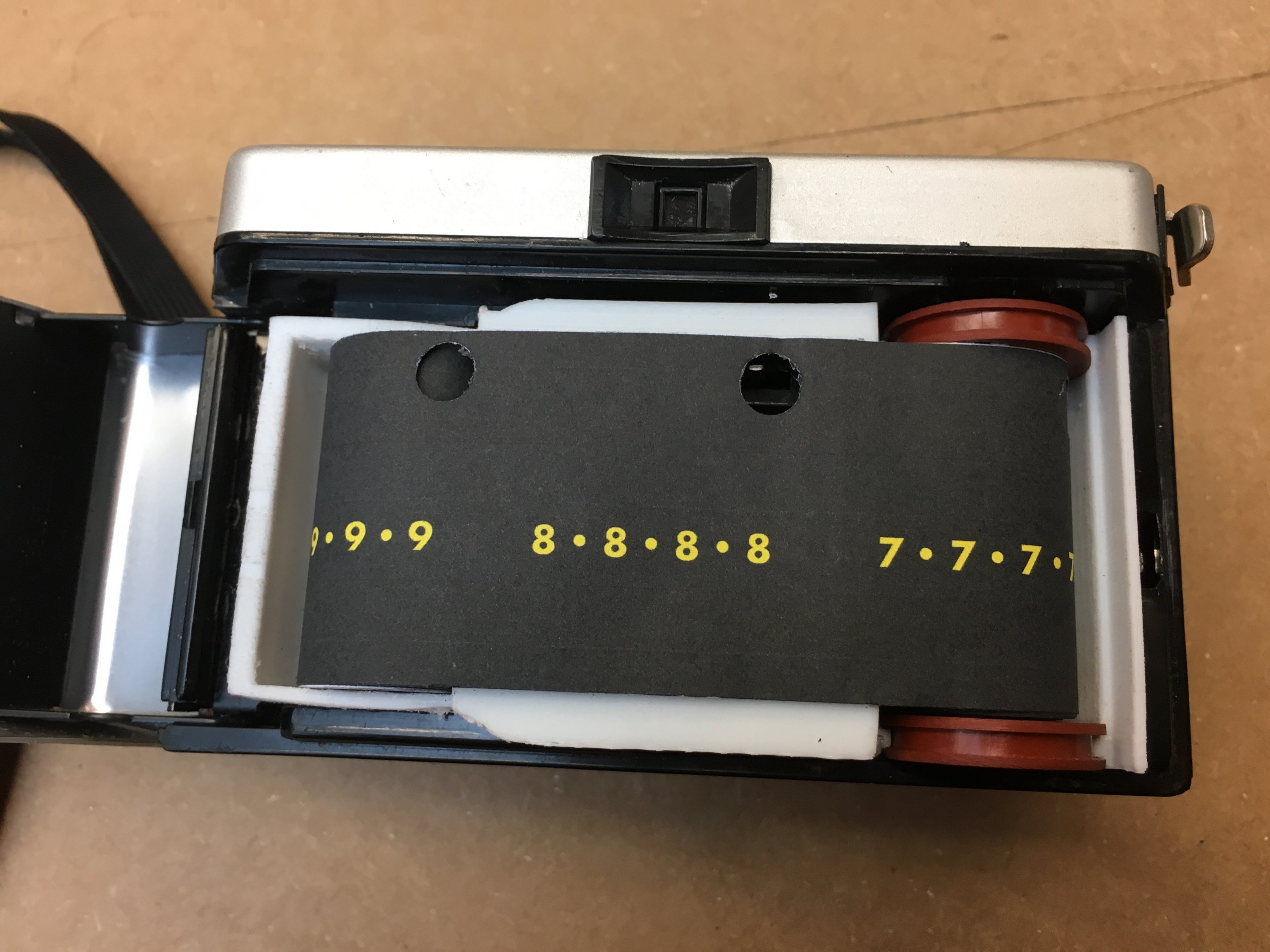

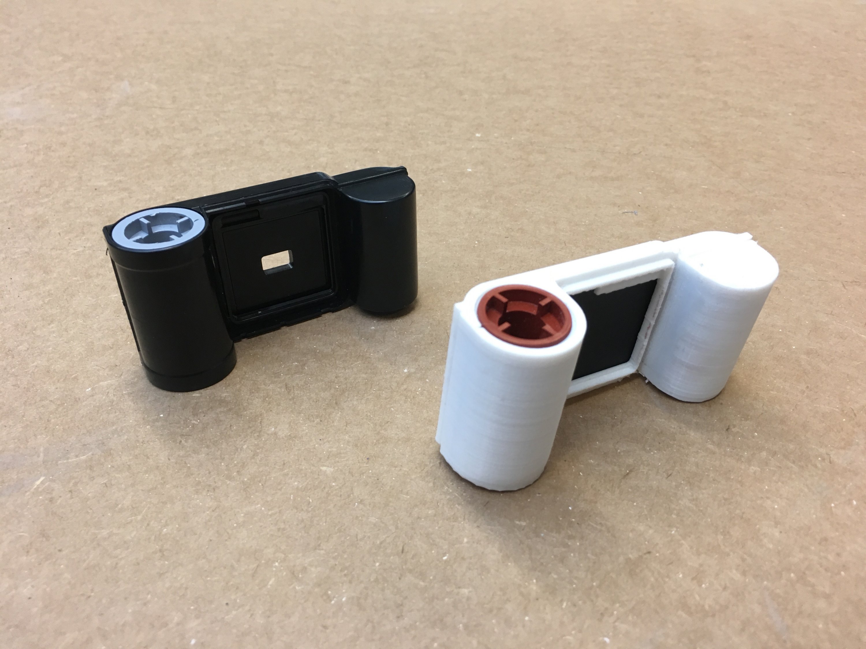

Edit: Here are some pictures to give some context--
Original Kodak cartridge on the left, mine on the right, the white color is only for this prototype.
The cartridge in the camera with the back piece removed and custom backing paper in place. You can see the registration holes near the upper edge, they are about twice the size the should be at the moment as that is the only hole punch I have.
The backing paper advanced to the point that it has activated the film stop for frame "8".
Additional images of the cartridge in the camera:
View attachment 241825 View attachment 241824

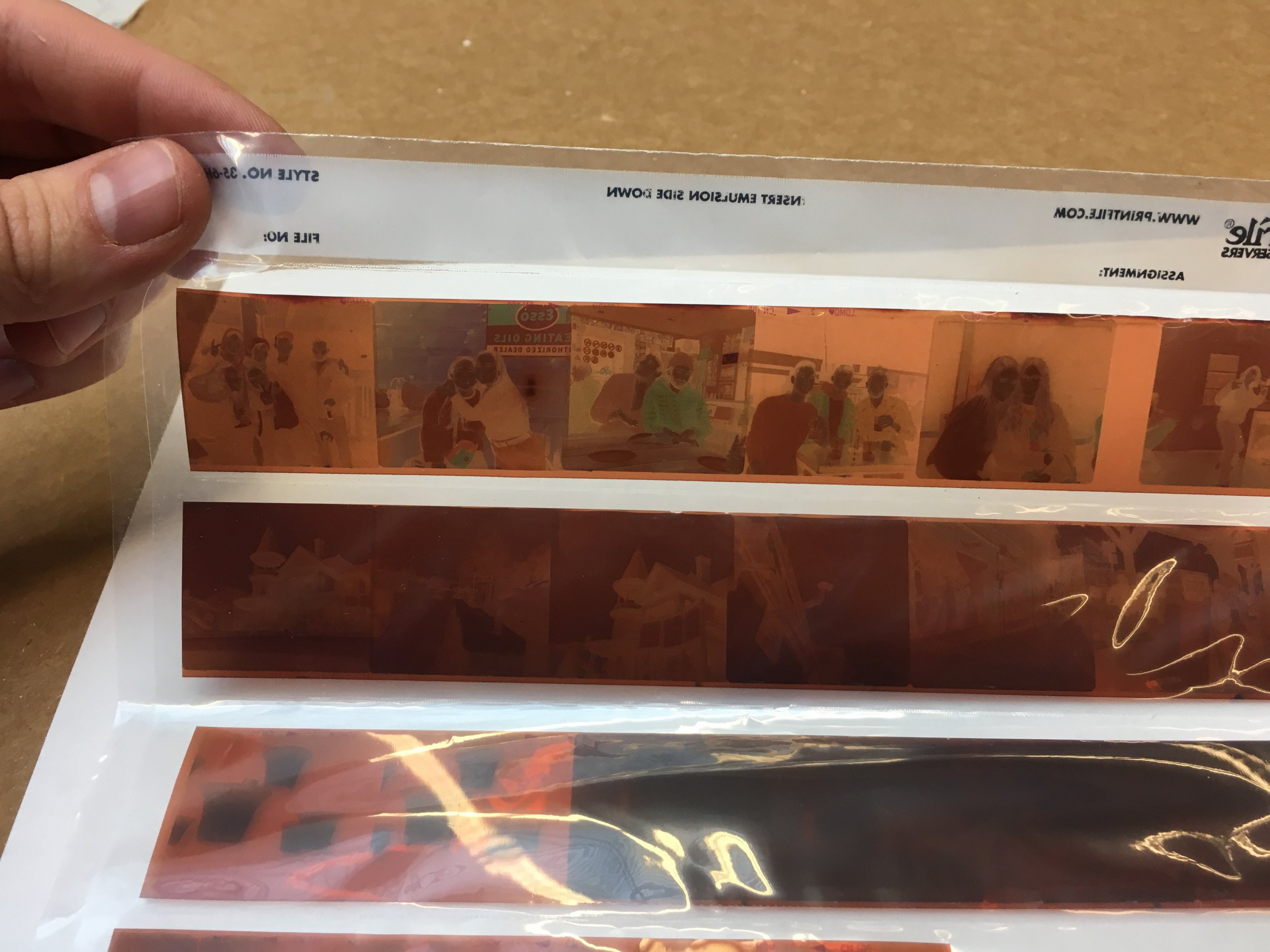

And here is what the negatives look like:
