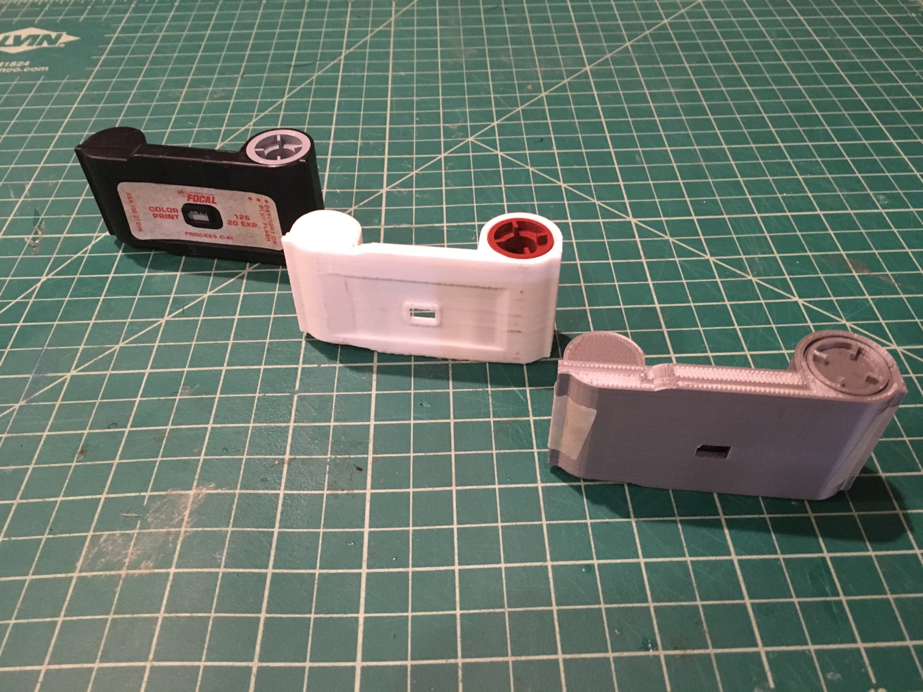

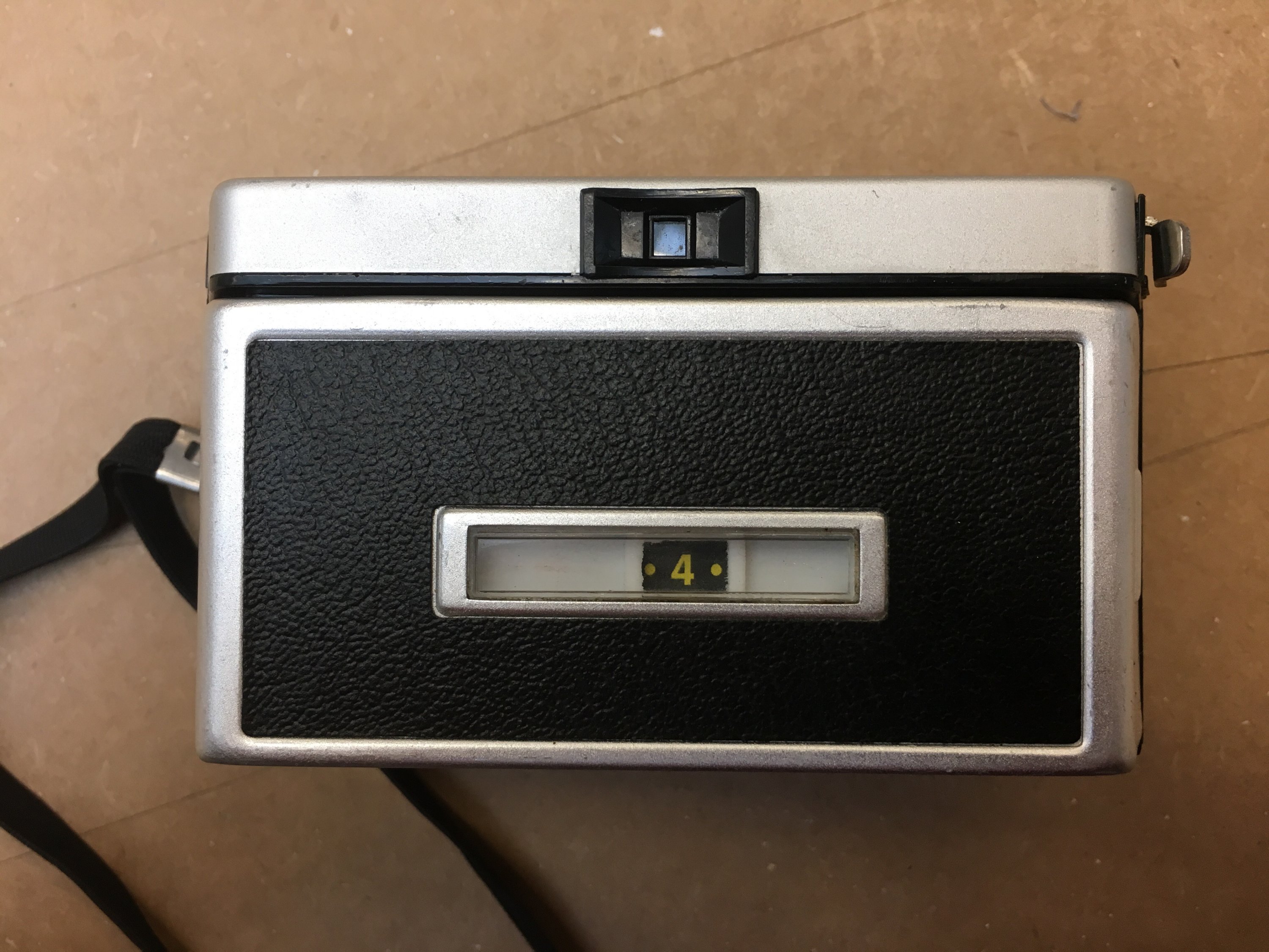

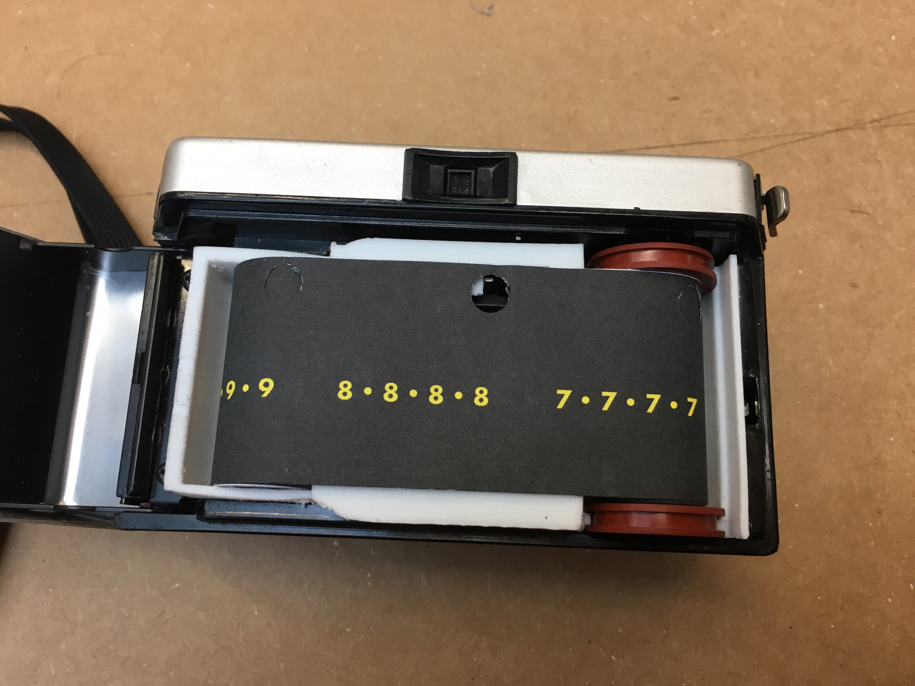

Edit: Here are some pictures to give some context--
Original Kodak cartridge on the left, mine on the right, the white color is only for this prototype.

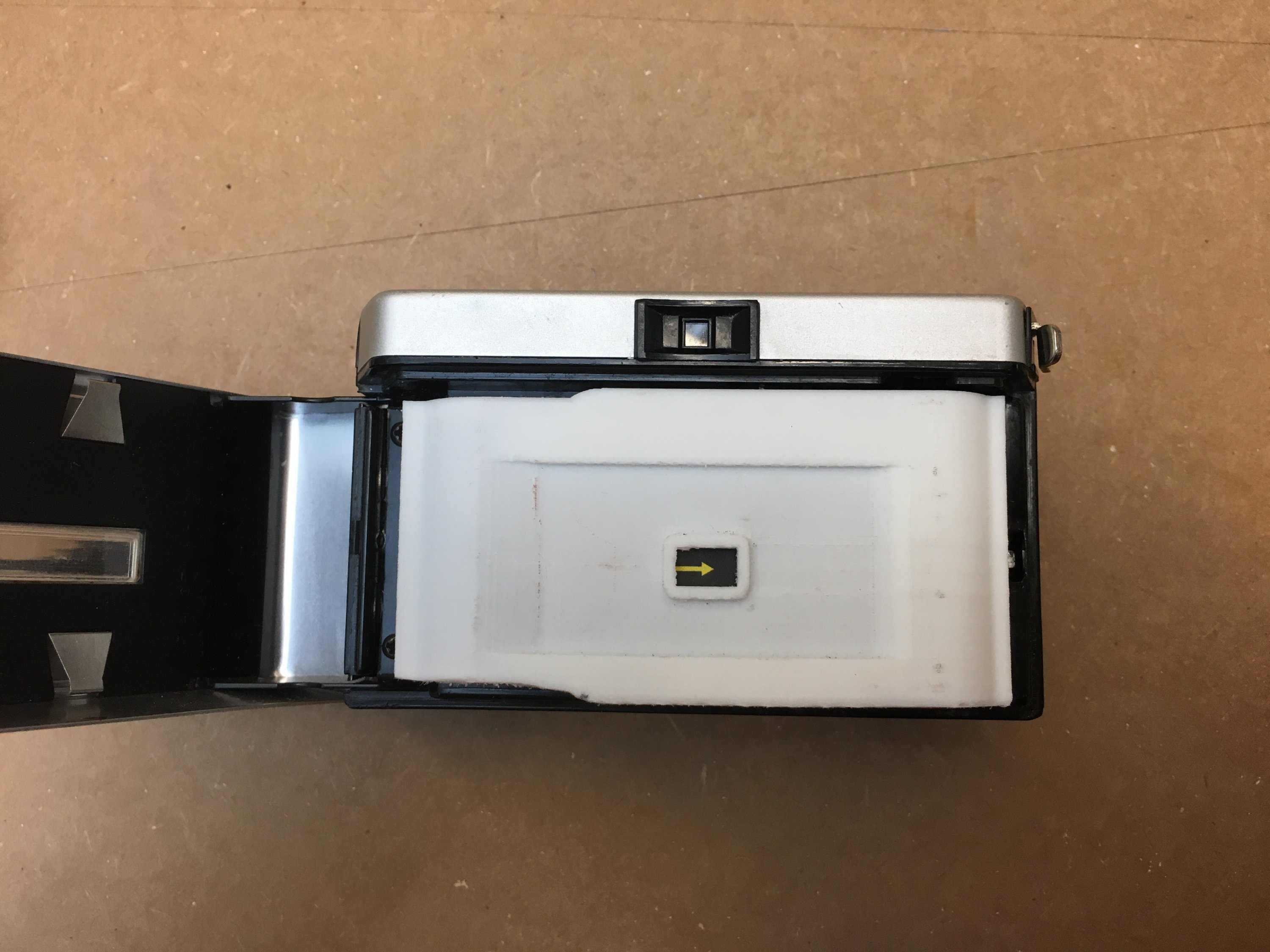

The cartridge in the camera with the back piece removed and custom backing paper in place. You can see the registration holes near the upper edge, they are about twice the size the should be at the moment as that is the only hole punch I have.
The backing paper advanced to the point that it has activated the film stop for frame "8".

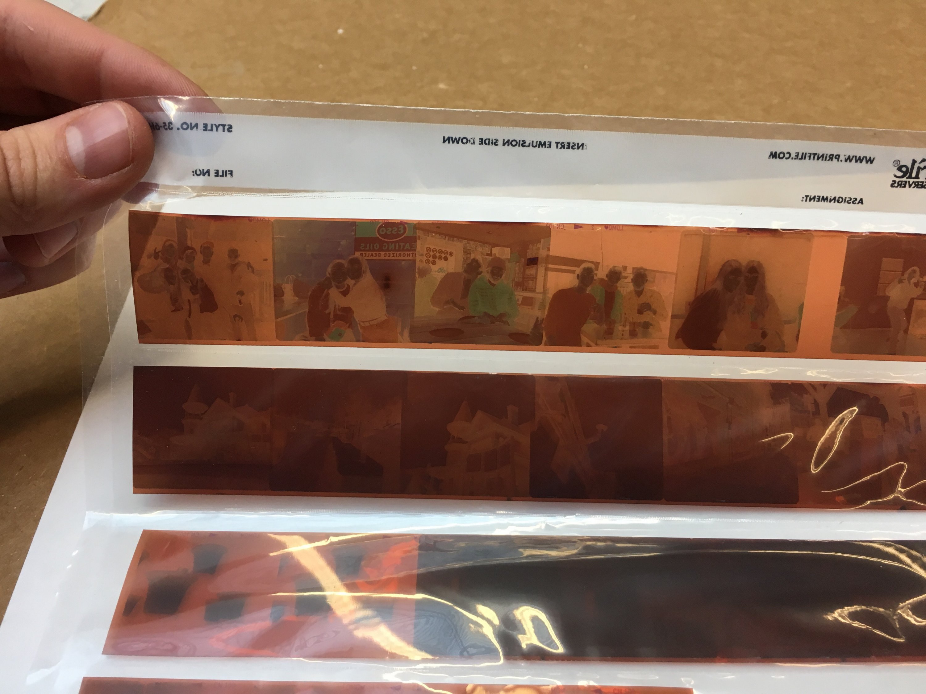

And here is what the negatives look like:
Interesting, and your indexing is better than mine was. It looks nice and like you put a lot of work into it.

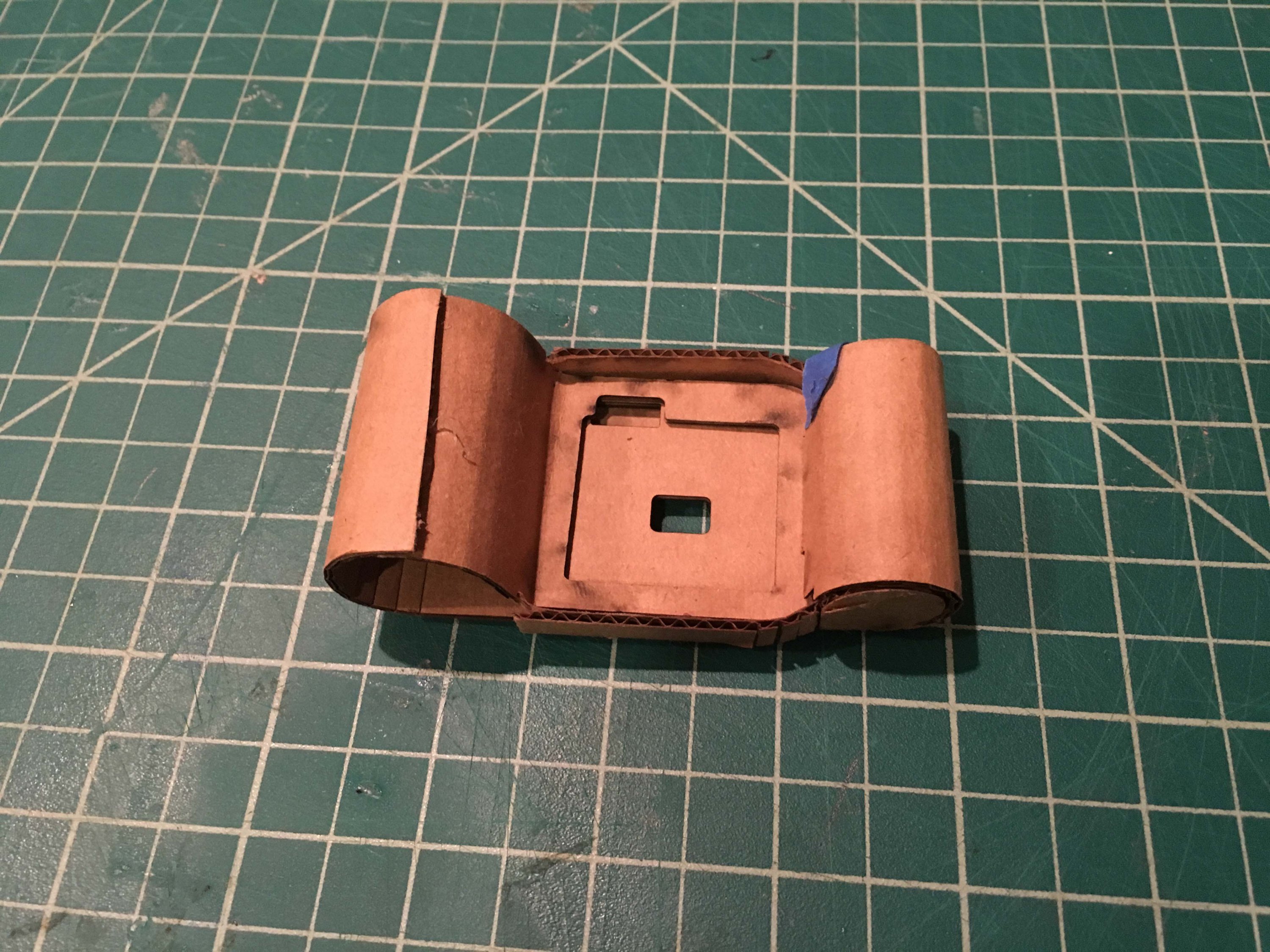

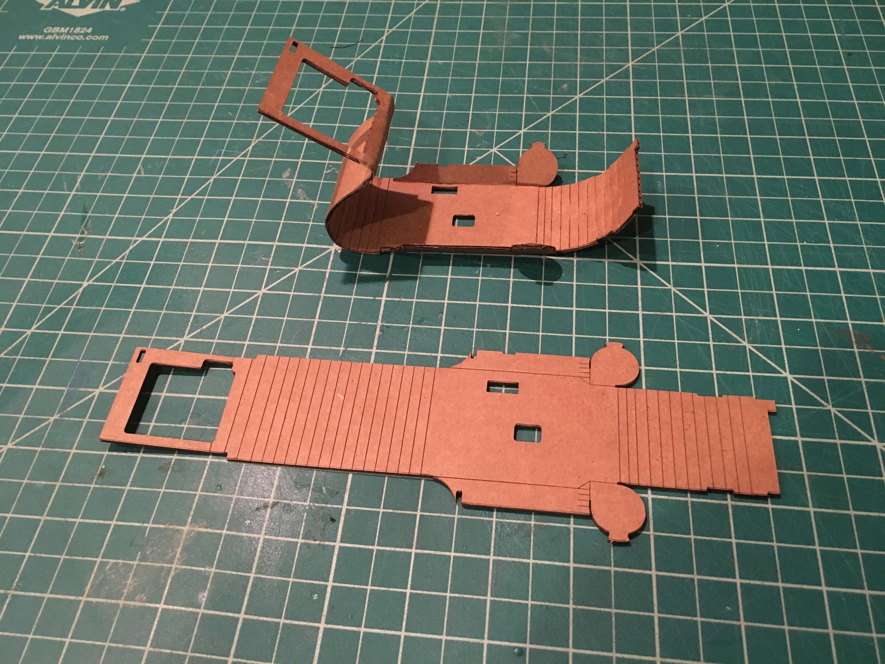

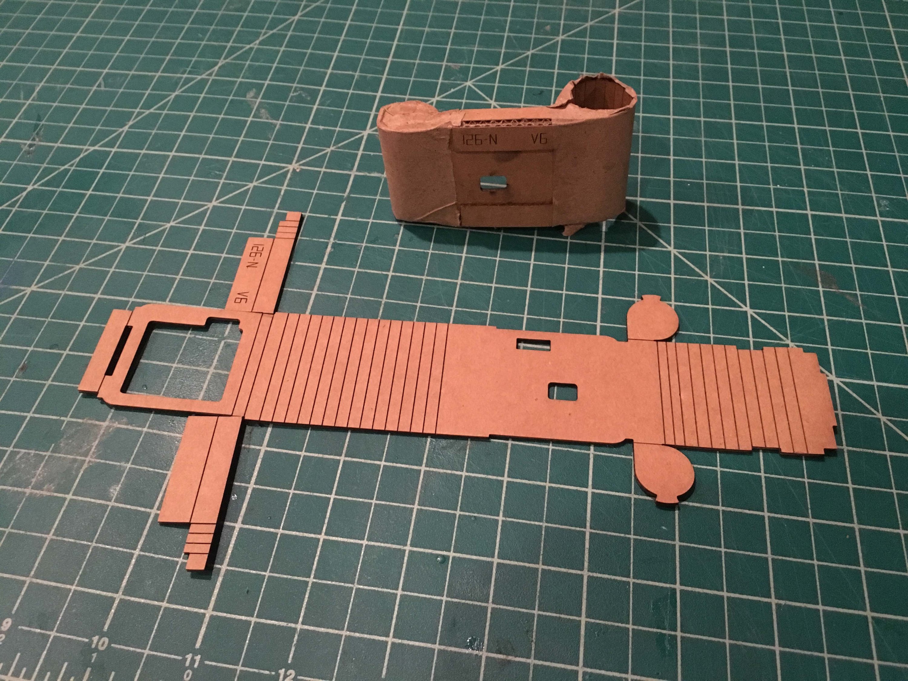

First I thought I would post some of my earlier cardboard prototypes as I think you all will find them interesting even though they are not relevant at the moment.

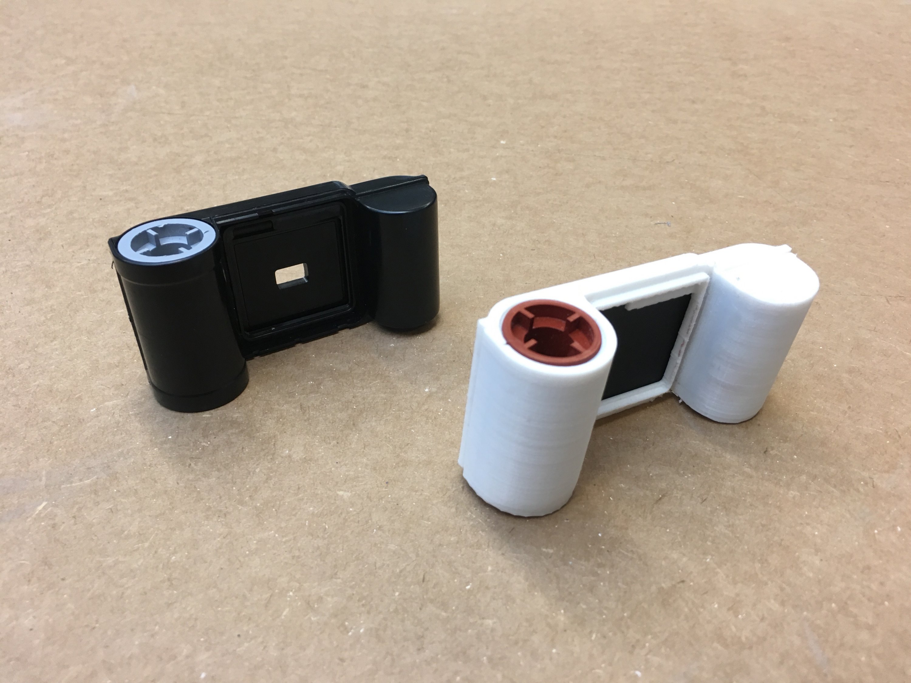

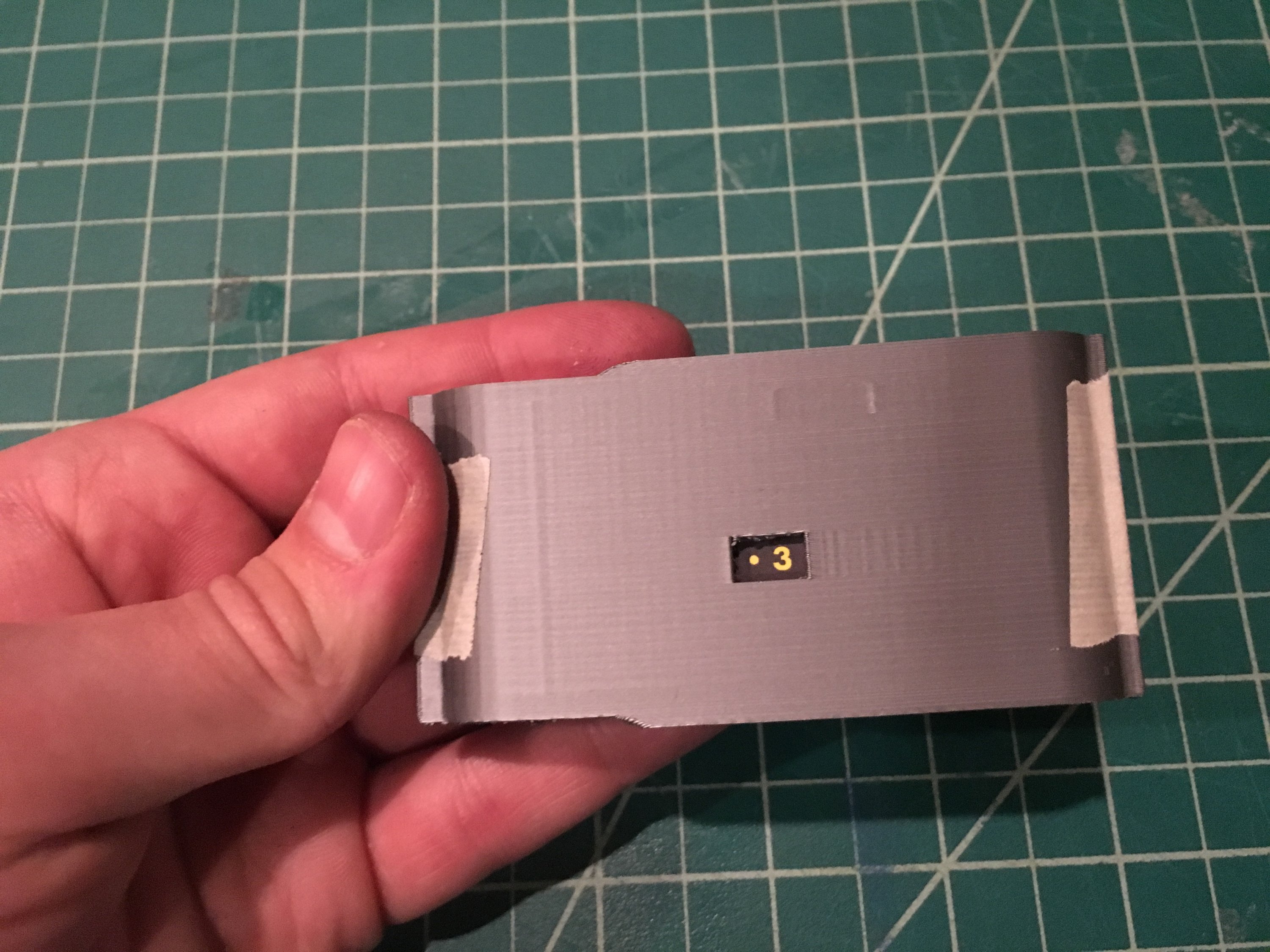

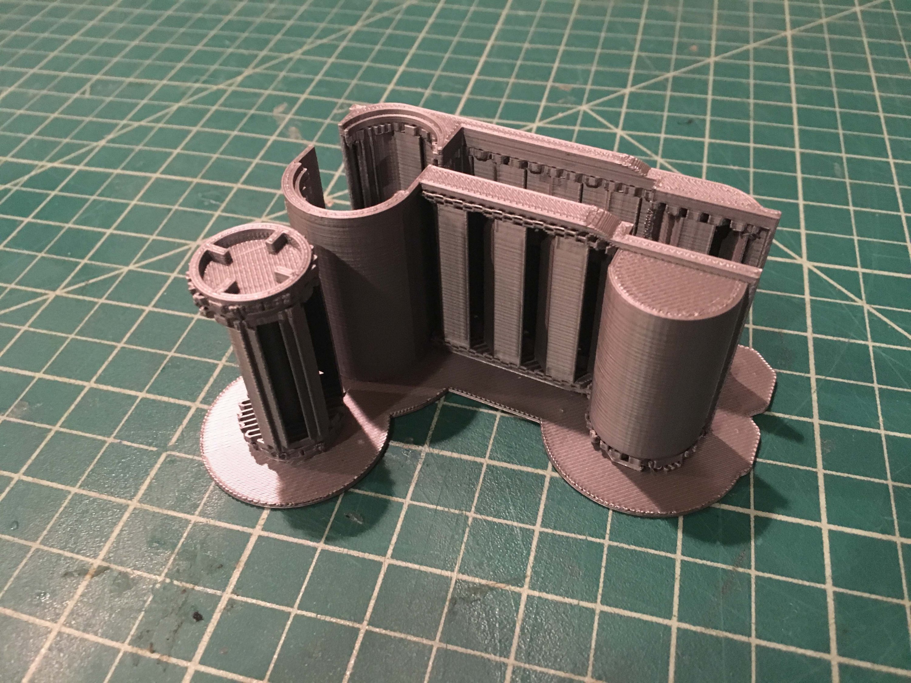

Now onto the current prototype - hot off the printer!
Below are an original cassette on the left, first print in the middle, and current print (now with printed spool as well) on the right. The next one will be printed with black filament, I promise!

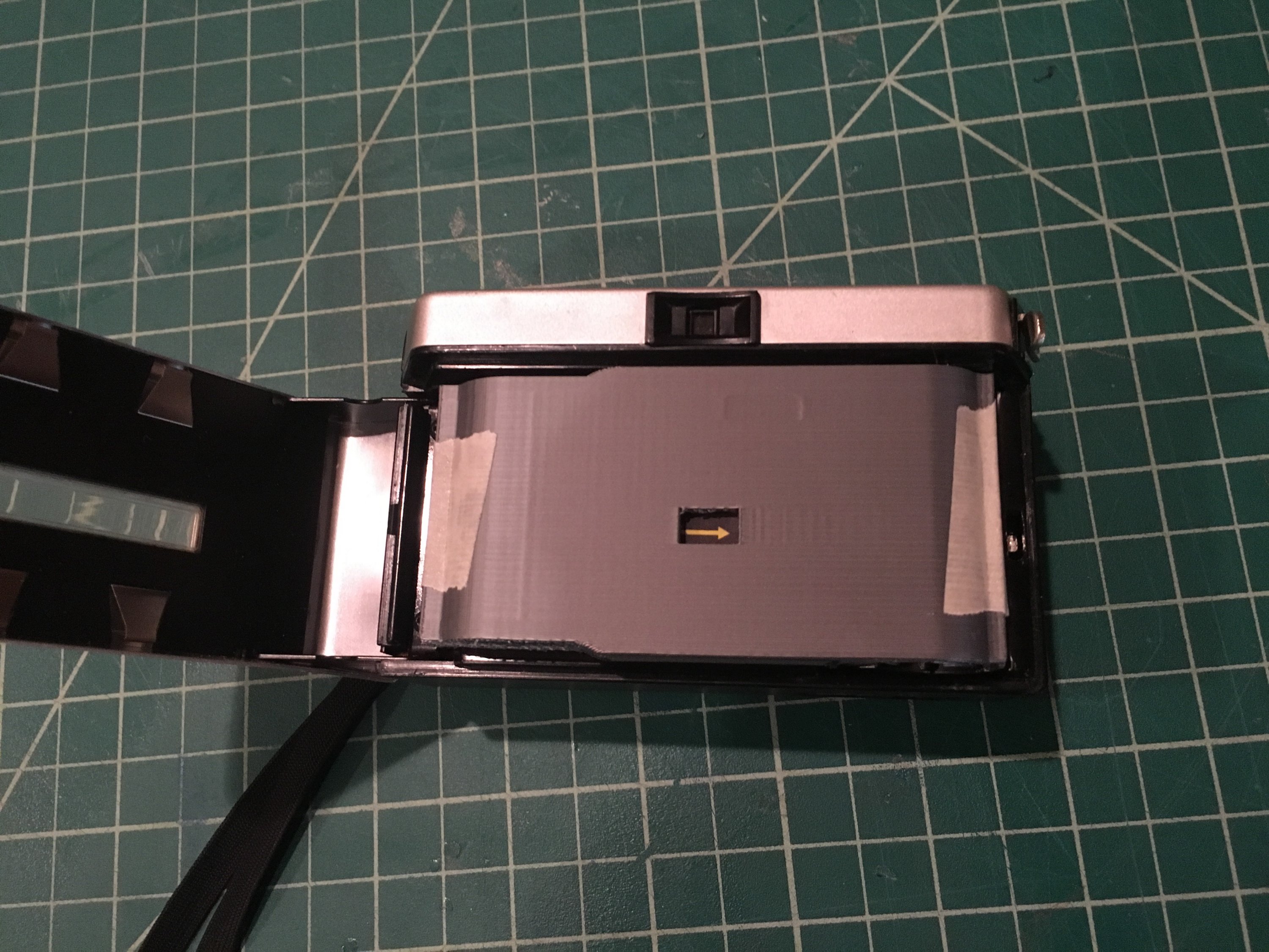

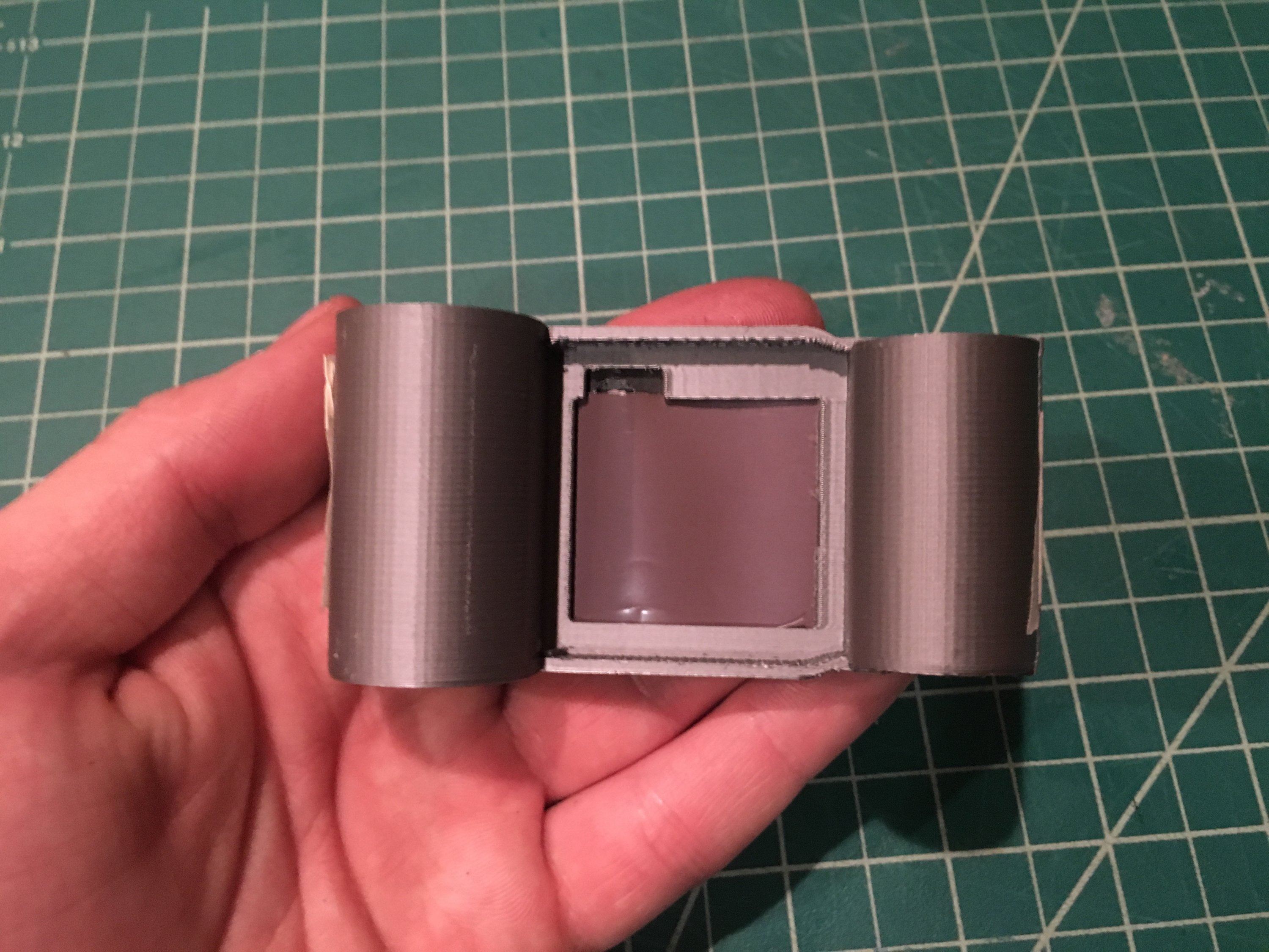

Here it is loaded with the 31mm film and custom backing paper:
And here it is in a Kodak Instamatic 104:
It advances nicely and the film stop seems to always work, however winding is a bit tight at times, will have to work on tolerances a bit but its going well!
