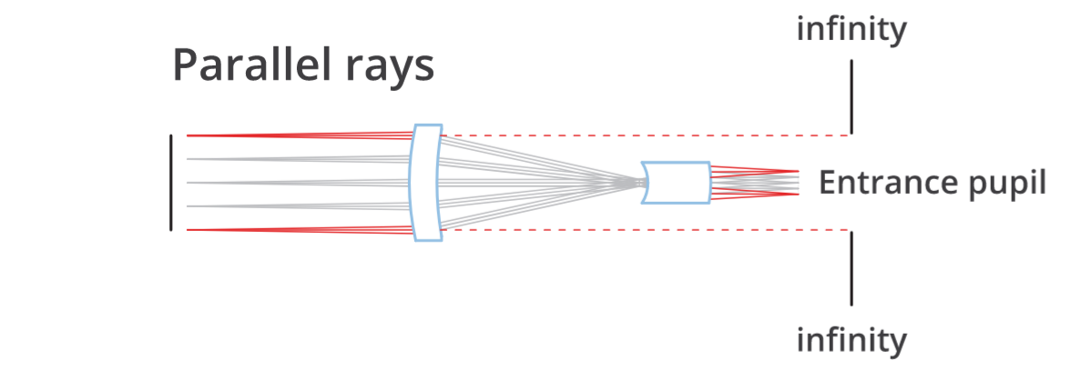

Back to the topic: A lens whose marginal ray angle is perpendicular to the sensor is called a telecentric lens. This type of design is important in astrometry (for example) and machine vision where the position of objects in the scene do not move when racking through focus.
The drawback, however, is the lens must be roughly the size of the sensor. Not as big an issue with modern sensors so I’m sure most dedicated lenses are or nearly are telecentric.
