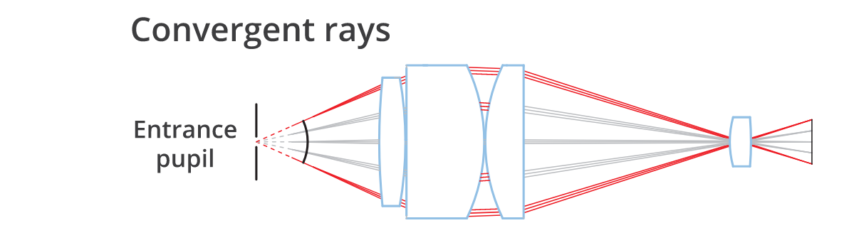

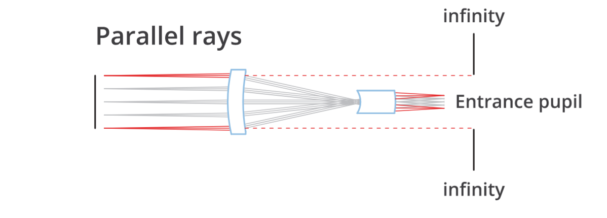

Seriously : this is a normal optic design :
A so called "telecentric" design is the following :
But this is more a theoretical describtion from simplified graphic!
Light wafes can't go such straight! :cry:
In any way such lens design is expensive - from my point a minority (8%:whistling: of wafes) march
staight through a cheap Nikon/Canon APS C AF lens (the rest is undisciplined and is more
stolling on the road to sensor):D!

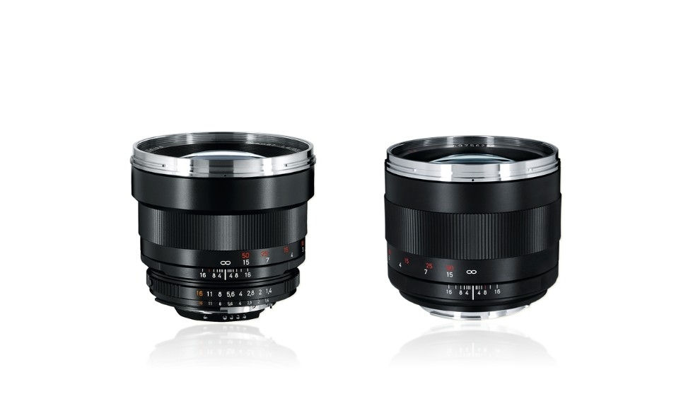

OK .....understand you just need best lens for film.......:pouty:hmm ?
Why not:D.....then you should buy best lens (but you should forget Nikon AF) :
...easy going = Zeiss Planar 85mm f 1.4 Nikon ZF !
with regards
PS : realy = best lens !!!:mad:!
