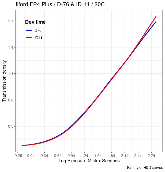

I hope it's okay to resume this thread. I have been working on a personal project, comparing ID-11 and D-76 for a number of films. I am still not done, but I have some preliminary data that I can share. So far, it looks like the two developers are very similar in how they render film speed and contrast, but their ultimate effect depends on the emulsion, to some extent.

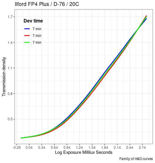

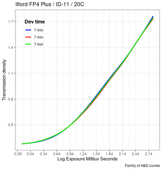

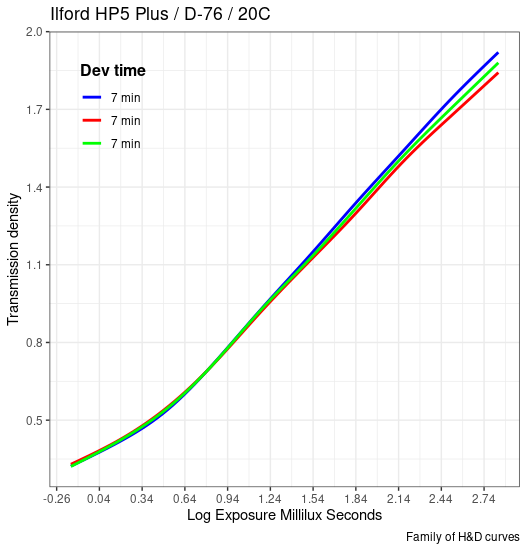

The data I am sharing today comes from a test, in which I exposed three samples of Ilford HP5+ and FP4+ in a sensitometer and developed in ID-11 and D-76 for 7 minutes at 20C in a Jobo 1520 tank in 250 ml of the developer, using rotary agitation (aiming the for "normal" CI of around 0.55-0.58). I then averaged the results to produce a single curve for each film, in each developer. I still don't have enough data to make any kind of conclusive statement, but, nevertheless, I think these results are interesting. I am gong to continue working on this, as time allows, and will share the results once they become available.
First, I want to include a few plots that show how the individual trials differ from one another. As you can see, there's reasonable consistency there.

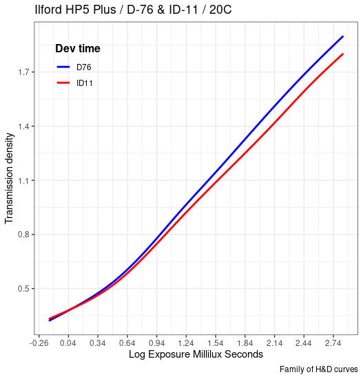

An here are the comparisons of the developers based on the averages from the individual samples. As you can see, FP4+ is virtually identical in both developers (CI of 0.57 and 0.58), while HP5+ does produce a slight difference in contrast (CI of 0.52 and 0.56).

I guess the buffers in the Kodak branded D76 has a slight effect on fast film? Would have not guessed that. Too bad you don't have a microscope and old AF test chart to measure resolution and grain size.
aparat
Sep 5, 2007
1,177
Saint Paul,
That's an interesting thought; you may be on to something here. I am also inclined to believe that the different chemical compositions of the two developers, however minor, are likely to be the cause of some of the results I am seeing. I have an early comparison for 400TX in D-76 and ID-11. It looks like D-76 produces more contrast (CI=0.72), but a fraction less speed. The ID-11 curves resemble those in XTOL-R. Having said that, I need more data to confirm this early result.
