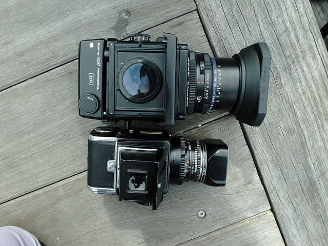

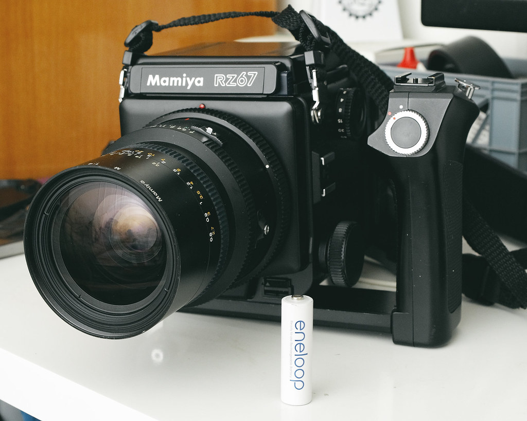

Here is the size of the RZ67 with the 65mm F4 L. With this setup, the camera is now front heavy. The kit now weights about 10lb.
8O2T0015 by vracing, on Flickr
You can shoot with two hands. And carrying it around neck if you have a strong neck. :smile: I had to use a separate shoulder bag just to carry the camera.

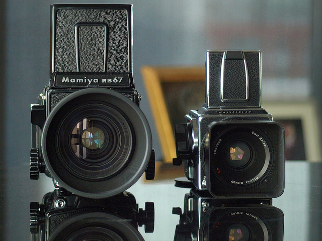

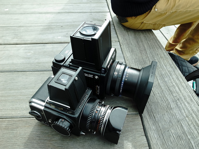

I found these this online this morning...
analoguey
Jul 24, 2013
1,103
Bangalore, I
Looks about right that.
The size difference will hold and RB/RZ lenses rarely weigh less than a kilo.
The best advise -and its been repeated here already - is to use it and figure out what works for you.
btw, also check Polaroid backs out - if you like them, you might prefer one camera system's representation over the other.
Neither system looks tiny or unobtrusive by most measures. (unless you're used to wildlife teles -then both are 'small' and 'light')
