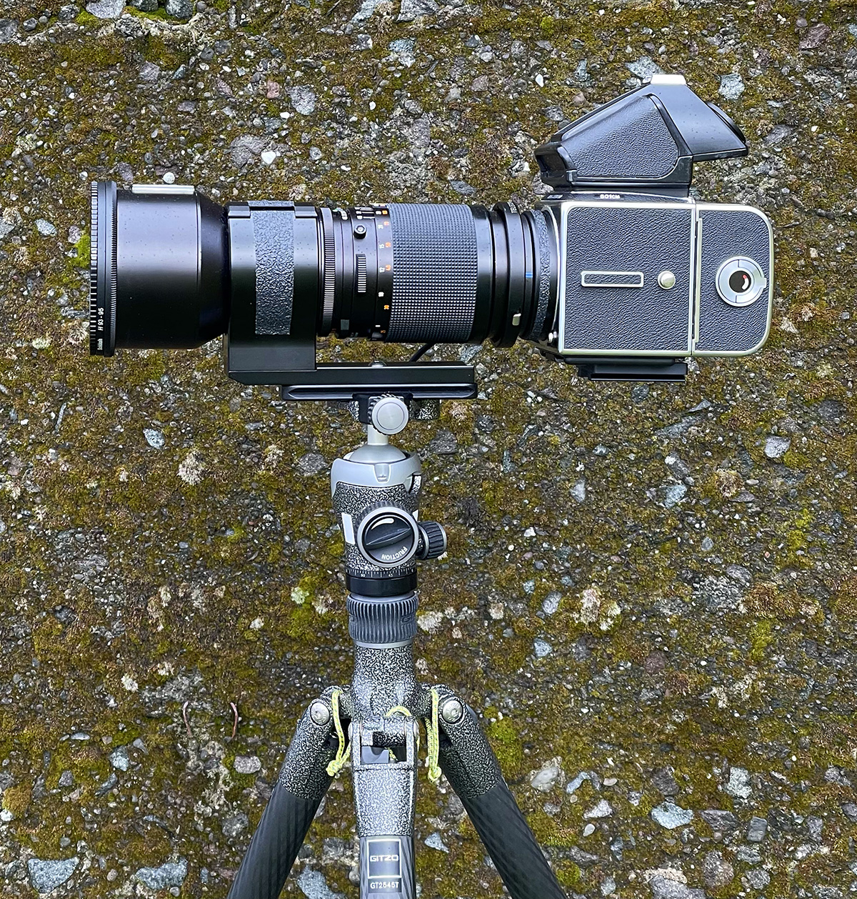

They are nearly impossible to find now, but when I first got my 350 CF 8-10 years ago, I found a source on eBay who made a clamp-on style collar with a tripod foot. It works and makes the lens far more usable, even with the 1.4XE on it.
I have been eyeing the 350 SA but have yet to pull the trigger even though there seem to be some better prices out there lately. If all I shot was B&W film, I think I could forgo the 10X price tag over the regular CF but I also use these lenses with an X2D.
The collar / foot does the job and even though it is extending the mount area out by quite a bit, tests wide open show no distorting of the image. I usually opt for the lighter Flexbody on it anyway to get some control over DOF for landscape use which is all that I use the lens for. It appears to sag a bit on the mount when under full load but again, there is little to no bending going on in actual use, at least that I can detect.
your collar much wider than mine, but in that it moves suspension point too far forward and a lot more load on the lens barrel where collar is. If an EL body were mounted on lens things would have been even worse. It works and you’re happy with it, that’s good. I am worried about distorting lens barrel with this single point attachment. I have no doubts Hasselblad messed this up completely. I will e looking at two point suspension solution. Already have front collar, just need to come up with a neat rail to get to camera plate, while allowing the rig to adjust for easy focus.
