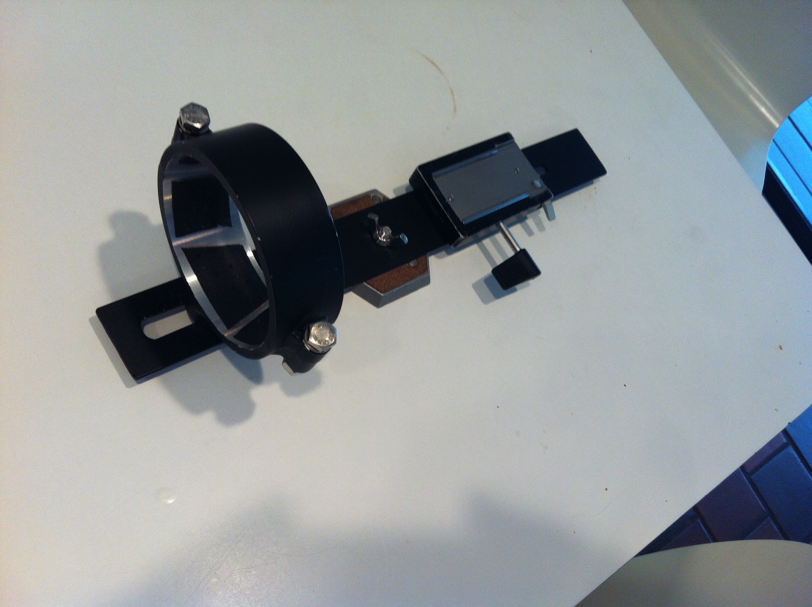

I designed my own custom collar for my 350 It is adjustable and can handle the 350 with a 2X It can center the weight over the tripod and is made of aluminium A machine shop made it for $60
I designed my own custom collar for my 350 It is adjustable and can handle the 350 with a 2X It can center the weight over the tripod and is made of aluminium A machine shop made it for $60 View attachment 358016
Problem is that lens changes its length with focus change. Looks like what you have will work, but my point is not that proper after market rig could not be made. I will never understand why Hasselblad missed that. 350 alone without tripod mount is a major engineering/design miscue.
Eventually I'll have my own version that will give me what I want, with smooth extension/contraction during focusing. And yes, given the bad barrel design, there is hardly another way but to have two point support of lens/camera with allowance to change length.
Note that I am discussing CF version, not C 350.
The photo doesn’t show it but the collar is tapered to match the lens and has a bolt that slides with the lens and can be tightened after focusing as can the quick Hasselblad connector. The top and bottom of the collar are separate and connect with the bolts as shown. The middle connector is the connector to the tripod and doesn’t touch the lens. The lens is a 350 TeleTessar. It does work. I’ve used it with the lens plus the Mutar 2x as well. Because of the lens taper it was designed for that specific lens
Thanks Steven. Here is another view The camera connector can move independent of the collar and also be tightened down to the bar.
