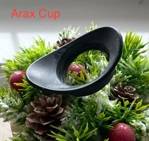

with 45 I only have the old style NC2, which is rather compact, lighter and really like it.
I use the NC2 also, and you are right, it is bright and compact. Does anyone know of a source for the eyecup? Is it a size that might be common with some 35mm camera or one of the Soviet med. format prisms? Thanks!
Hassasin
Hassasin
Feb 23, 2023
1,330
Hassasstan
I will check that Arax version because I think that will actually fit. Will get back on that.
Hassasin
Hassasin
Feb 23, 2023
1,330
Hassasstan
@Kodachromeguy The Arax eye cup fits NC-2 perfectly. I believe all older Hasselblad finders will be in same boat. What this cup does NOT fit properly is the PME90 & PME45, the late metered prism finders.
Above: Original set up, 2-piece with eye cup removed
Above: Arax cup installed with original rubber ring intact, Arax cup is a bit tighter and does not swivel around too easily, but that may be due to new rubber.
