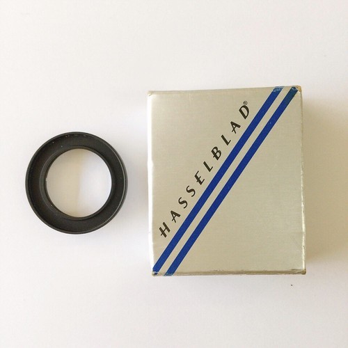

Hi, came across this old thread as I am currently looking for a diopter for my PME5 (with my 503CX). My eyesight is -1.5 and would prefer not to wear glasses when shooting with the PME5. I have not been successful identifying the correct product code for the diopter lens.
Would someone be kind enough to help me with which Hasselblad product code is for the diopter -1.5 on PME5? Many thanks.
I tried to figure it out for you, but could not. I did find this in the PME5 instruction manual
eBay seems to have a -2
If the lens has no marked corrective optical power it is usually the standard-eyepiece even if it has some actual optical power to bring the entire finder to its default. They often end up stored in boxes for corrective eyepieces when the previous owner mounted it on his camera, buyers beware! Happened twice to me when buying on the net.
Yes that’s what I have noticing as well. It’s tricky to buy the right diopter strength due to low volume being produced and unable to test easily.
