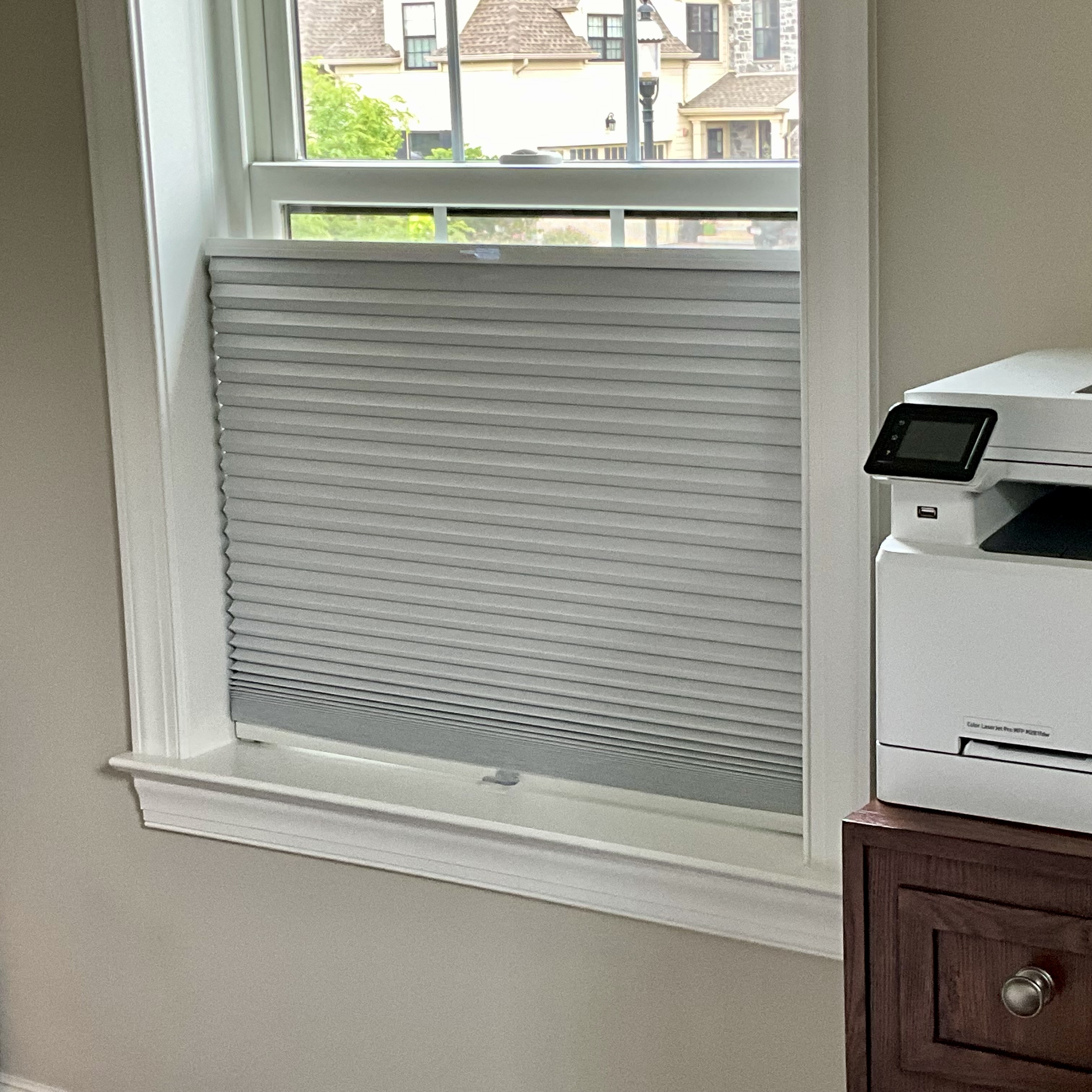

I have several prisms, and none have any significant color difference to the scene. This is a wall with neutral gray paint, white trim and window shade. The viewfinder image is from a PM45.
Not meant to be scientific, but you get the idea.
