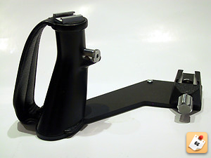

The hand grip accessory for the SL66 is wonderfully ergonomic IMHO, very comfortable to hold, makes the camera with either the 80 or 150 lenses very well-balanced, and makes a world of difference vs using it handheld by itself. Makes focusing and firing off the shutter (integrated into the handle) easy as pie. The SL66 foot slides perfectly into the holder too.
