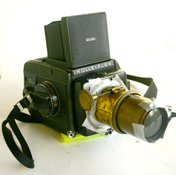

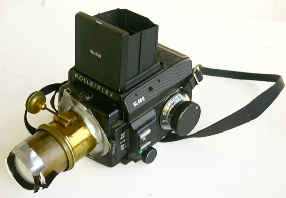

Dan: VERY good arguements here...
I have both systems - never ever use the hasselblad.... (I think it is much harder to work with - and I love how easy it is to focus the SL.. even hand held!)
So not so many words from me - just an image showing a very modern lens arrangement... :wink: and two resusts - one with a meniscus type landscape lens - the other using a small Busch Ki Petzval lens...

See now, this is cool! The breadth of palette and possibilities this body opens up is truly exciting! Sometimes an 80mm ƒ2.8 Planar and other times half of a Goerz Berlin Binocular or perhaps a Petval, or maybe a...
