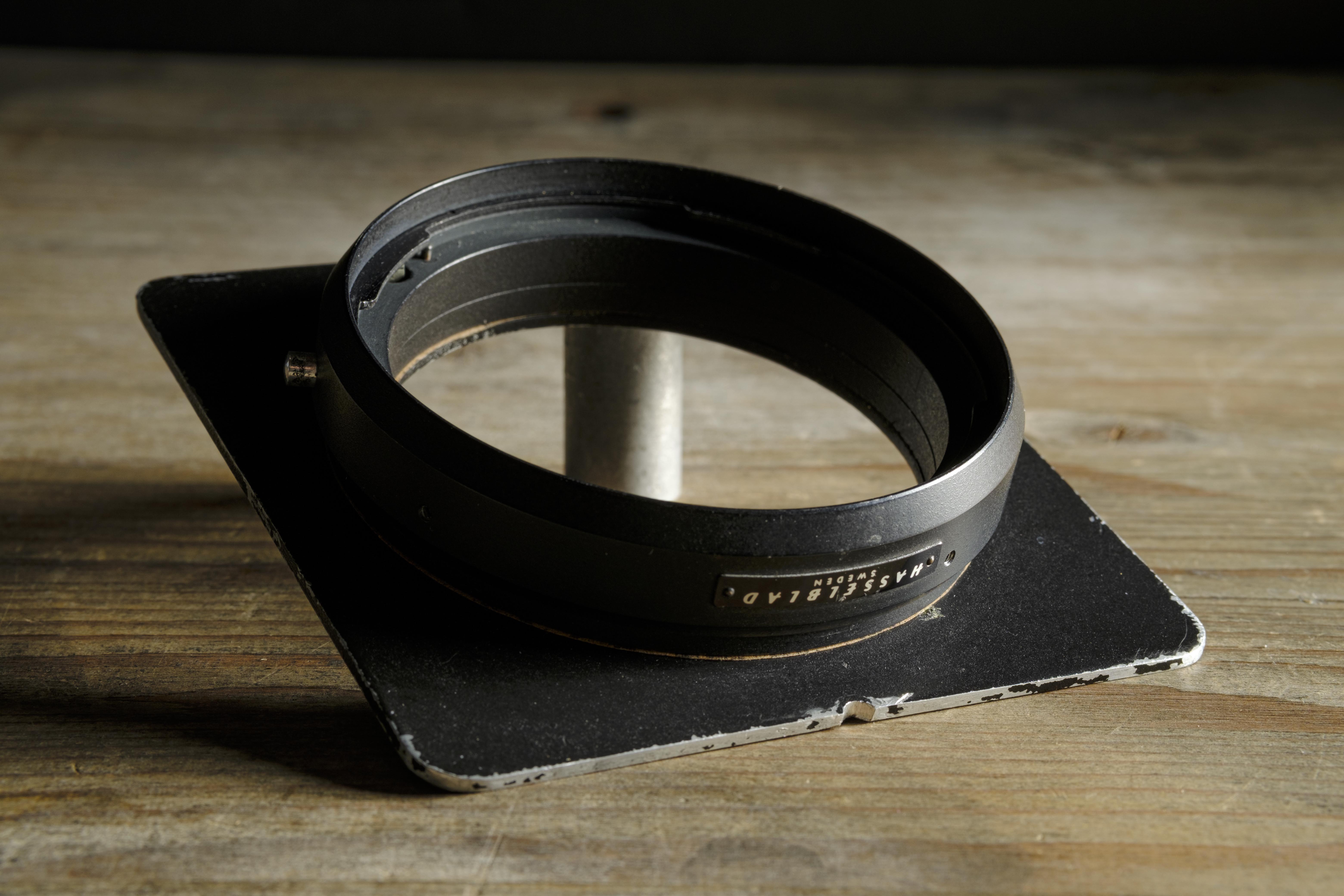

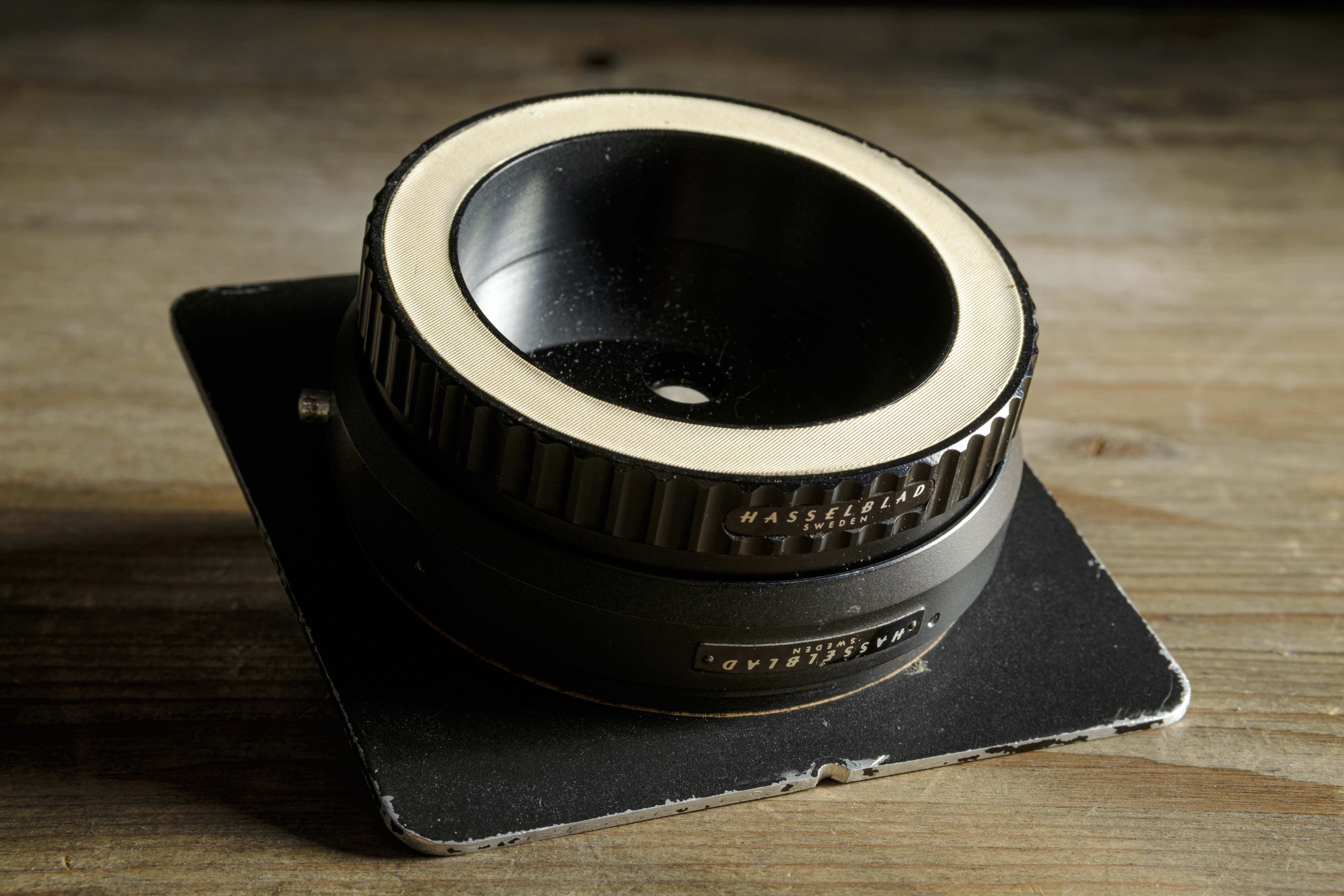

If you search for Hasselblad #40177, with patience you can find one affordable.
What is interesting too is that with this flange, a lot of Hasselblad accessories can be atteached on other (LF-) camera's.
I used it to mount the Hasselblad Parallel Mirror system on my Linhof when making reproductions on 4"x5" (and occasionally 13x18 cm).
The lens flange was mounted on a Linhof Technika lens board.
