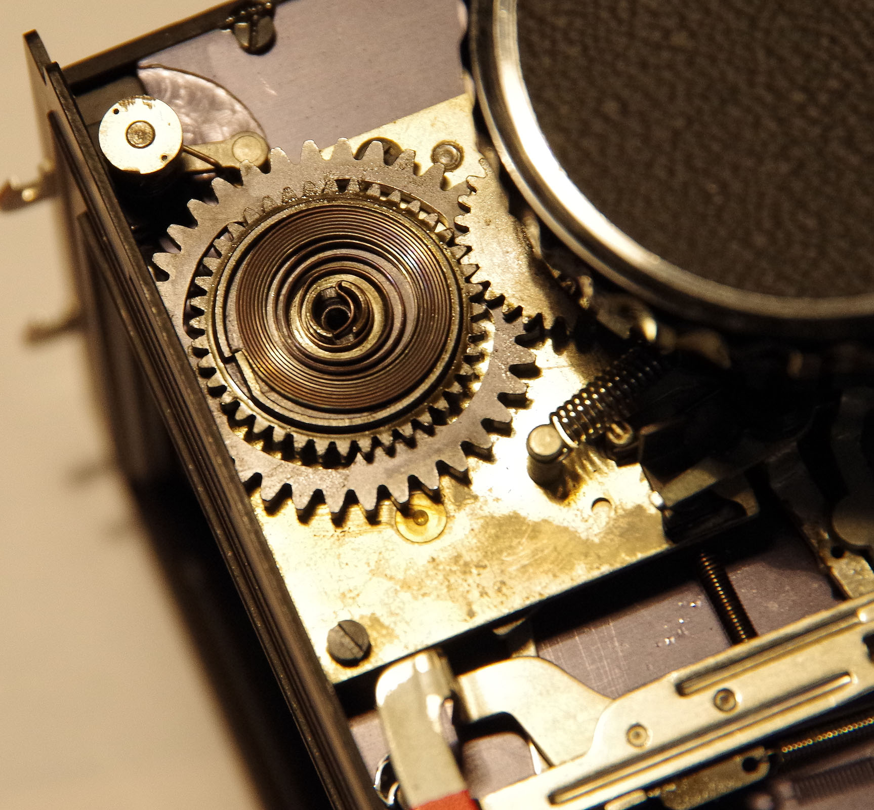

Hi everyone,
Another mishap with the Hasselblad.
There is some issue with the auxiliary shutter of my 500cm, the lower flap does not close tightly. I had done this repair many years ago, and decided to give it another go this time. I remembered the auxiliary shutter was controlled by a spring inside a gear, on the top left of the camera, and it might just need a clean and rewind (please see photos). Unfortunately for me, when I opened the cover, the spring jumped out right away, and I did not get the chance to take the photos of how it was arranged.
Everything is clean now however I'm unsure how and which direction I should rewind the spring inside the gear. If anyone has tried this before, or have a photo of the arrangement of the spring, I'd deeply appreciate it.
Thank you.

Oh lord, the dreaded Hasselblad coiled spring. Before I answer your question, please show me a photo of the damper ring. If you do not have one, then I will tell you to send it to Odess. I'm not being snooty. I just don't want to waste both our time on a bad repair job. If you decide to put that spring back in, good luck. The chances are extremely high that you will destroy it in the process. At any rate whatever you do, do NOT allow the camera works to cycle backwards, even a little, or you will destroy another spring you cant even see, and the camera will be a paperweiight. Please, may I see a photo of your damper ring that is supposed to sit on top of that gear? Thank you.

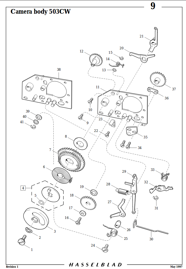

Since I don't know the serial number of your camera I will ask you if you have a part number 3 in the his diagram. If you don't then send the camera to odess.

I hope the OP and others will forgive my percieved tone in answering him. I could write a book about repairing that camera, and the spring in question is the one camera repair of all that gives me nightmares. And for all I could tell him about the repair he is undertaking, it would be for naught. When the lower door especially is giving the problem described, then the camera has reached what I use to call stage 3 (of 3). It is time for a professional. And one of Odess' caliber. As for rewinding that spring at home, the chances are extremely high that the spring will be destroyed, and parts availability is extremely short to nil. I cannot stress strongly enough to send the camera and parts to a professional. Besides, there are other repairs that need being done. as a matter of course.

Hi Yashima, I wound this spring on my c/m, I used Y-shaped diy tool to hold the body of spring down. Hope this helps.
Cheers.

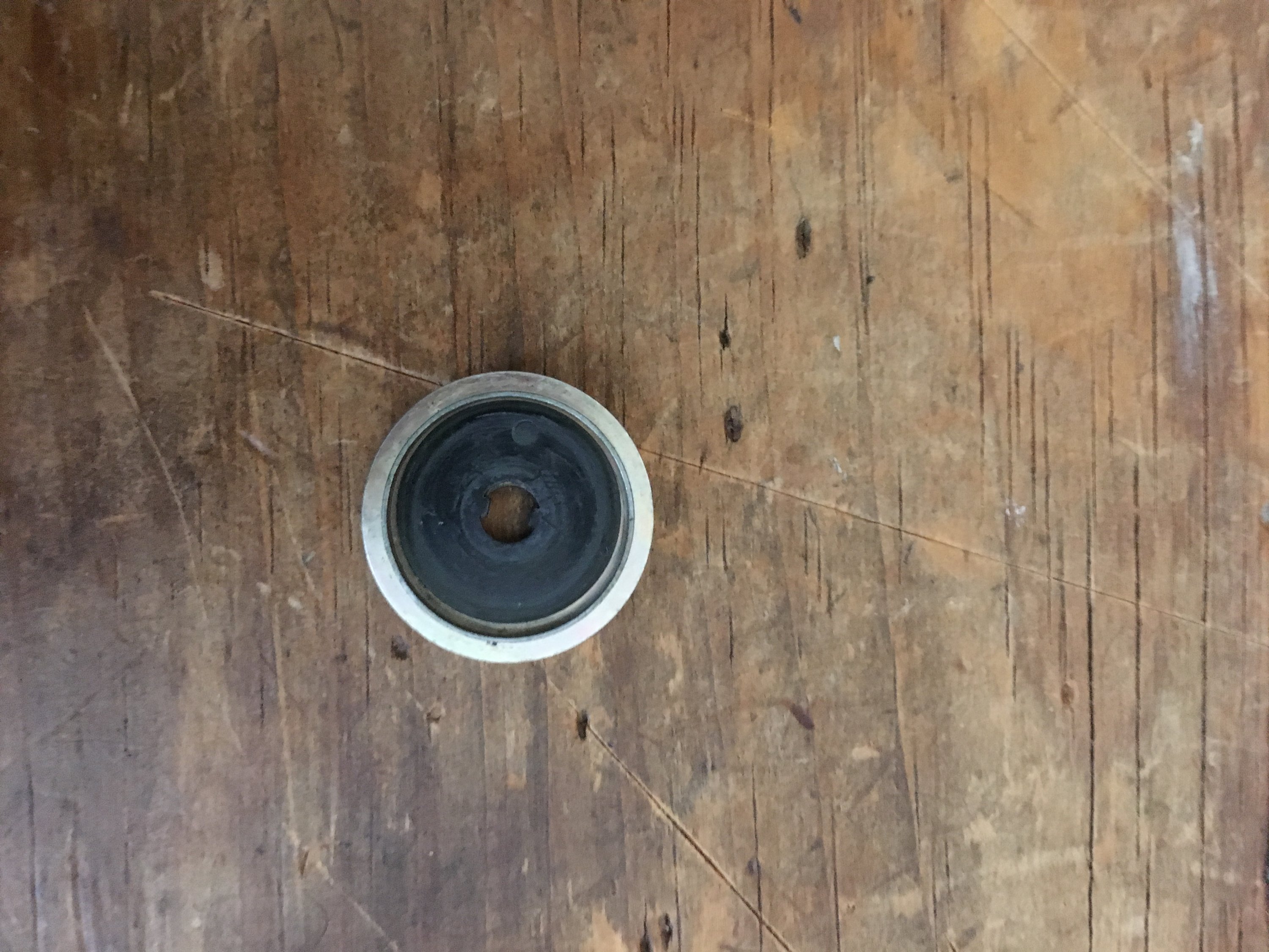

Hello sissysphoto, no problem at all. I appreciate all the warning. Here is a photo of the damper ring. Any advice? Thank you.
Hello Phass, thank you! Very very neat work! Any advice how I should proceed with winding the spring? And when do I know it has been tighten enough?

Its been 3 years since my last Hasselblad repair. When you buy the spring as a new or NOS part, it comes coiled inside a little washer sort of doughnut, prewound. And you use (i fabricated) a little push plunger to push it into position. Naturally since the spring was factory wound, it simply caught the outer spring end at the proper place in the outer gap and that was it.
As further words of discouragement for doing this repair, what are you going to do about the 3 foam pads behind the mirror? They surely need replacing. And without them your focus accuracy is terrible. Then if you do replace them, you've still lost your 71.40mm chassis length. So once again, focus accuracy is off.
Even if you do get the spring back in, your problem will come back sooner than later. I've been through all this, believe me. I practically locked myself in my little house like a prisoner or a hermit for 2 years with about 20 Hasselblads and studied them. One thing I learned. Odess has access to parts and we do not. And the chances are extremely high you will destroy that spring. What I would do if I were you would be to put all the screws in their proper screw holes 2 or 3 turns so a repairman will have them. Then ship the camera disassembled to him. Send him a neat well-ordered shipment and he will probably not charge you for trying to forensically repair your repair.
A properly serviced Hasselblad is a dream. An improperly serviced or neglected one is a piece of junk. You're better off with a Brownie.

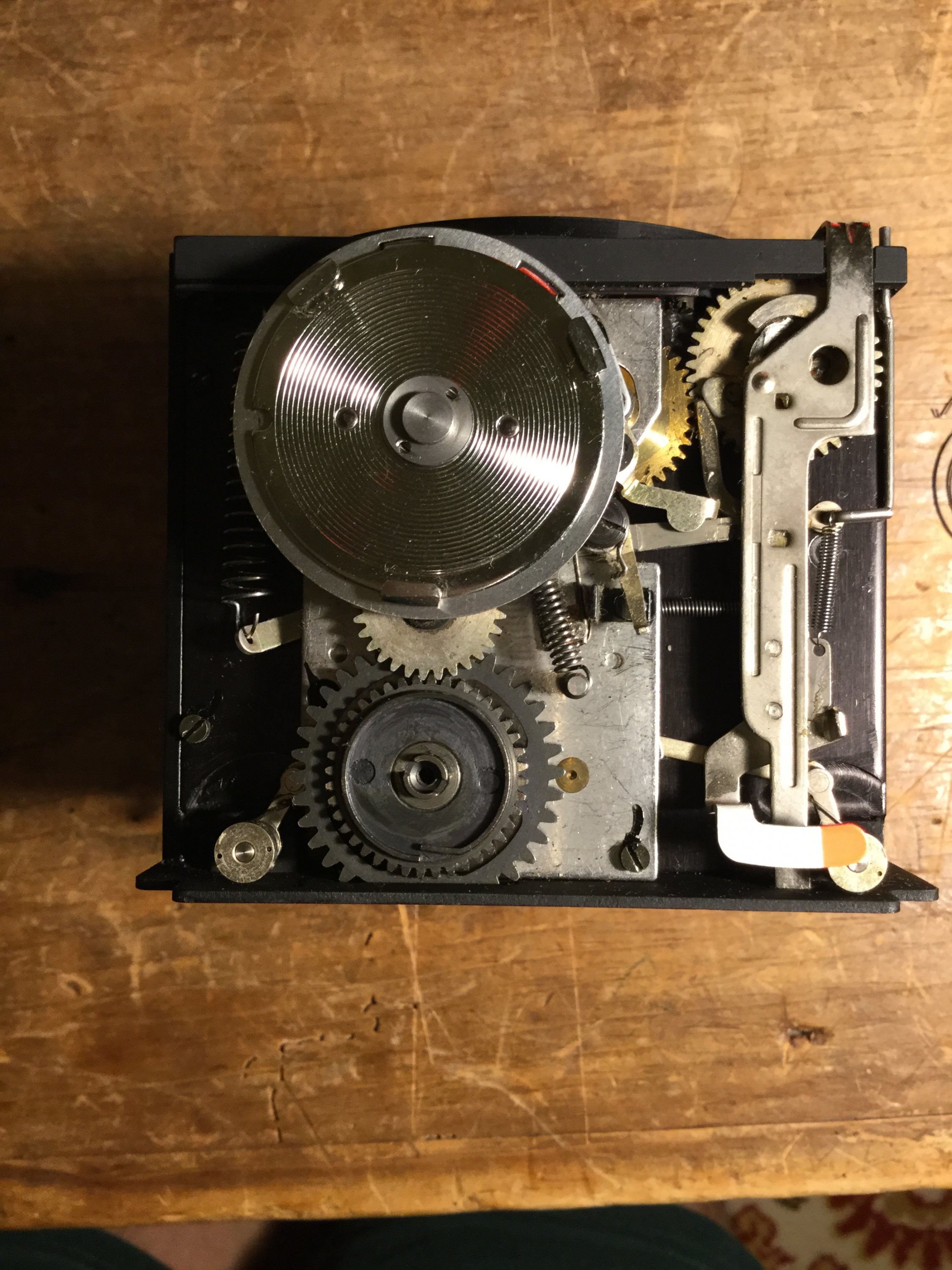

Hi everyone,
I managed to rewind the spring successfully and put everything back together again. Unfortunately the problem is not resolved, and I realised the problem might not be this spring.
@phass:
The problem with my camera is: The upper door close fully with good tension, however the lower door does not close fully (even though when you push it, there's good tension behind). I think it has something to do with what the gap between the two door that you talked about, rather than the spring. When I turn the knob (on top of the gear for the spring), both door moves together however there's always 1cm gap between them. And when the upper close close, the lower door stops, 1cm away from being fully close. When I turn the knob further, the lower would close.
I tried to hold the small shiny disc you described to adjust the door, however there seems quite a lot of resistant doing so and I dont want to force it. Any further advice for me please?
For anyone who is interested in the original problem, if your auxiliary shutters are jammed or sluggish and without good tension, I encourage to attempt rewind the spring. It can be quite fiddly however not overly technical to do. I did it before reading Phass method (put the outer hook in place first), and I put the central hook in place first. I used two fingers on one hand to hold part of the spring that has been winded into the gear, and use the other hand to wind the outer hook around it. Its quite fiddly however there's not many things that can go wrong. If it jumps out you can just try again. It took me a few tries. Good luck.

Way back when. I was repairing cameras, the shop I worked in wasn't specialized so I had the chance to work on only a few Hasselblads
but the method phass used is the same we used in the shop. Care and patience helps.
Regarding the shutter, I've seen several that the blades had actually slipped on their axle and had to be repositioned. Obviously
not an approved fix.

Actually the upper door is notorious for being moved on it's axle during a jam and attempt to wind. Repositioning that door is perfectly described in the repair manual. As for the earlier reference to repositioning the lower door, I disagree. He stated he did that because of his spring pressure being lowered because the doors snapped too strongly. Before lowering the spring taughtness, he should have packed the hub with grease, which would have reduced the strong action somewhat. The original 1957 C had a piston and cylinder providing the dampening. The last models of CM's had a sort of washer with a nylon type of insert to provide dampening. The original piston was the smoothest most vibration free model but required routine maintenance. We need to bear in ming that there are a lot of bodies out there that have had their dampers removed by unknowing repairmen. Sooner or later those cameras rear doors will crack at their axle.

Congrats on the spring installation. I'm speaking from 3 year old memory but I believe the upper door might have moved in it's axle, which makes it appear the lower door is out of position. Moore often than not, this is the case. As for moving the upper door on it's axle, hold the silver round thing on the end with pliers and spread the fingers out on your right hand up near the axle and push and pray. Keep tinkering till you're happy. Youre learning.

Congrats on your progress. As other members metioned you may need to move lover door and start from checking that this coil spring was not drowned in grease that may restrict it's movement. I agree that joints that move lover door may need some liquid oil. Good luck.
