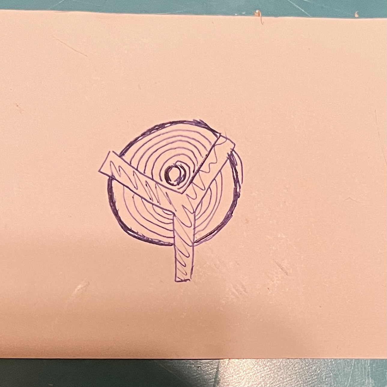

Hi, thank you for the information phass and others. I performed these repairs successfully as described.
Three questions to anyone who knows:
  • Is there any objective way of telling whether the spring is overwound? Does it make a difference? I can see the mirror bounce off the top pad when I fire the shutter now, and I feel a bump when the camera fires, but don't want to mess around with the insides more than necessary.
  • Can someone post a picture of the spring winding tool phass described? The spring is indeed hard to keep down as you wind it but I can't imagine how a "Y shaped piece of flexible plastic" would aid.
  • Where is the documentation that describes how to make focus adjustments? It must be somewhere in the repair manual but I haven't found it.
Thanks

I probably should put quotes around the word tool. I used it to hold spring down when I was closing the spring chamber. This is a schema of that “tool”
