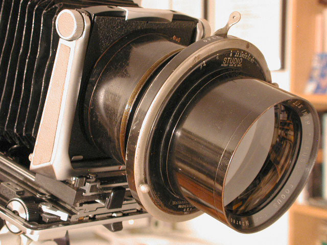

But a hole CAN be elegant. Perfect radius, perfectly perpendicular sides, no over cutting or tool marks anywhere, and no vise marks on the lensboard. Those were some problems I encountered when using other machine shops.
However, my comment about SKG work being elegant was in reference to their custom projects, like mounting large barrel lenses on small lensboards, etc. While I have no means to compare this custom work to other machine shops, I believe the custom work SKG did for me was truly elegant.
Absolutely. Does it get any prettier than this?--

I've used them a few times. My feeling was that after Steve passed, responsiveness went down and prices considerably up. That said, it's outstanding to have a place available to do the custom work, as shown in David's picture. It's silly, though, to use them for putting a hole in a regular lensboard. I have about 10 lensboards for my Sinar, some factory made, some with a rabbit on the back, and some I used a hole saw on. All of them perform identically. Paying for a piece that needs high level machining is one thing. Paying their prices for putting a hole through a thin, flat piece of aluminum indicates that one has too much money.
