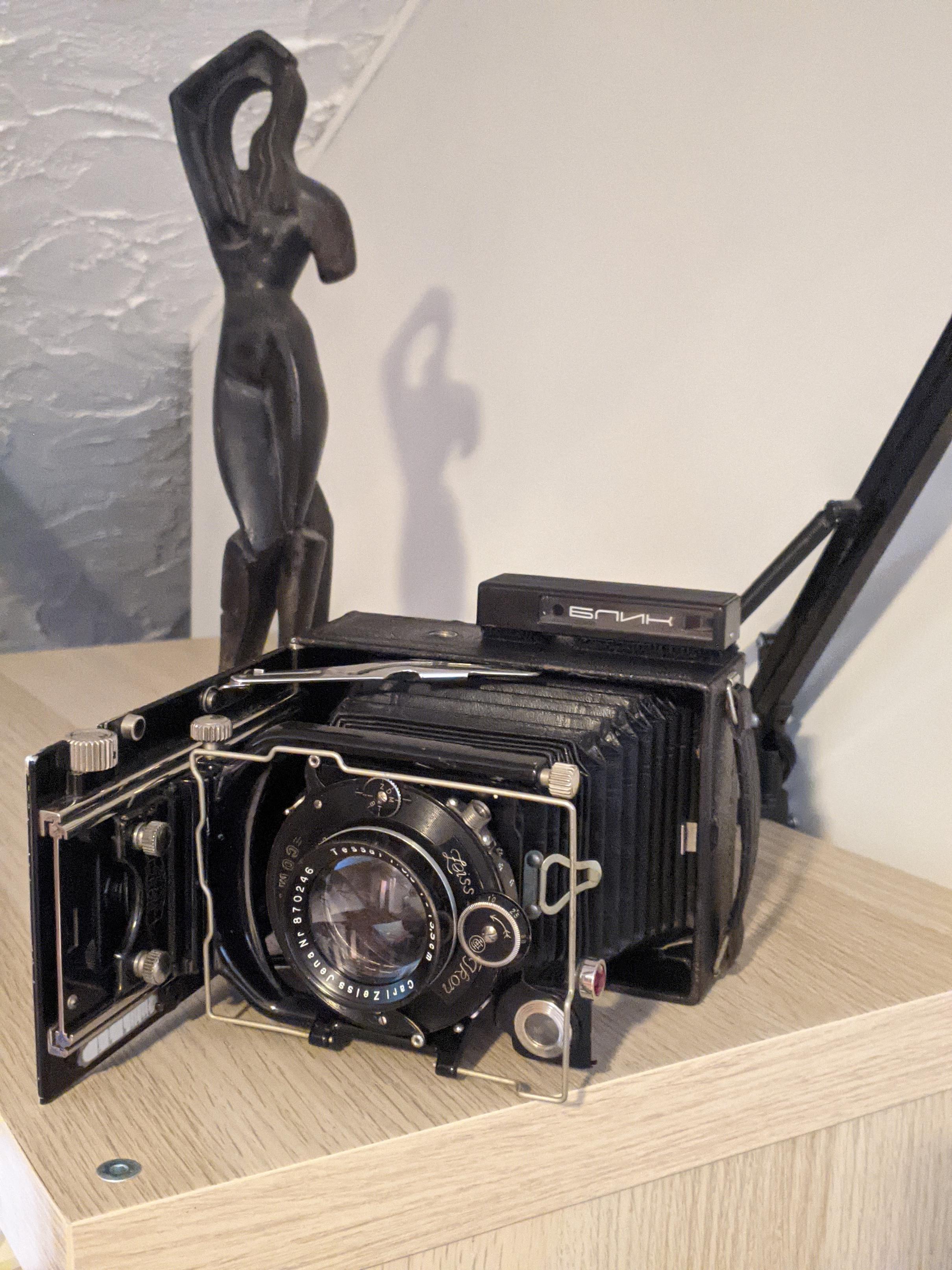

I've been having fun modding an old plate camera, recently attached a blik rangefinder. Yes it's velcro'd on.. I considered mounting it in a shoe screwed into the tripod mount but this is really a lot cleaner.
It would be so nice if this RF had a 40mm viewfinder built in. I'm using the wireframe viewfinder now but it's on the other side of the camera, a bit awkward to find range then flip the whole thing 180 to compose.
I'm wondering if there's ever been a mountable view/rangefinder combo produced? It seems like that would be so valuable for large format handheld work. I can't find anything but maybe there are some recent projects, as I've noticed a lot of 3d printed cameras with accessory shoes being developed lately.
Any ideas?

Zeiss made a viewfinder/rangefinder for the Contina with interchangeable front elements. Model 425. Unfortunately for your purpose it's a 75mm for 35mm format.
Ah that looks perfect, what a cool little device. 75mm.. out of all the focal lengths, that's just tragic.
Maybe you can modify the Blik RF? You can make a simple VF with two lenses.
Interesting read. I guess I would need to dremel out the front window and then replace the front and back glass with the correct focal length lenses and make sure they are the correct distance apart, all without interfering with the chunky beamsplitter that sits in between (which might have its own optical effects?).
I think this might be a little beyond my fabrication skills, especially since the Blik is not a very high quality component itself.
That’s a very useful link, thanks. I don’t want to derail this thread, but I’ve been pondering how to contrive a reversed telescope that would allow me to see the 35mm framelines of my Leica while wearing spectacles.

Another option would be to attach a VF right above the viewing window of the RF?
That's not going to work great with my velco attachment. Viewfinders really need to be locked in place whereas a little wiggle doesn't matter on a RF..

I suppose there's a reason you have mounted the rangefinder on the underside (with the tripod mount); perhaps there's a flip-up okular for the frame-finder on the upper side, that makes it impractical to mount the Blik on the upside of the camera?
Nice camera, by the way, and lens. If this is the 9x12 camera, then the lens must be the Tessar 3,5/13,5 cm, that was considered de-luxe, and never very common. I
Your specimen almost seems to be coated, but perhaps that's just on account of colored reflections on the glasses?
