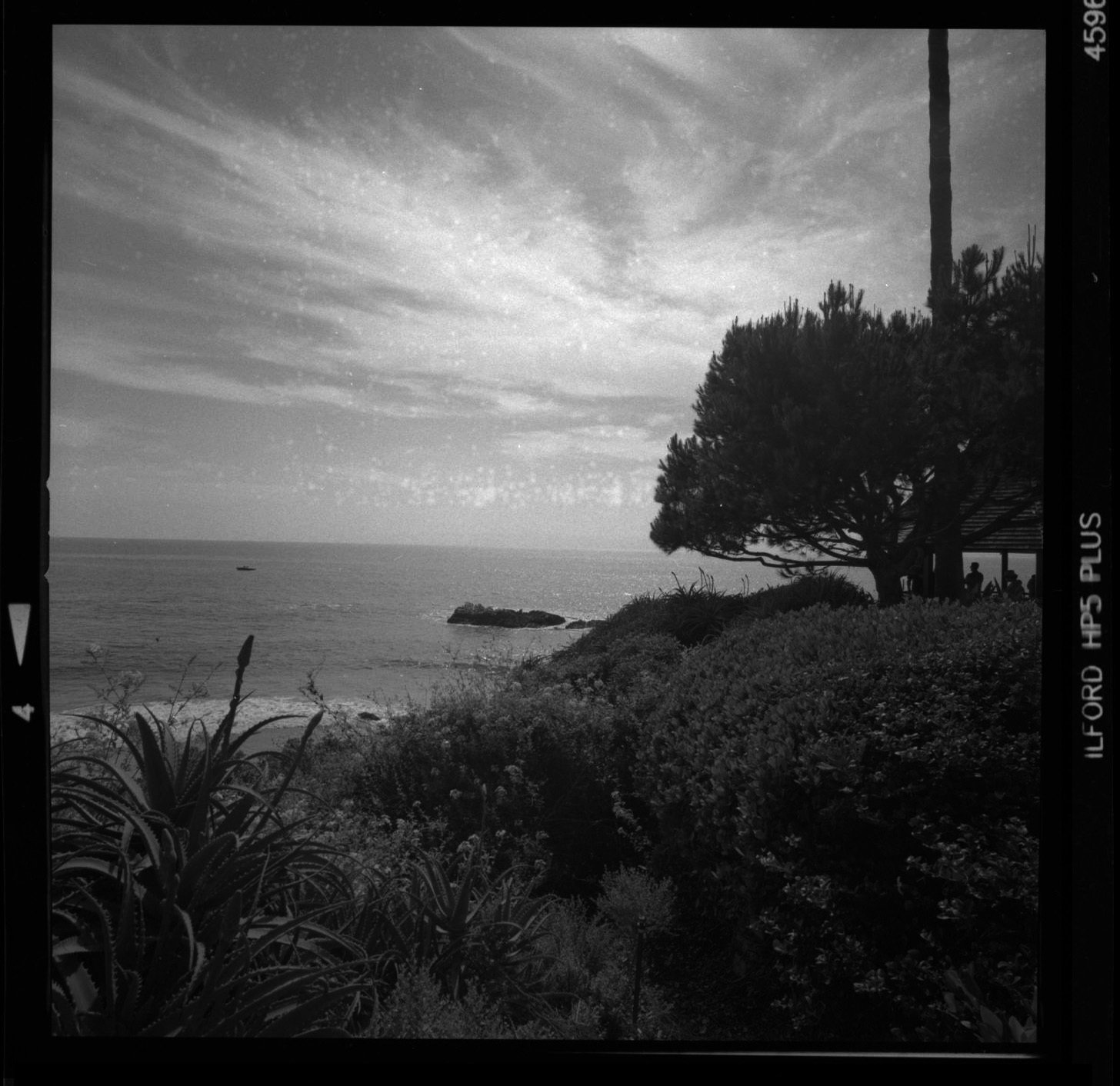

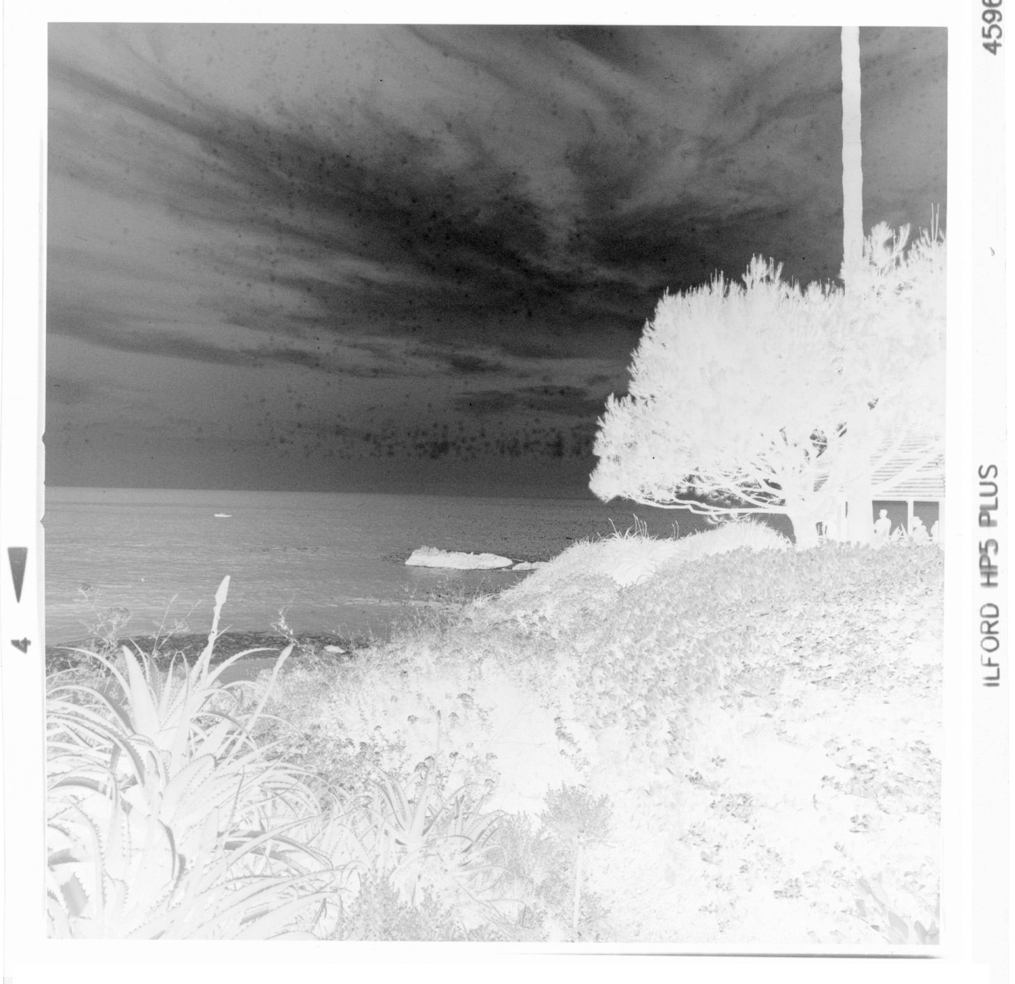

I had some rolls of HP5 120 film (expired Feb 23) that I shot this year, they came back from development at a reputable lab (AG) and all the shadows were full of small blotches (picture is after scanning and reversal). The film had been stored in a drawer for a few years. I assume this is the backing paper-related problem.
I store all my black and white film in an insulated bag. The few times I have noticed mottling with Ilford HP5 was film that stayed in the camera for an extended period of time. And the mottling showed up more in the mid-tones and highlights than the shadows.
Unfortunately, my film was refrigerated at all times other than its delivery time and the day I exposed it (several hours). Nice photograph.
