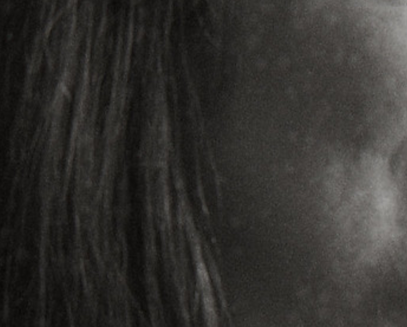

I had some rolls of HP5 120 film (expired Feb 23) that I shot this year, they came back from development at a reputable lab (AG) and all the shadows were full of small blotches (picture is after scanning and reversal). The film had been stored in a drawer for a few years. I assume this is the backing paper-related problem.
