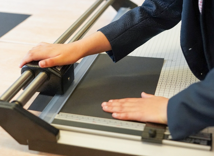

Take it to a professional for best results or buy a roto trim.

This thread provoke me into going ahead, tonight, and buying a 12" Pro RotoTrim cutter. (two guide arms) even though i have traditional guillotine cutters, so precision cuts of negatives, both paper and film are pain free and the cut material slides easily into dark slide holders.
Cutting medium to size is so routine, life's too short to mess around with dull or misaligned blades, IMO.

Absolutely, British made! I would get a 15 inch just to give yourself more room.
