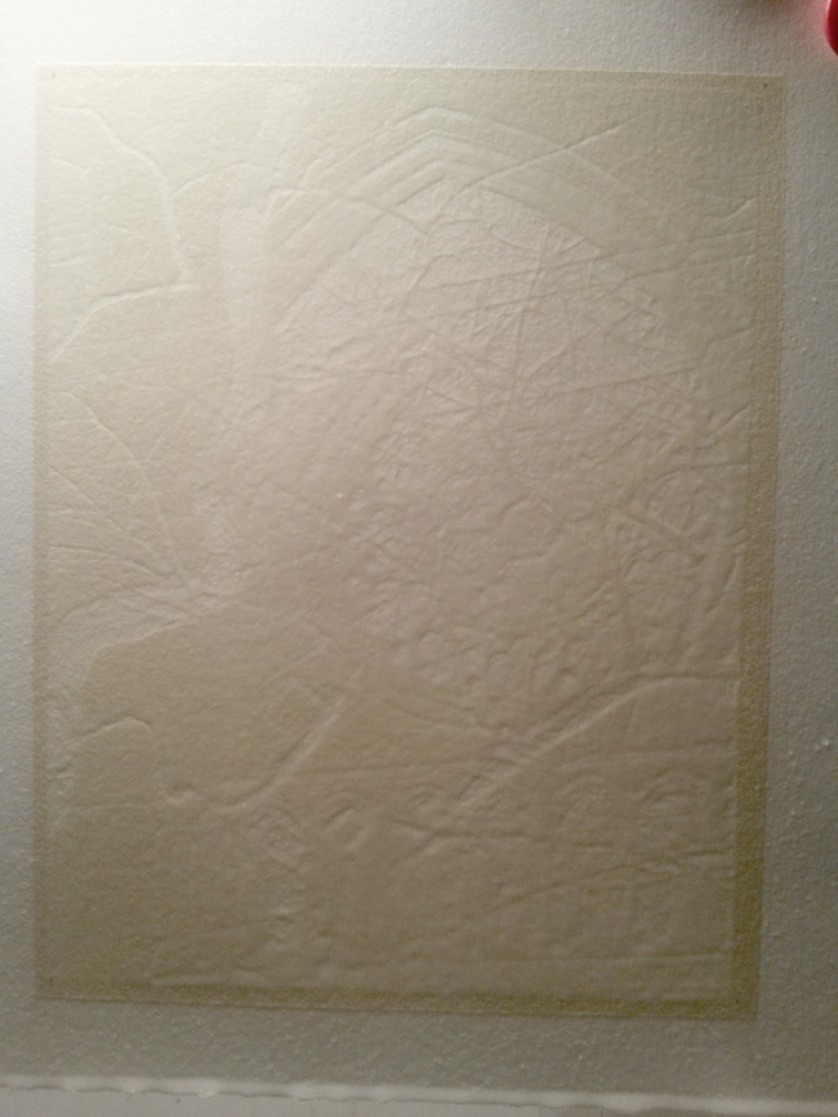

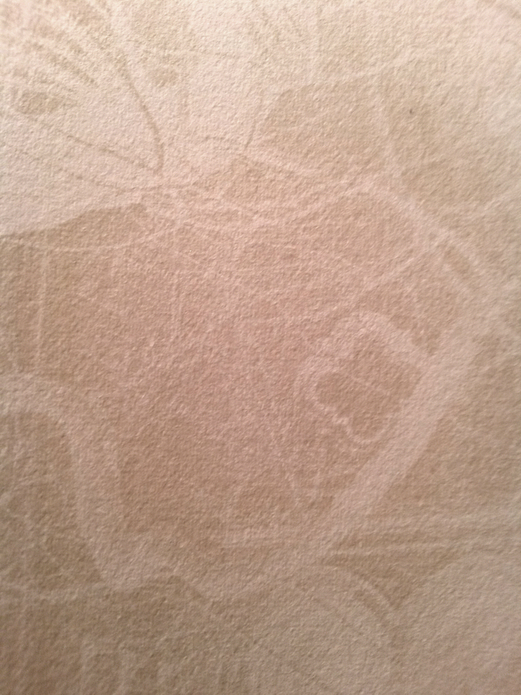

Here's a pic of the wet matrix, dried, and a close up... I inked up the dried matrix and let it sit over night. Sat the print in room temperature water and wiped of ink with damp sponge. There was no advantage to letting ink sit longer. I'll post a snap of it when it has dried. I'm going to try a cold press paper next.

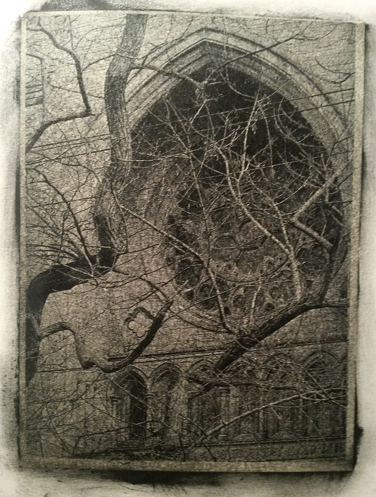

I chucked out that last print. Pretty ugly. I decided to make a couple of changes. First, I increased the PD from 16% to 20%. Second, I coated the 20% PD sensitized gum arabic onto Stonehenge. I ended up with the best print ever. Quite pleased. Here it is...

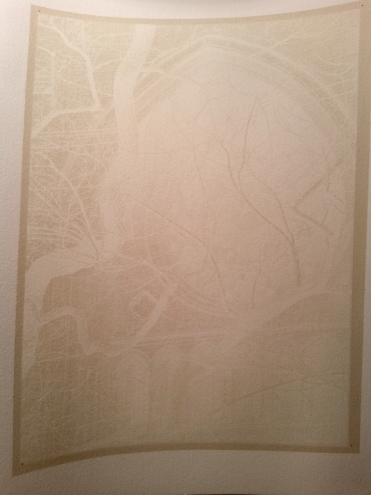

Yes, good catch. I used ammonium dichromate! Was just so used to used PD for gumoils. Sorry about that. In regards to paper, I mentioned what I was using in previous page, I believe. It was Fabriano Artistico. Yes, still using 1:3 dilution. Using a foam roller to apply it. Much better than a brush. I did a test strip to determine exposure. I soaked the print in 24C water for 20 minutes. It's done when the hardened areas are in relief. If you don't see relief, leave it in the water longer. I frequently change the water as dichromate leaches out. Then I Dry the print, ink it, wipe off, (no wait time) stick in water straight from the tap (it's cold!) for a minute, take out and gently wipe with damp sponge.

I think it is a lovely print! For the mesh try a small gaussian blur or add noise in PS...
