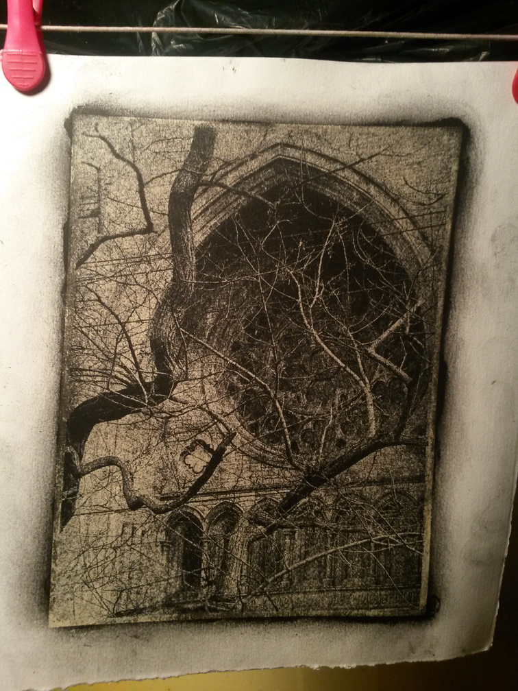

Back at gumoil printing and getting much better results. Changes that I made to my works flow: more contrasty negative; applying sensitized gum with foam roller. Smooth, wonderful coating; longer exposure; matrix soaked in 24C water rather than 20C. I'll post a print once it has dried. It's not great but huge improvement.

I'm using Fabriano Aristico, so sizing not necessary. I would like to try Rising Stonehenge, as I have a whack of it. Not bleaching prints. Just stick in a tray of cool water and wipe gently with wetted sponge. One application of oil paint. It's no where near what I want yet, but this is a huge improvement, and I'm getting better consistency.

Andrew, I like the image & it looks like you are getting quite a bit of tonal range.
Would this be down to the warmer 1st wash at 24deg.?
I guess the red patch is just in the photographic reproduction here as you only used 1 colour?
Thanks again for showing

Ced, only used one colour. Lamp black. Big improvements with warmer development bath, contrastier negative, longer exposure. Still very contrasty result. I think that is inherit in the process.
Glpoza, as soon as oil paint wiped off I stick print in water just for a few seconds, then wipe with sponge. The I'll post a pick next week as I'm away photographing.
